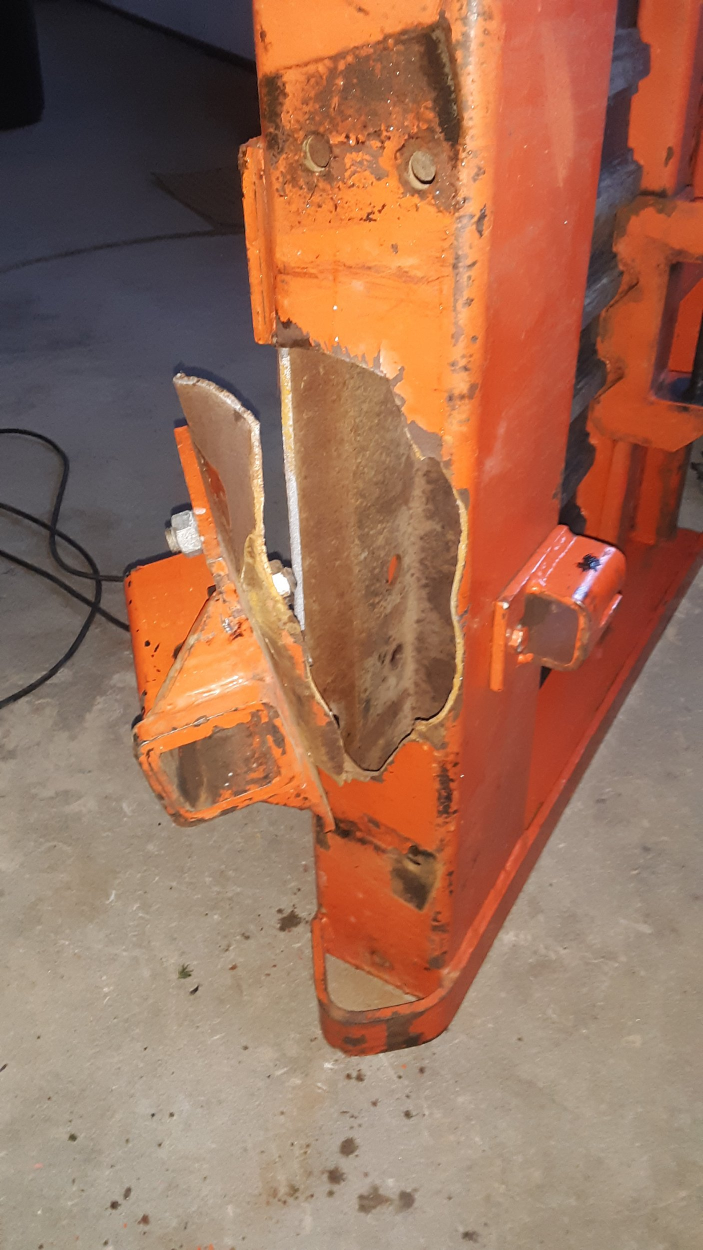

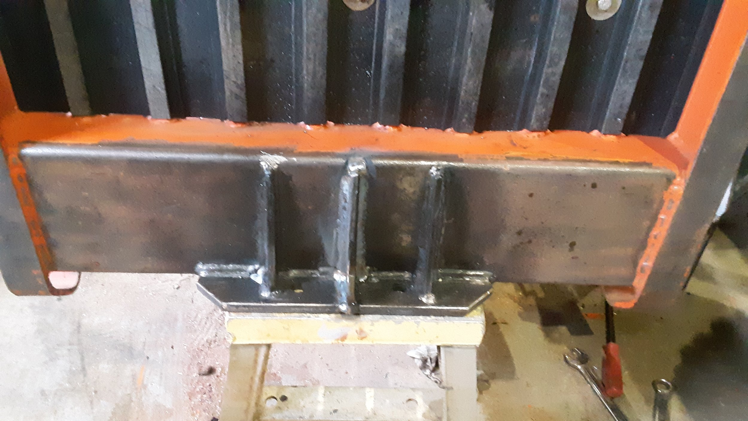

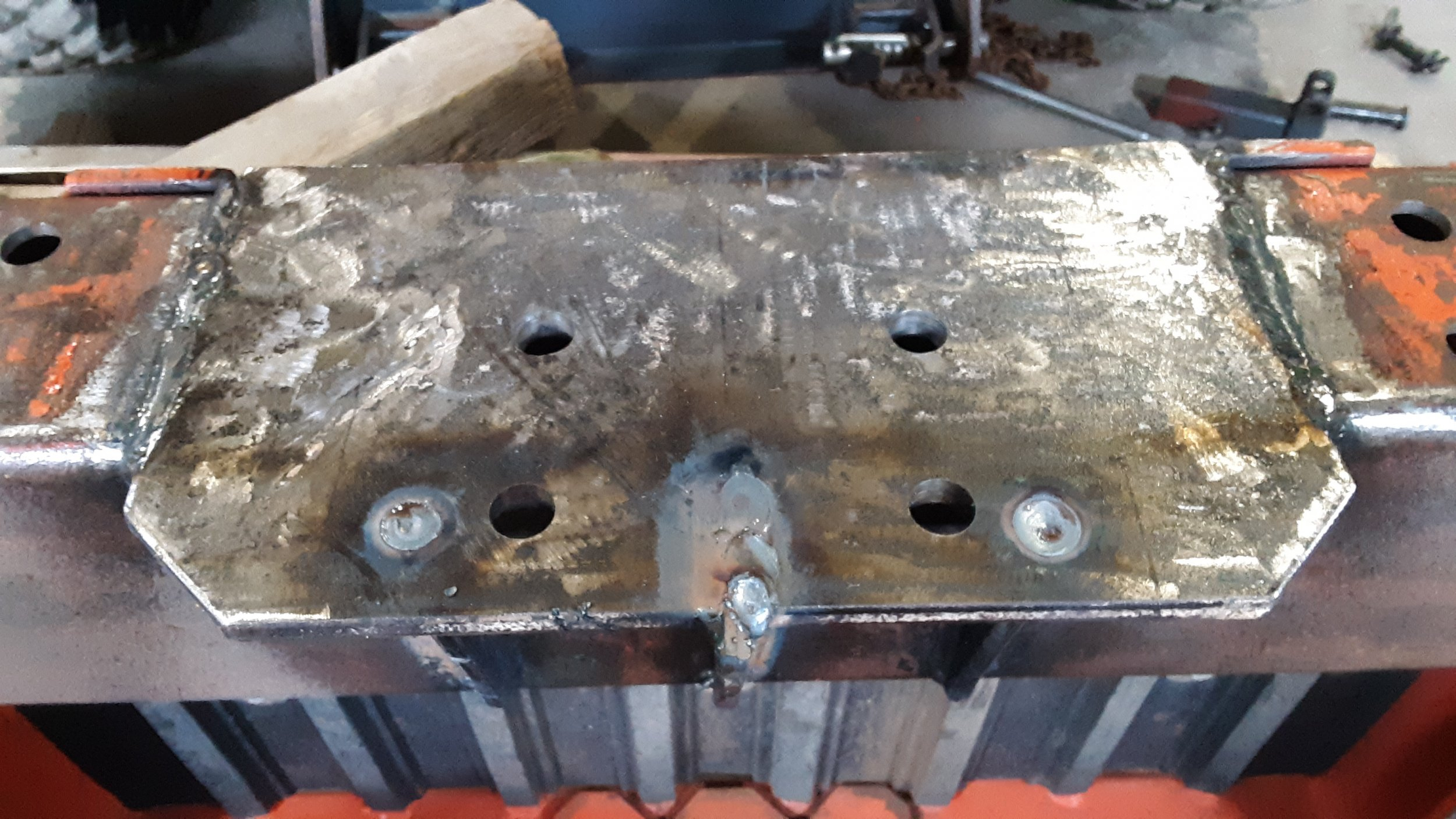

My grill guard. Built around 8 years ago.
It's also the basis of my frame mounted snowplow, it serves as the structure for the lift cylinder and arm. It failed on me last month after all these years.
Metal fatigue in the bottom of the "bumper" portion. The reciever was added for the plow mounting project. That tube is 5x7x1/4" wall but takes a pounding when supporting the plow during transport over the frost have riddled roads around here.
Put 1/2" back in it, and I like gussets for the additional 36" of weld just for overkill.
Then the original reciever got bolted back on.

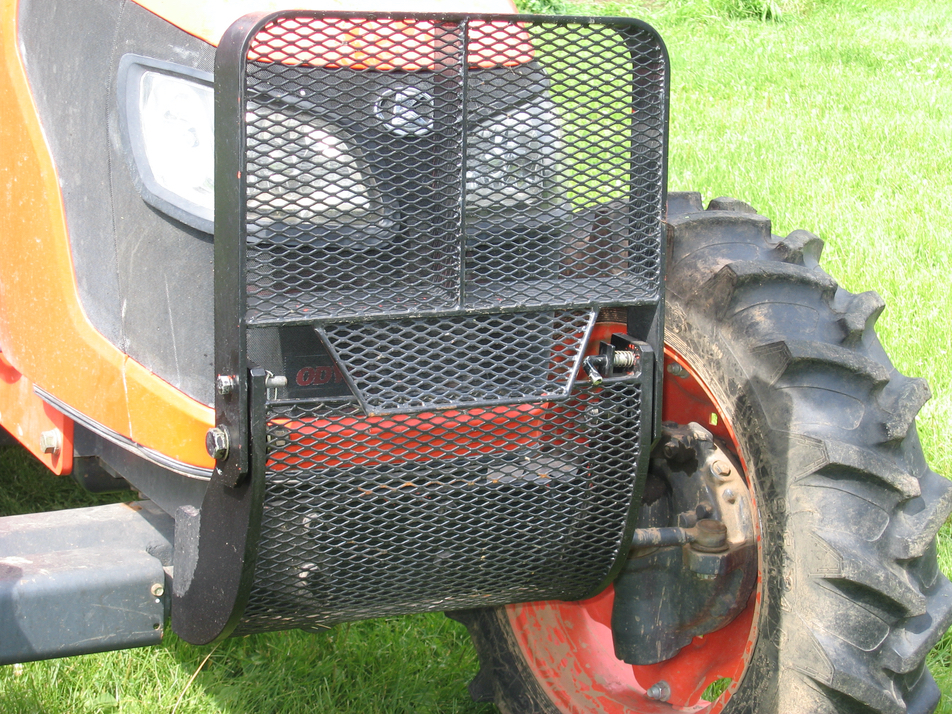

Well - everybody has their own idea. 2515R Dude - that is a thing of beauty AND a whole lot to tedious welding. I took my OEM brush guard to the local welding shop. The young fellow used expanded metal. Came up with good coverage and still easy to fold the guard down - to open the hood.
I like the orange one that Dennis - post 22 - made. Good coverage - robust design. This is mine on my M6040.
