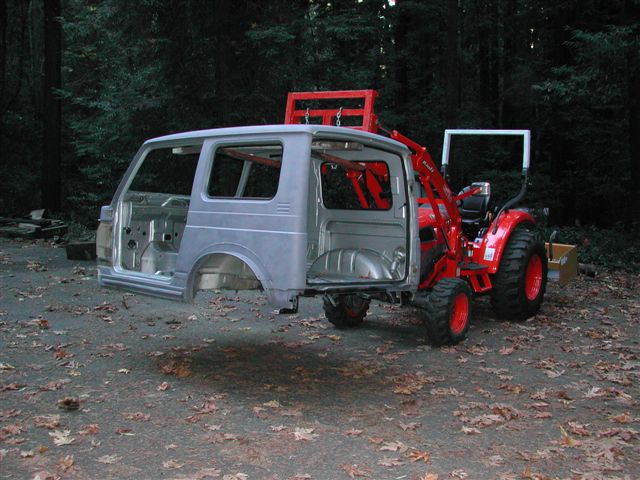

Very nice - a great idea! Love the forks too!
   / one cubic yard loader bucket
#22
These forks have worked great for me. Light in weight, but
very strong and versatile. Thx

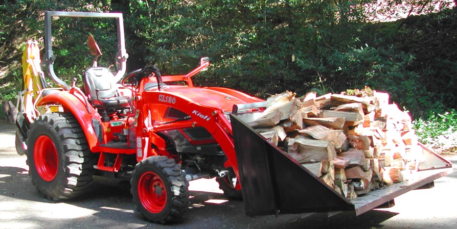

Bucket in action:
Loaded up with several hundred lbs of split maple, oak, and laurel.
Works great. Oh yeah, painted with 75 Datsun maroon.
   / one cubic yard loader bucket #28
DFKrug -
I checked out your home made loader bucket. You did a very fine job on it's construction using strong, yet light weight building materials and techniques. I really like the way you've got all that nice split wood stacked in there. It sure comes in handy to be able to move large bulky loads around like that.
I am willing to bet that you are you pleased with it's performance.
Great Job,
Larry

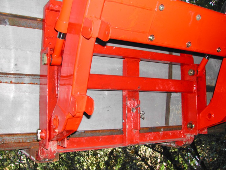

dfkrug said:
You still want to be able to easily dump your load using your bkt curl
function.
Seems like all that is needed for this is add a chain or pin which locks it to the forks. You can hold a good amount or brush/leaves in there.
#30
Since you mention it, Mike......
This photo shows my securing chain, which slips into my chain lift
hook (slot).
I weighed my bkt with a hydraulic scale I recently made and it measures
205 lb, which puts it at about 25 lb more than the stock bkt. That plus
the fork frame put the total around 400-450 lb.
Thanks for the kudos, guys.
