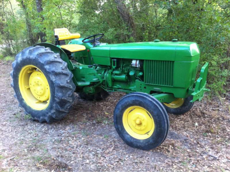

Man I'm loving this tractor! It's nice to have a machine that is a little more substantial than the little kubota! I finally got the time to do the fluid and filter changes yesterday. The hydraulic oil was a little dark but I was glad to see no water at all in there. The screen did have some crud on it and the filter wasn't too bad. I went back with Hyguard and it seemed to quiet and smooth the hydraulics some. Seems like it is worth the extra money. I also replaced the fuel filter. It was probably past due, kinda dirty. I really like the glass filter though, it makes it easy to check on it. After a small adventure of not bleeding the lines right I finally figured it out and opened the top bleed screw on the injection pump and primed it back up then she fired off. Besides playing around with my 4' implements I really haven't been able to really work her yet! The wife's probably not quite ready to hear we need a new bush hog! Lol
