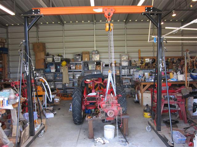

Righto. I use a $500 gantry with 1 ton chain hoist from Harbor Freight to remove engines.
So far I've used it to pull the engine on my 1951 Minneapolis Moline BF and 1947 Farmall Cub. My 1945 Oliver 60 Row Crop is running fine so no need to pull that engine.
