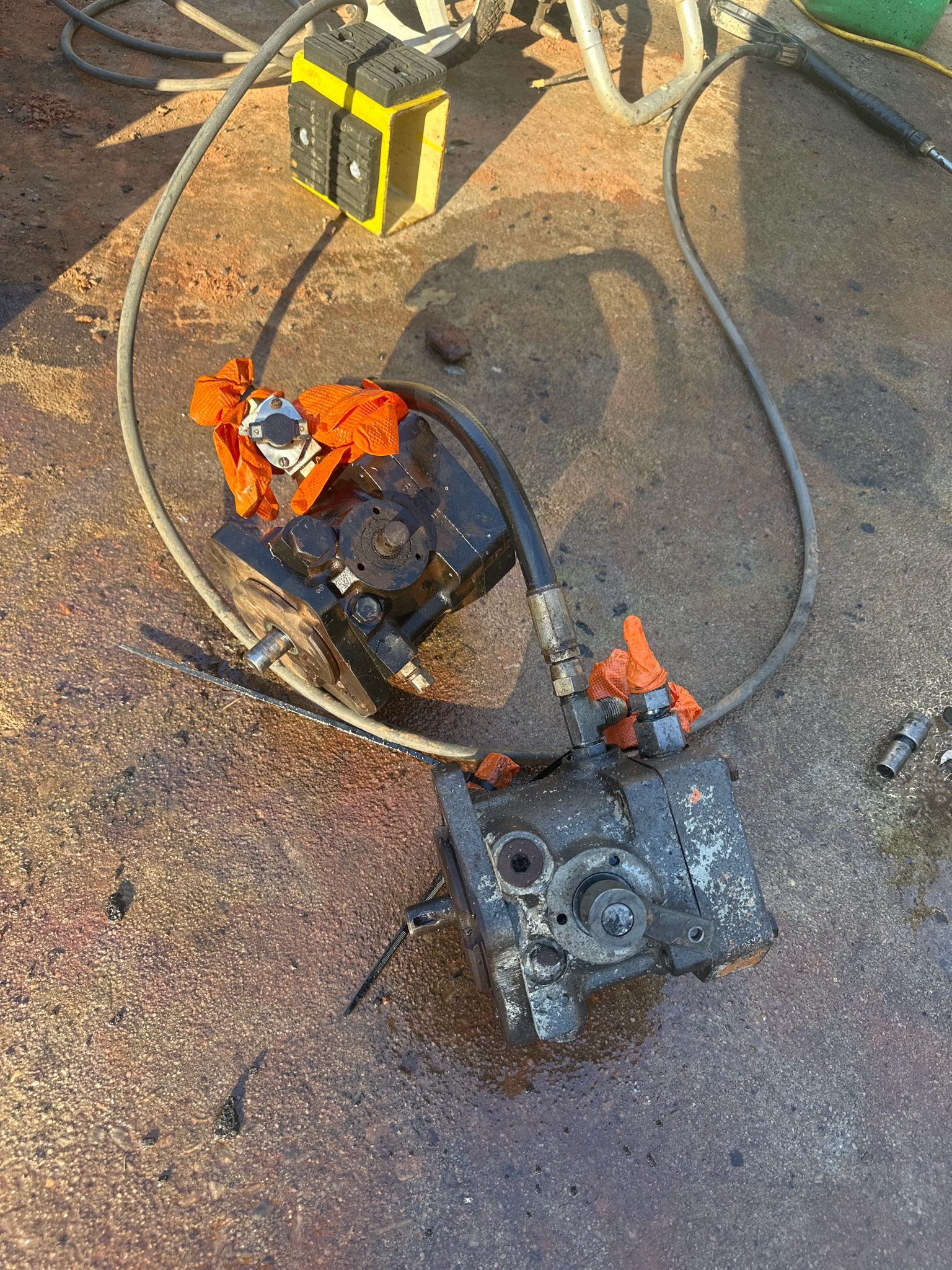

Older scag sthm tram pump will fit in older 2425-2422 powertrac ask me how i know
   / Older scag sthm tram pump will fit in older 2425-2422 powertrac ask me how i know #1

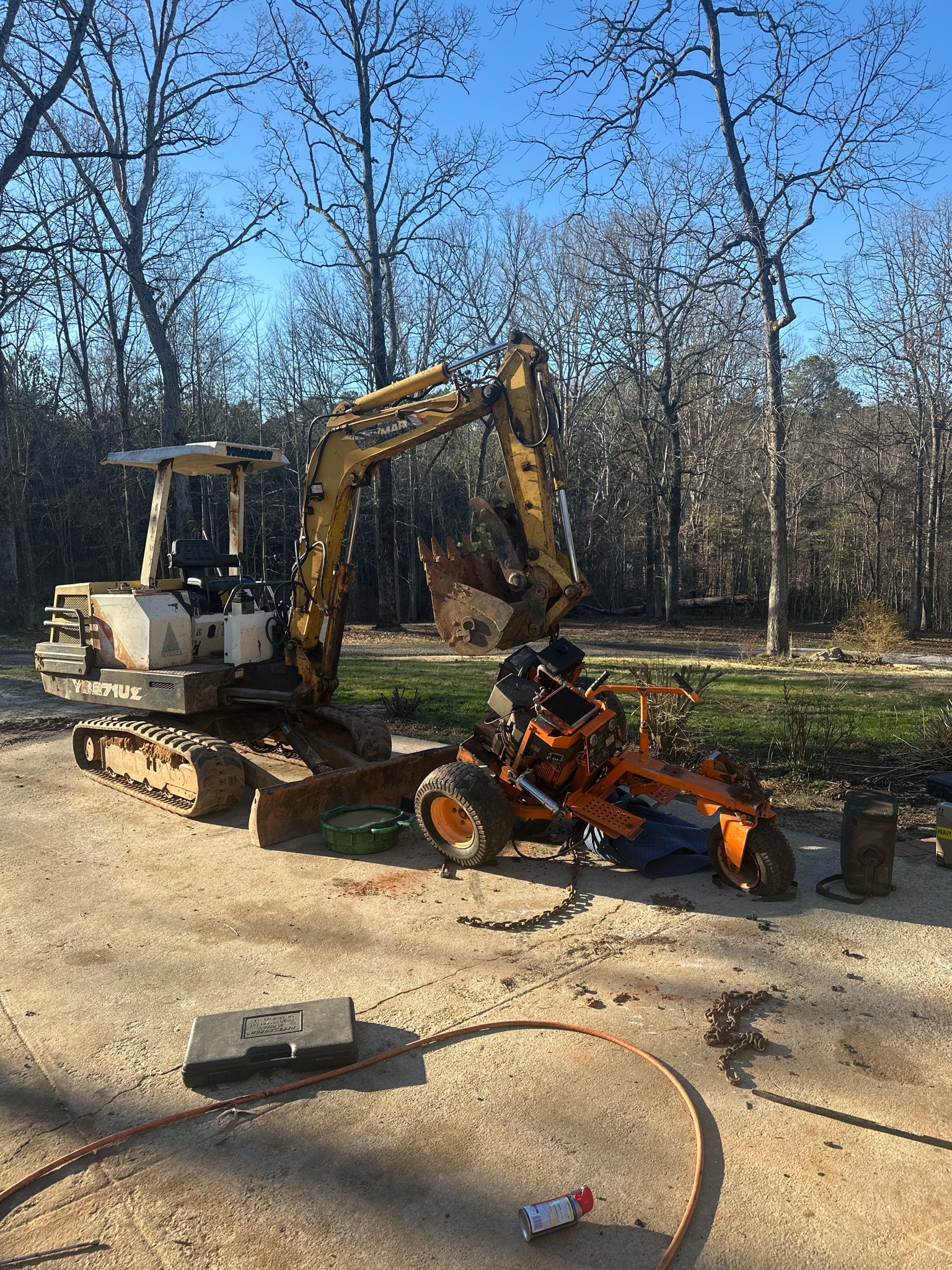

Older scag sthm tram pump will fit in older twenty four twenty five and the twenty four twenty two powertrac.Ask me how i know…

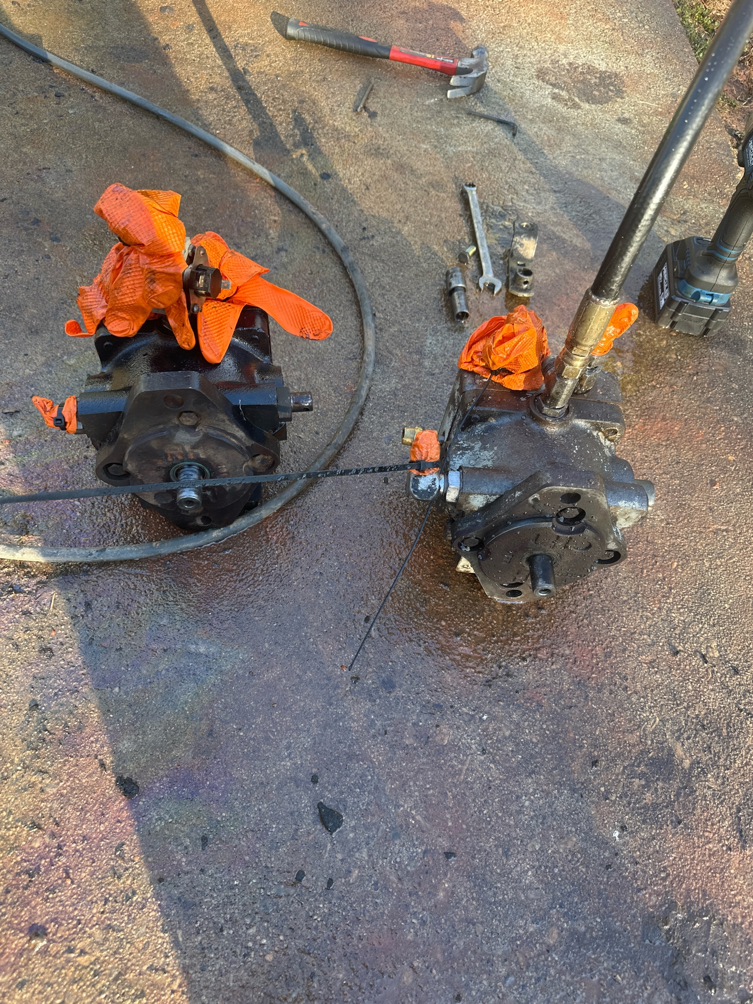

#2

It is the same pump but the scag turns opposite. Dont know if this will work or not. Has different plugs on both sides gonna have to do some research.
Good luck. If you can get the scab pump model, the configuration for the model should call out if it is unidirectional. AFAIK, some pumps are, some aren't.
All the best,
Peter
   / Older scag sthm tram pump will fit in older 2425-2422 powertrac ask me how i know #5
Is the charge pump built in or remote on that pump? If built in you would have to convert the charge to correct rotation. If not built in it might work as is.
