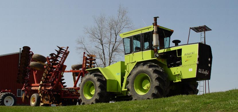

You can get a Ford/NH Genesis 8670-8970 for around $45- 50k. They range in the 140-210 pto hp and have a much better cab then the old artics. So if you are farming and need a reliable machine you don't look for a old artic. The collectors have started buying them though. I know of a nice Oliver farm north of here who buy old Olivers and restore them to use on their vegetable farm. They added a nice old Oliver 4wd not too long ago after they restored it. There are a lot of big farms also who collect old tractors and restore them to do small task on their farms but they are not the main tractors on the farm. There is one farm that buys old Steigers and restores them to use on their farm for the main tractors but they are an exception and they are some very smart people. Here is a pic of their favorite tractor
