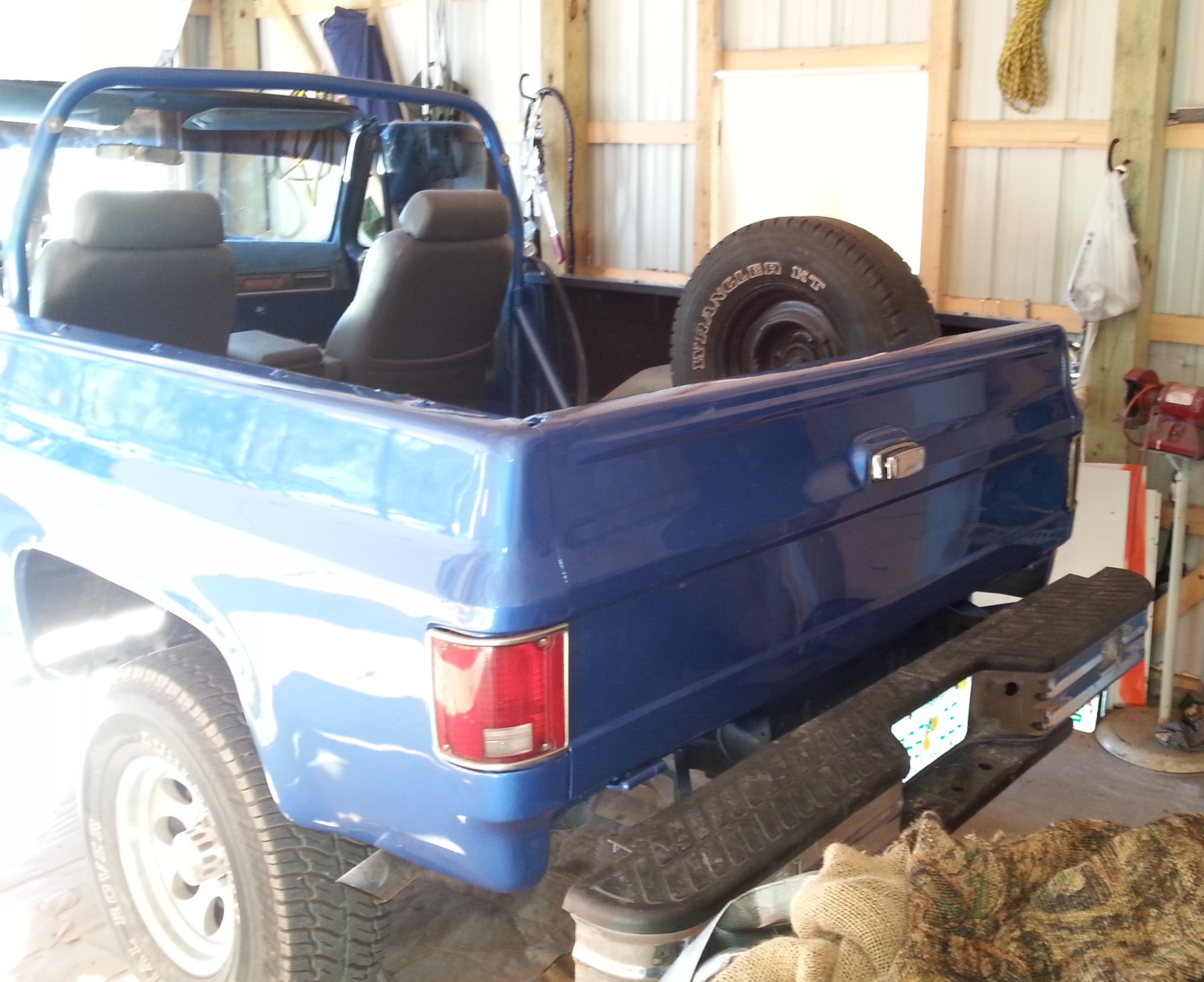

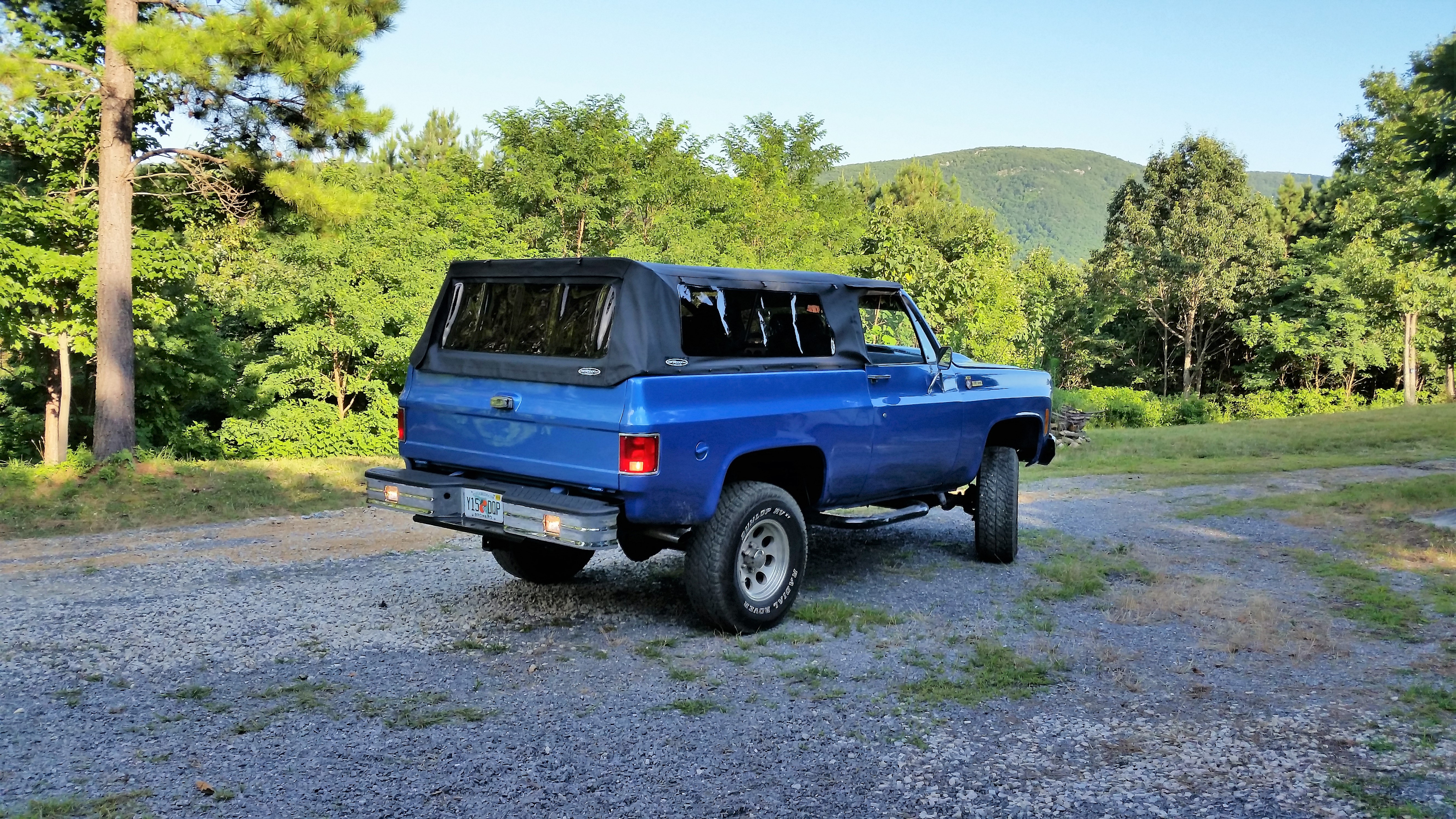

Guys, I'm trying to restore a '75 Blazer....quit laughing...The drive line is all new, the doors, quarter panels, hood tailgate new....and way too many $$$ spent. Anyway, the door glass (both sides) were always stiff, now they're so hard that it takes two hands and I'm afraid I'll break the winder handle. I reused the old winders and channels when I replaced the doors. Would anyone have suggestions about this? Is there a means to lube anything? LMC carries both window gear systems AND channels. It will be a pain but this is almost unusable. Thanks

Your paint looks good in the pictures. I always liked the k5 bumper that was contoured with back of the truck. Looked good on the pickups too. Didn't protect alot.

Guys, I thank you. I don't think those regulators are real expensive so I think I'll order new ones. The tracks have felt but it is half gone and petrified, ought to replace those too. And the adjustment.....don't know?? The rear post/frame of the door is cut off to make this model a "convertible" so there is no rear window track. It wasn't this bad 20 years ago......duh. Thanks, again

.........................The rear post/frame of the door is cut off to make this model a "convertible"...................................
Unless someone put the wrong doors on it, you don't have a '75. Until (and including) 1975 models, the entire top came off from the windshield back and the doors had frameless windows.

You're right, the orig doors were so badly rusted out midway and bottom that I ordered "replacement" doors from LMC. The aftermarket doors that I received were full frame pickup type doors. When I called them they said that the orig doors were "not available" After 42 years guess it's hard to stock parts. The truck IS a '75 as it had the full fiberglass top and roll bar on it, the VIN/equipment label state '75 also. :thumbsup:.

Good job on a nice truck. I think you need some giant tires to make it complete! Just my opinion...
