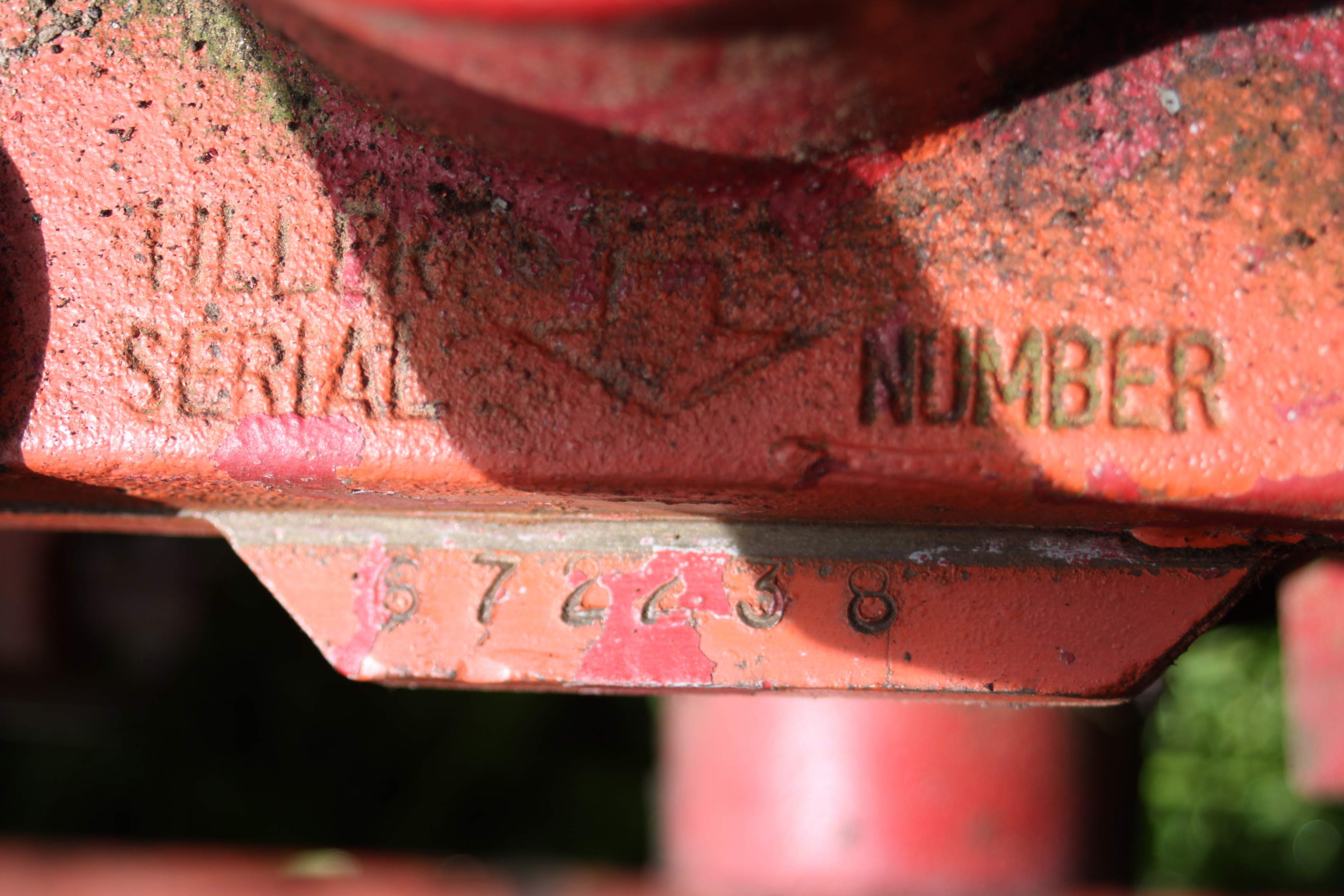

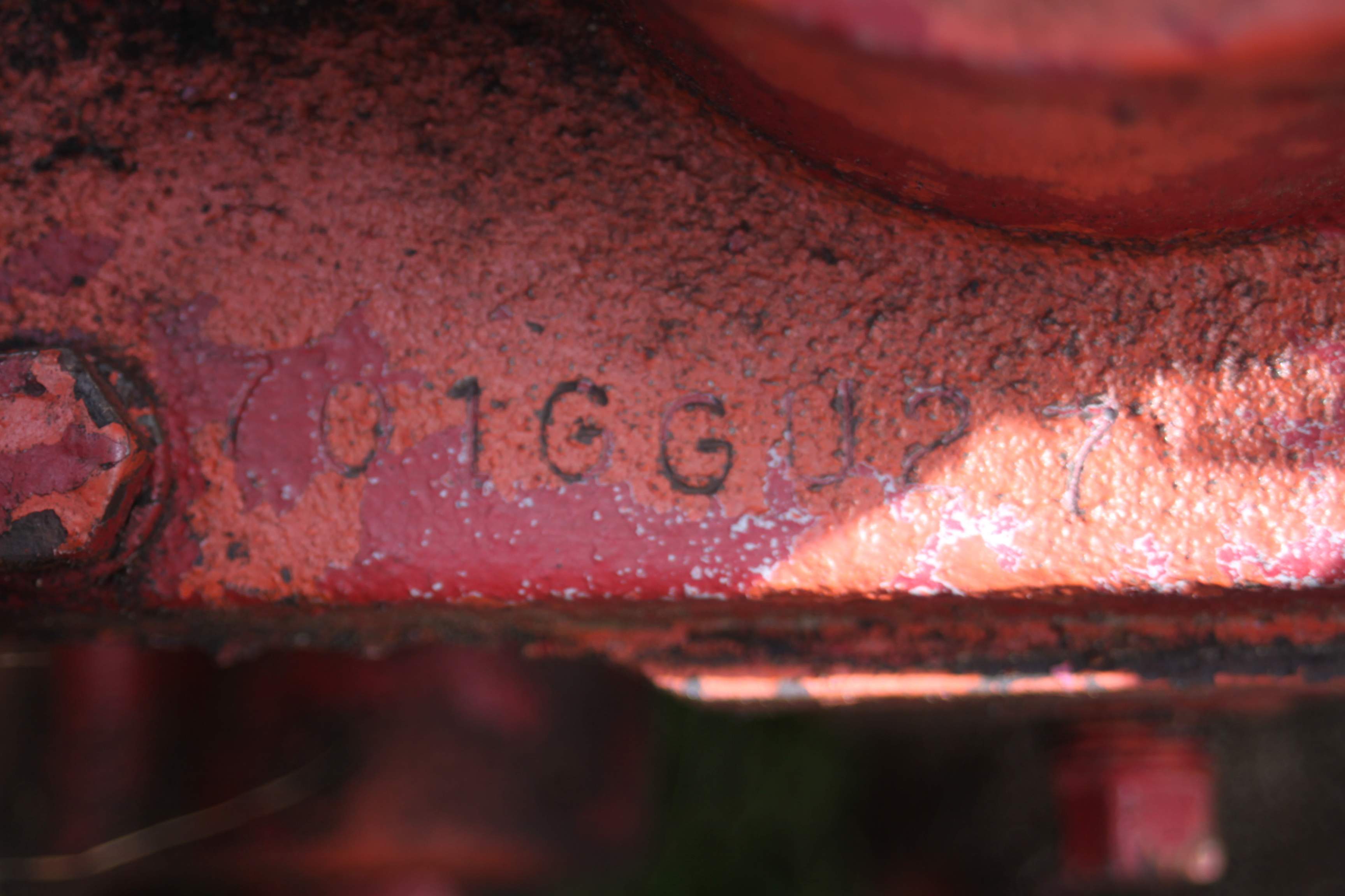

New here and apologize for possibly asking a question others have already answered. I need a reverse disk for my old Troy bilt Horse. I'd also like to get a manual. I know the serial number (400086) and both the Kohler engine's serial number (9656897) and model (K 161 T) which probably makes this a 1979 or 1980 machine. Using the parts links you guys have provided, I seem to have a choice between a couple of different reverse disks but without the Horse model number I can't be sue which part is correct. I also seem to need the model number to get a manual but I don't know where to find it!
I doubt if it matters right now but this is a two-belt model.

On mine the serial number is on the right side of the machine and the model number is directly accross on the left.

Sounds good! I'll go check before dark. I'm pretty sure there's something there on the left side, as you said. It was quite difficult to read when I checked yesterday but with a little cleaning (and maybe the magnifying glass) I think I'm good to go!
