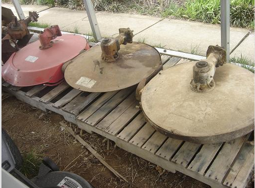

I had a shot at getting a reemaster 5300 at one point and had thought about trying to find a way to run a 72" deck off of it. At that time, it was not a feasable project. If you still have the reels, sell them quick, you can get some nice $$ for them and you will need the money. One thing I thought of after the option to get it, passed, was to take 5 smaller mower decks and run them individually, say 5 38" or 42" decks, depending on the spacing required between. The hydraulics on that machine should be able to power a setup like that. Wish I would have thought of that when I had the shot. Shortly after I was given a reelmaster 216, and used that to mow the lawn. It can be done with a reel, if you keep it sharp and keep it cut. The front anti scalp rollers had to come off too. In the end it got me by for a while, didn't have that golf course look but I live in the middle of nowhere and the deer don't care.

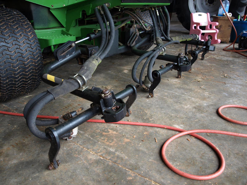

Thanks Guys for all the great Info. This site is awesome. Here is my rough sketch of the cutting decks
http://www.tractorbynet.com/forums/attachment.php?attachmentid=153316&stc=1&d=1264610322
I am planning for 3 30" cutting decks. There are 4 pumps on the Motor. The two that are now being used for the Reels appear to put out 7 GPM each for a total of 14 GPM @ 3000 psi. The larger pump is used for the wheel motors (26.3 GPM)
There is also a pump for the lift (4 gpm) - I am hoping that the 14 gpm will going to 3 motors will give me the torque and speed I need for 30" blades. If not maybe there is excess available capacity in the Wheel motor pump - Not sure how that works...
and the lift pump is not used during cutting so there maybe is an extra 4 gpm.
The question I am dealing with now is the Needed blade tip speed for a good cut - I read somewhere it is around 16,000 fpm - Is this about right.
Also - I am going with 3 indivual, unconnected round cutting decks. The mounts on the machine are already set up and pivot in all directions. - Also - All hydraulics are controlled by selenoid valves and there is a circuit board that, when you push the joystick forward, it drops the deck and starts the blades in one action - Reverse the other way.

You might want to see if you can score several old 30" Gravely commercial decks. Darn heavy duty.
