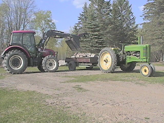

Soundguy, same here semi-retired the old JD A to trailer pulling duty. Only negative is the hyd PSI is only 1000 with 5 qt capacity, limits the weight on trips to the rock pile.
