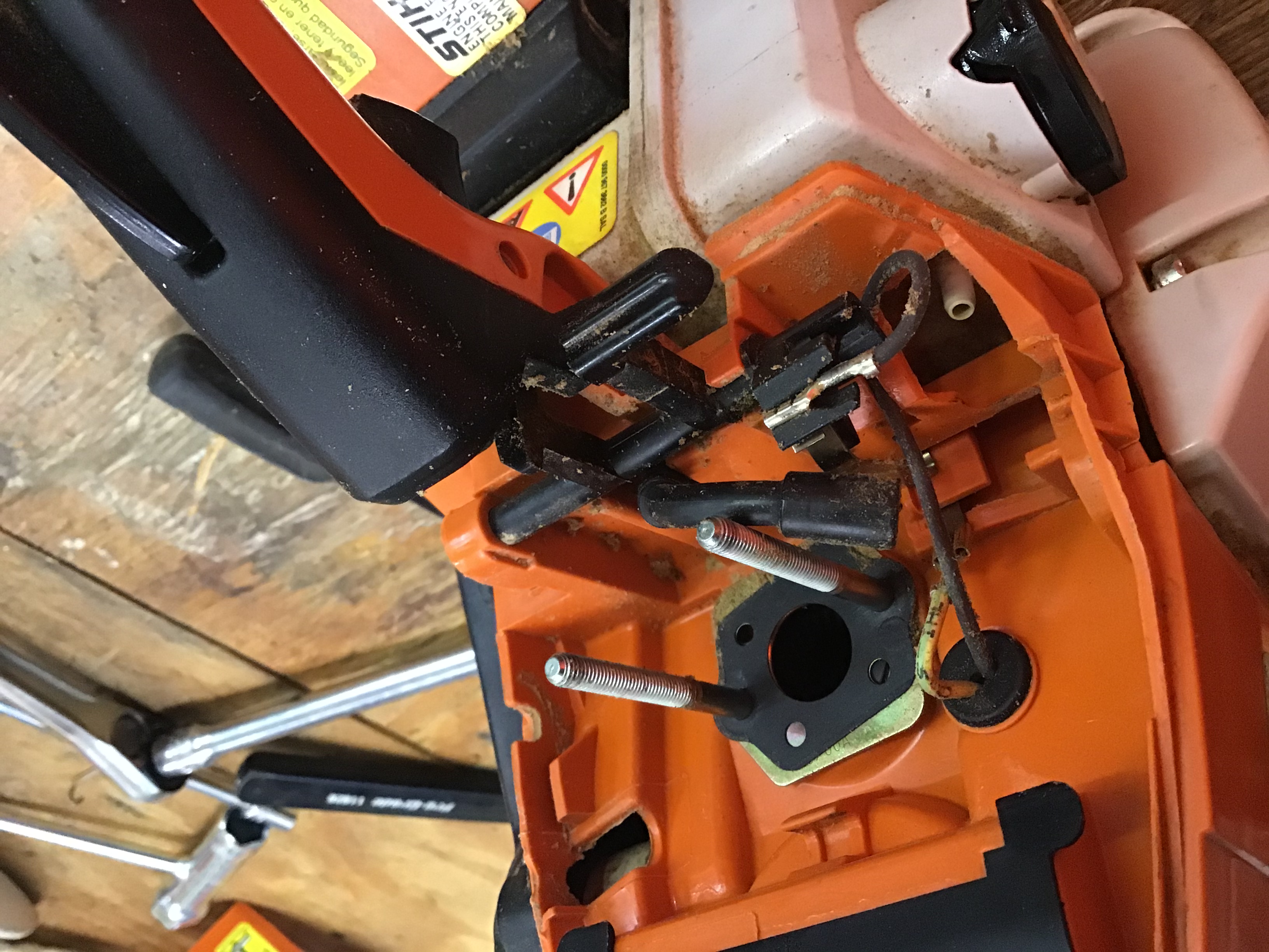

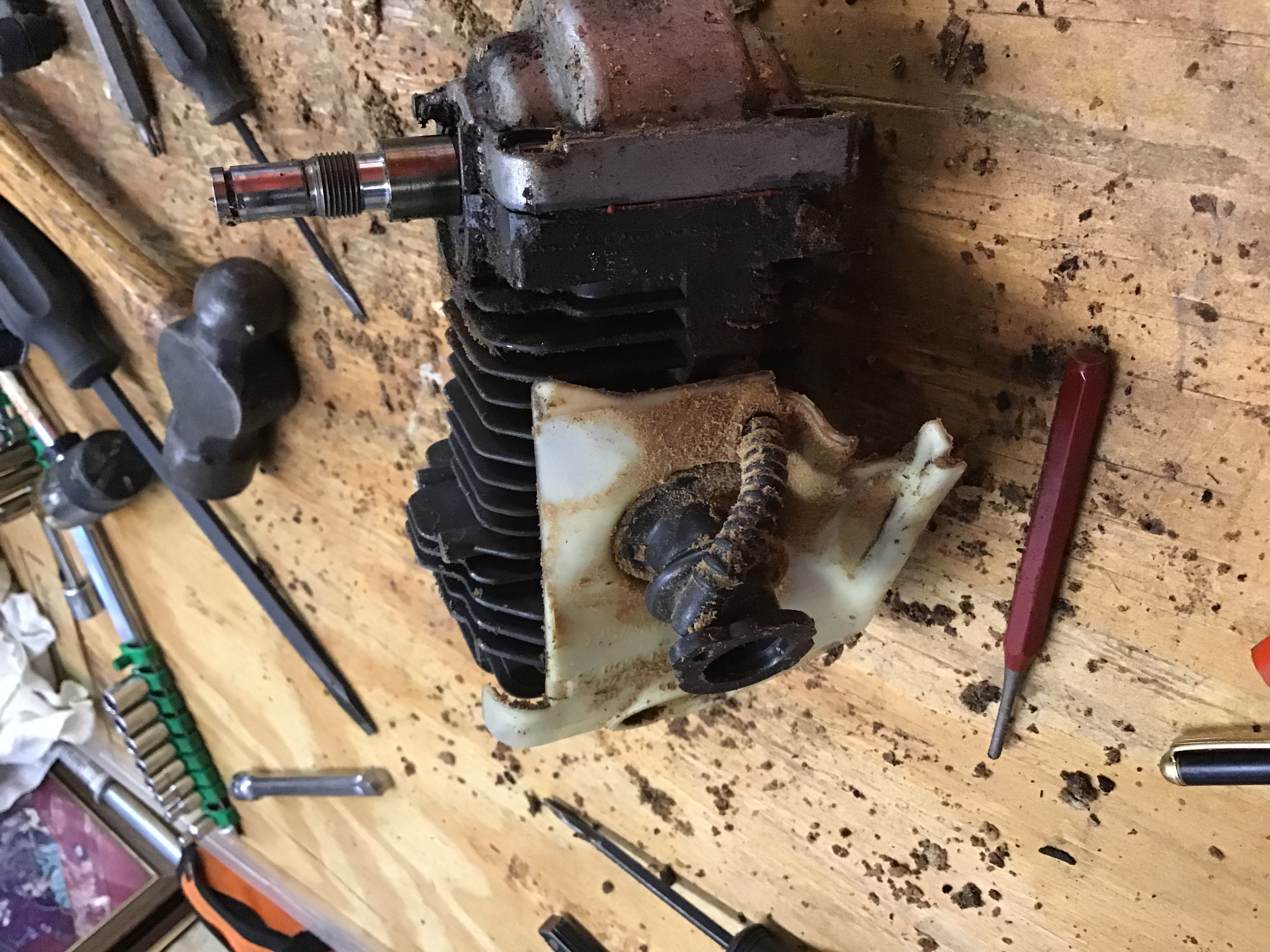

   / Old Stihl 025. Cranks but won't run. #24
A picture of the boot in the first pic. You can also see the corrugated line that could be a source of a leak hooked to the boot. The second pic shows the metal plate and long screws, the boot is hidden behind the saw body.
