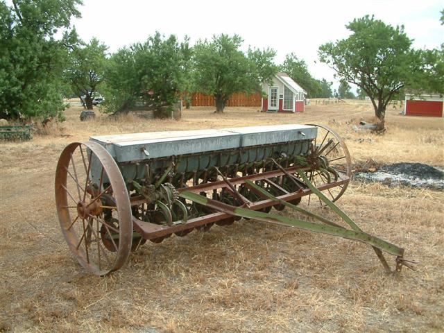

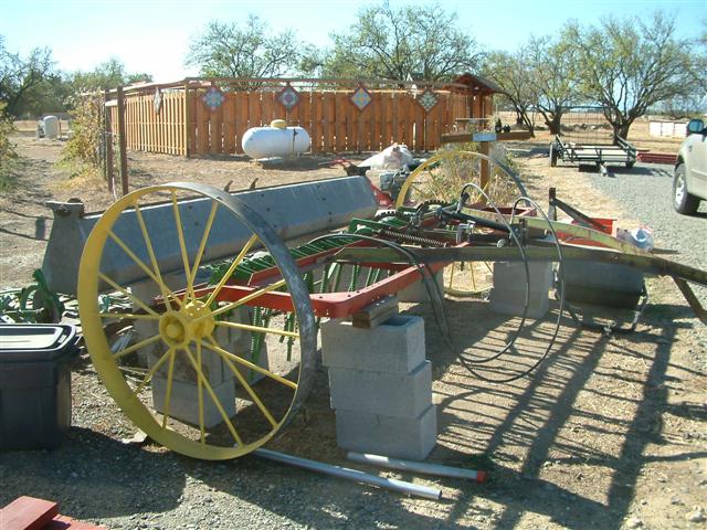

If it's been sitting out in the weather, it's anywhere from completely shot to needing a complete restoration. That's what I had to do to get an old Minneapolis Moline P3-6 drill going (10-ft wide, 20 hoes, single disc openers, dual grass boxes). I paid $275 for two of these discs and use parts from each to make one good drill.
DSCF0156 (Small).JPGDSCF0157 (Small).JPGDSCF0158 (Small).JPGDSCF0159 (SMALL)_crop.jpg
Here's what they looked like when I got them.
This one has a pair of trip clutches to raise the openers when making turns. You pull on two ropes while sitting in the tractor seat to operate these clutches.

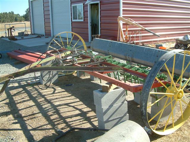

This drill is probably more like the one you're looking at. There are two long levers to adjust the height of the openers. Looks to me like you have to get off the tractor at the end of a row and raise the openers, turn the drill around, and then get off the tractor to lower the openers--unless you just want to turn with the openers in the ground. That is risky since you might knock them out of alignment.

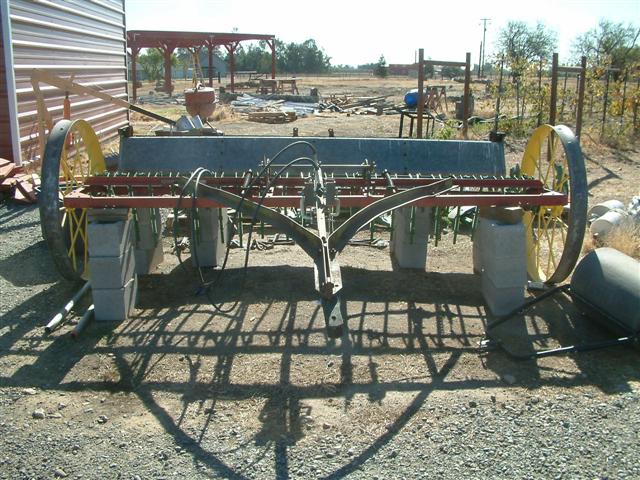

I used this drill as my working unit, removed the two long levers, and rigged a hydraulic cylinder to raise and lower the openers.

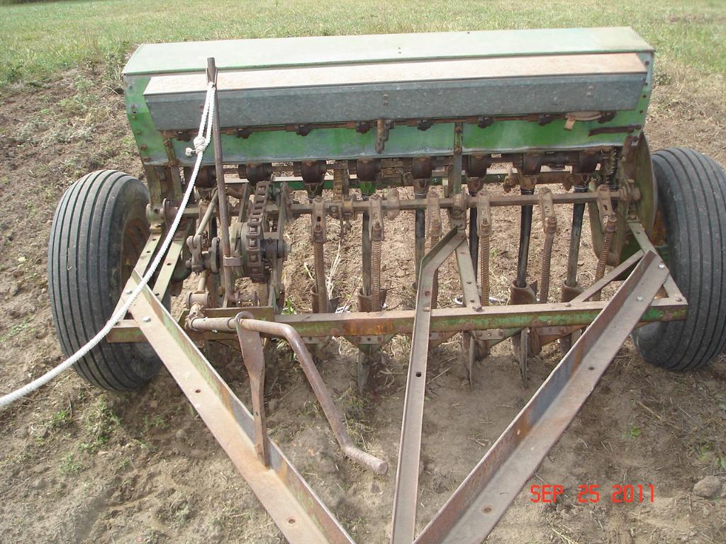

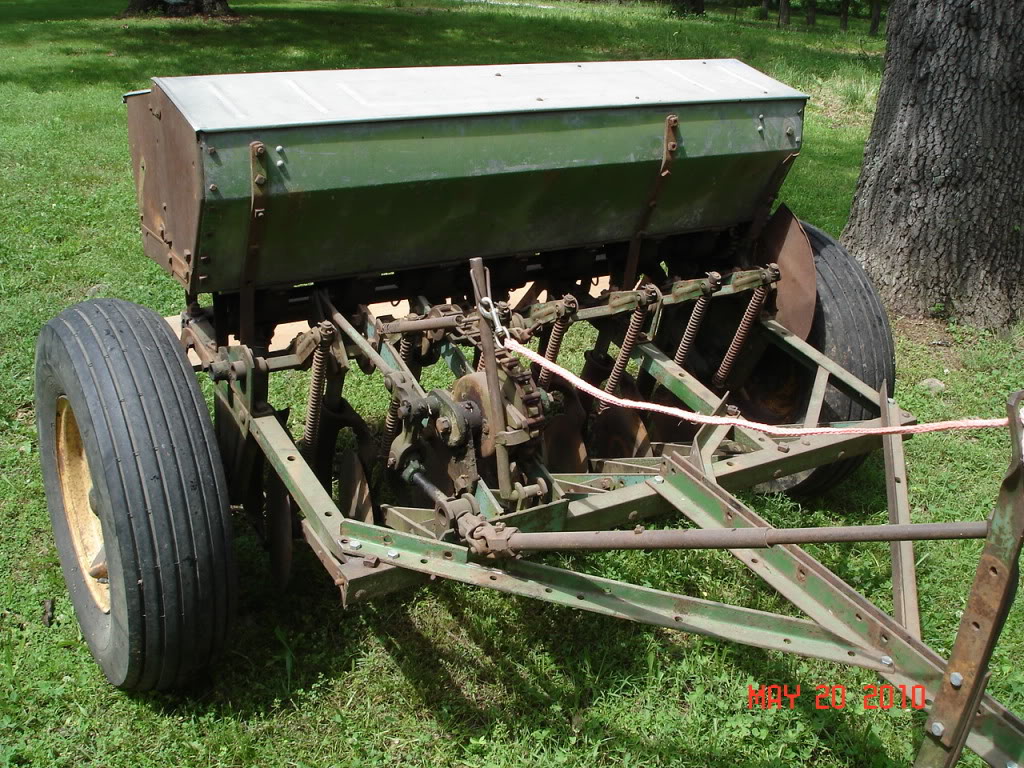

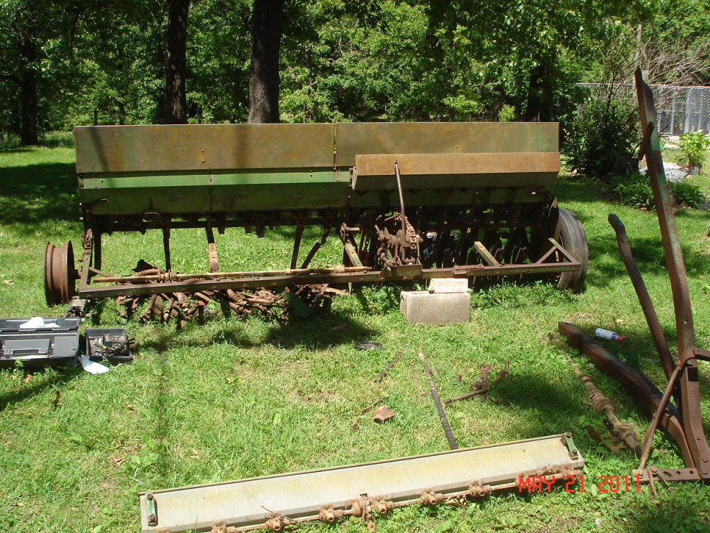

Sounds like an old FB, FB-A, or similar John Deere Drill. The condition it's in is like a lot of them I see. Neglected in fence rows with remnants of the last seed it drilled left in the hoppers. If I could get it cheap enough, it'd be a winter project. Here's a couple I've worked over. First picture is a "before" shot of the next picture. Both of them are John Deere/Van Brunt model FB drills, dated to about 1950 or so. The back boxes are for fertilizer, took a lot of PB Blaster daily to free them up. I was able to do it without disassembly. There was quite a bit of hardened grease and dirt on them also. The frames were broken in various places, drive gears sheared...etc is the reason they were narrowed. One thing I like about them is no hydraulics required, thanks to the lift clutchs. A simple tug on the rope engages the drive gears, and lowers the seed boots/discs to the ground. Get to the end of a row, pull the rope again and the gears disengage while the boots/discs raise. They're a very simple machine, and many parts are still available at John Deere. For drilling a few acres per year, hard to beat. Especially for the cost. HTH Mark

Mark, that was a good restoration. Thanks for posting the pics. The drill I looked at is not the trip lever type. It has two long levers which have to be moved manually to raise/lower the disks. If it had been like yours I'd buy it.

Nice job-that JD drill looks mighty fine.
