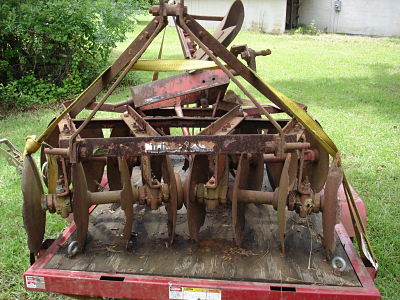

I found , for sale a disc, plow, and cultivator for 250.00. The disc is supposed to be 5'. What should I look for when checking these out? I talked to the gentleman tonite. He is selling for a friend. It has been sitting on her property for a while, and she has no use for it. Im looking to use it behind a MF135, and plant a small garden. Any help would be appreciated, as I am new to this. I already have a 5' rotary cutter, and a 6' box blade. So I am looking to add to my collection. If these turn out to be a good buy, what else should I add, to help with gardening?

A 5' disc is a bit small for your tractor but what the heck, it's sounds like it's priced low.
Make sure the plow is not more than 2 bottom. Look for how much wear is on the points and shares.

A 135 will play with a 5' disc. With the rear wheels set all the way in, a 5'er will still wipe out 99% of the tire tracks. You COULD use a 6' or 7' disc, but at that price.....!
Any 2-bottom plow in useable shape is worth the $250 all by itself.
The cultivator might bag $100 to $150.
Unless they're absolutely JUNK, that's a good buy.
If you're just gardening, you don't need the biggest, most extreme implements you can pull. I'd jump at a buy like that for your needs.

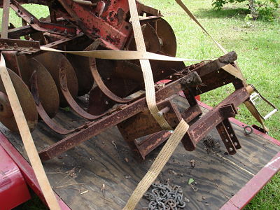

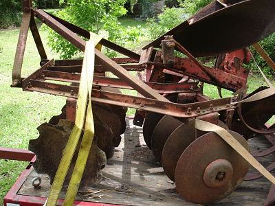

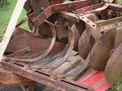

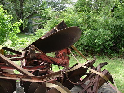

I just got back from looking at the set. Its pretty rusty, but seems like its all there. The "disc" on the disc would not turn. I expected that. On the cultivator the center pieces, I dont know what they are called, are almost ruted through. One worse than the other. The plow is a single bottom. I have attached some pics. Let me know what you think.

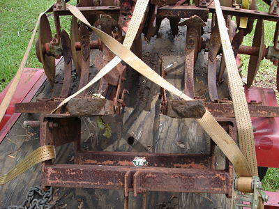

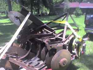

here are a few more pics

It's all light for your tractor but if just for a garden and low priced, what the heck. You can add weights to the disc after soaking the bearing in some kind of break free oil.
The tines can be replaced on the cultivator.
I can't see the plow real good. Check for wear on the front side of the board.
Will he throw in the trailer or free delivery?:D

/ Old implements? #16
Kenfy,
I bet the disks will turn. The disks don't turn independently. All the disks on one gang turn together. So trying to turn the disk that is hanging off the edge of the trailer won't work since the other ones are sitting on the trailer deck.
For $250, I'd buy that stuff and stop by the auto supply store on the way home and get a couple of cans of break-free.
And if you are going to take it home on that trailer, you might want to bring some extra tie downs. That load looks a bit precarious.
