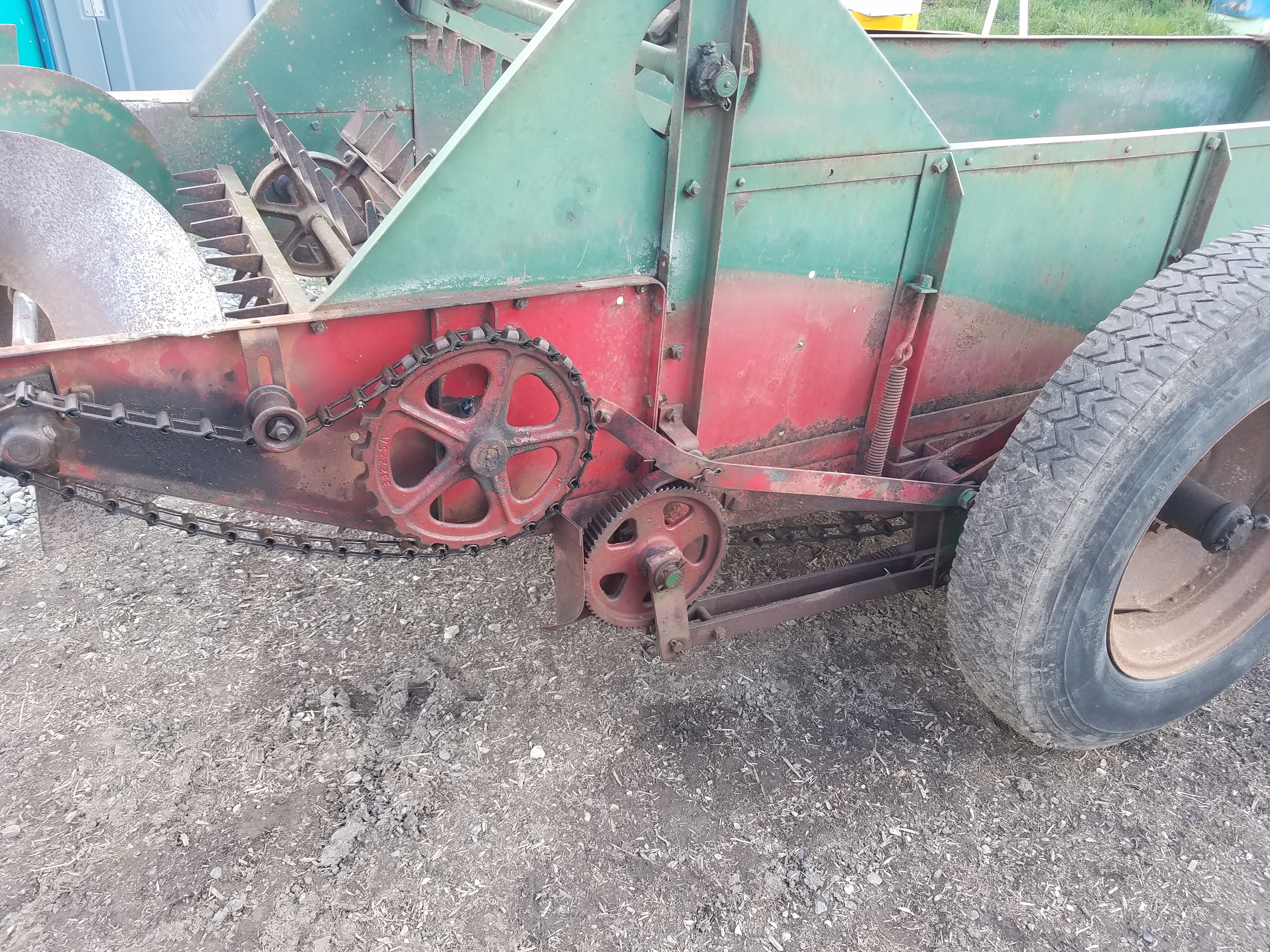

I have an old IH Manure Spreader - not sure the model. Can anyone identify this chain and lead me in the direction of purchase or making a new one?

It’s called Steel detachable chain, ag supply has it or just google it and you will find plenty.

It looks a lot like a International model 200 to me. What is wrong with the chain? If it is to long take a link out to shorten it.
I cannot remember the size of that chain but I seem to think each chain on that model of spreader is a different size.
They do a good job of spreading though and seem easy to pull.

If you look real close youll fine a stamped number on the link . That chain is found all over the place at ag supplies and online. I bought mine from Shoup online. Their catalog actually shows pics with dimmensional specs for the roll chain
