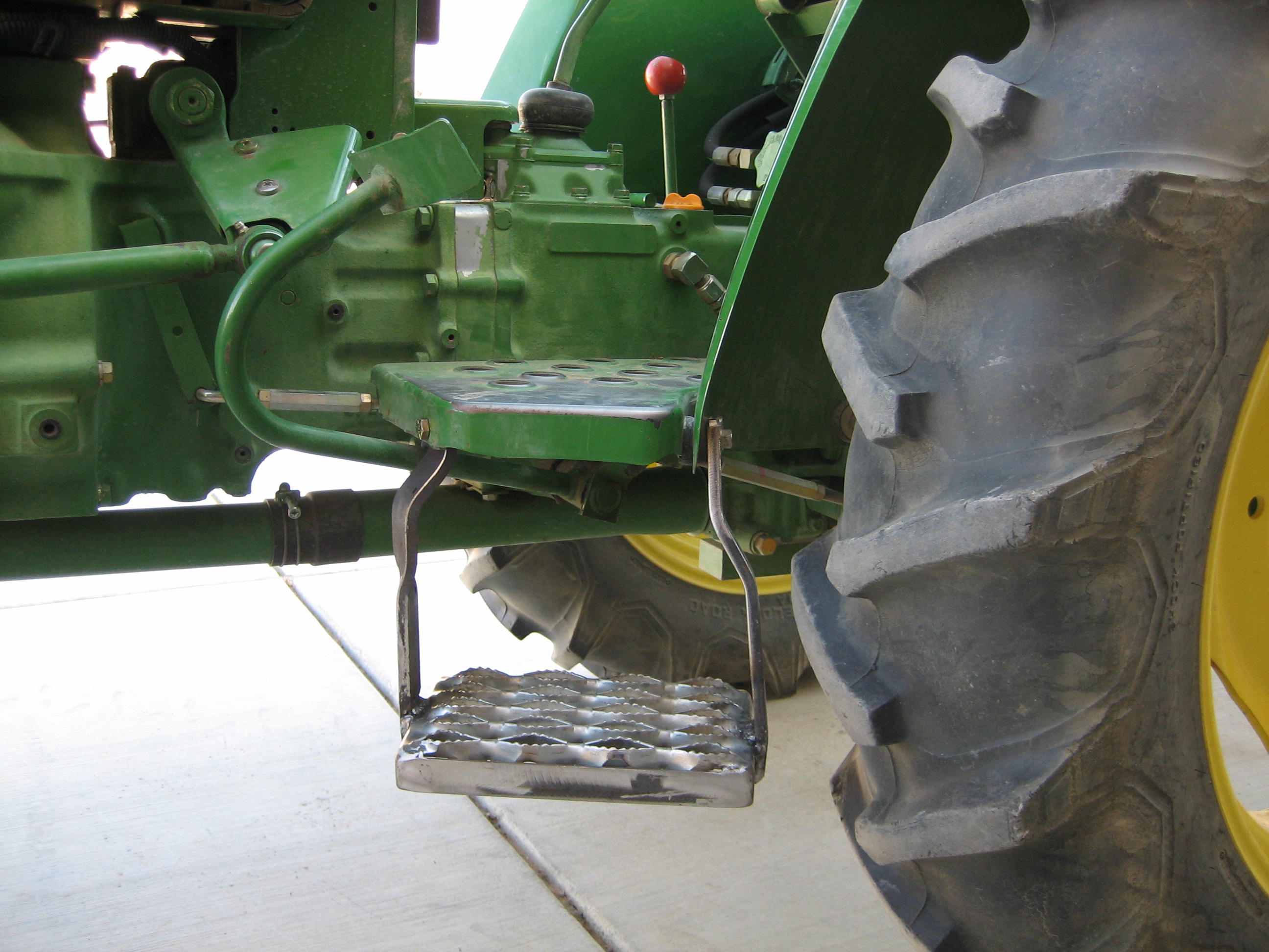

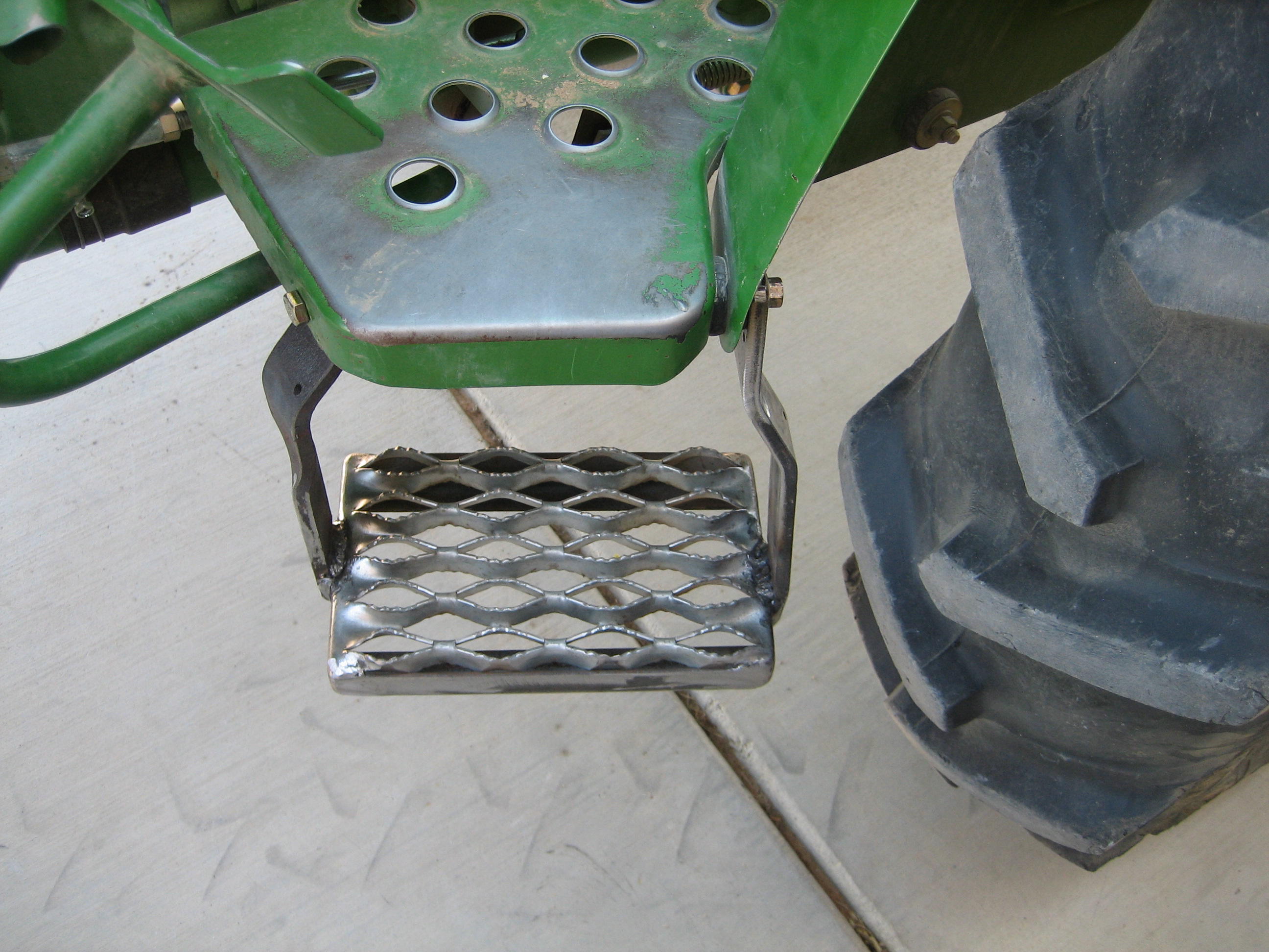

Thought I would make me an old fart step before I hurt myself jumping off my JD or strain something getting on it.;) It works great:D

I'll take one.
Eugene
   / Old guy step #4
Morning mfrost.
You may be onto something....sharp looking.
   / Old guy step #5

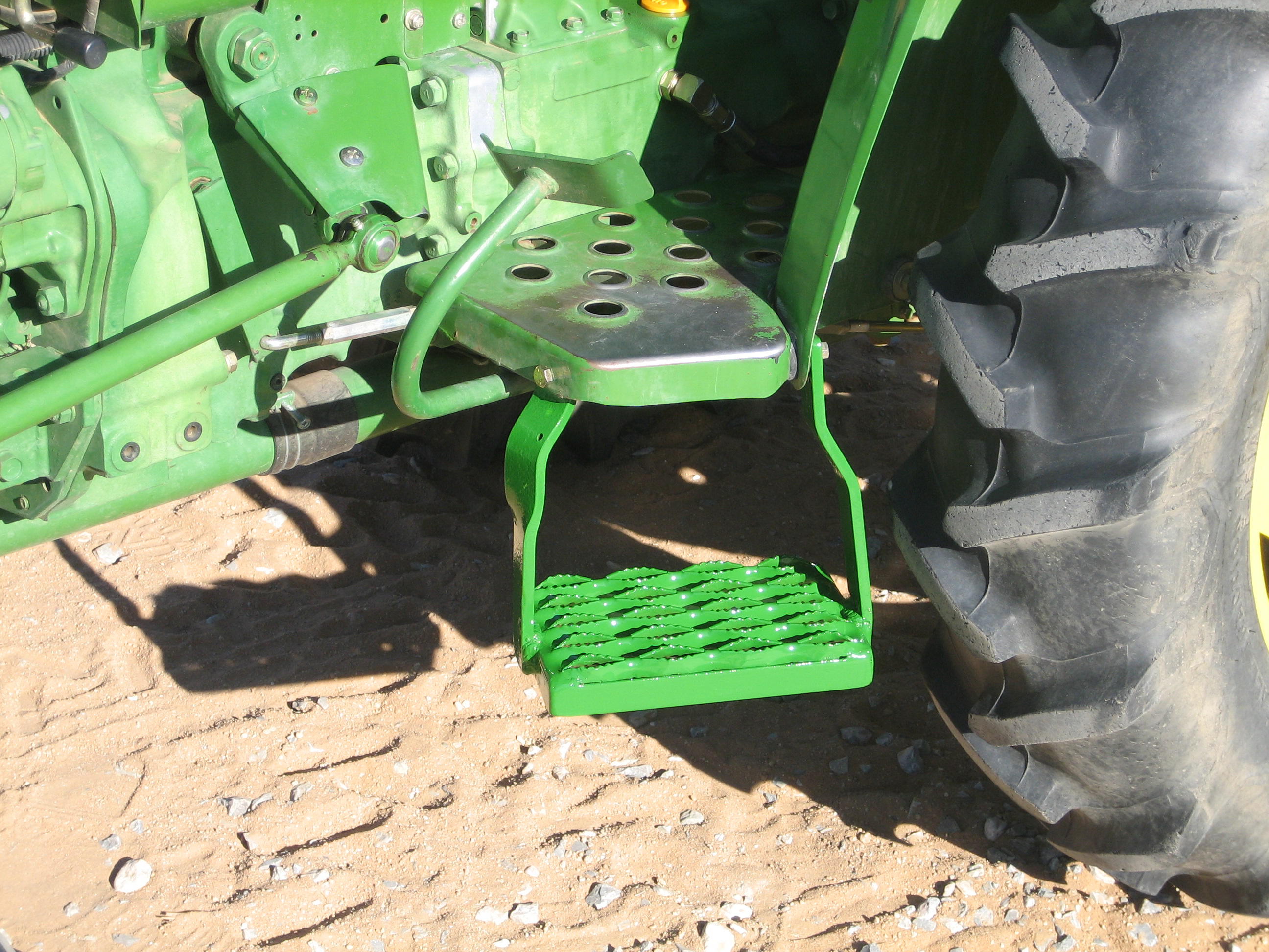

A little green paint and it would look like it came on the tractor. A great job. As good looking as the factory would (and maybe should) have done.
Al
   / Old guy step #6
Amen on the old fart step, I can relate, now I have an idea how to go about making me one. John

Thanks, here is a picture after I got it out of the paint shop and mounted. Now it looks like I need to paint the rest of the tractor. :eek: The paint that I got from TSC is a little different from stock but a litle dust and it all looks the same:D It did go on good and has a great gloss.

If I had a Hinomoto I would make one for you or you could drive it to California and I tighten you right up.:rolleyes: Take the idea and run with it.
   / Old guy step #10
Mfrost.. nice job.. hey anything that helps so you don't slip and bust your.. you know. The NH boomers have a similiar step.. but.. the step is not as deep as yours. I'm in the mud every morning feeding.. and have slipped multiple times.. saving myself pain only because I've had a good handhold when climbing up into the tractor. A step like yours would def. be an improvement.
One note. I wondered why on the NH boomer steps why the "supporting brackets" for the step are not that robust. The reason is.. if you snag a stump, large branch etc.. the step's "support brackets" will bend.. and not the operator's platform.
