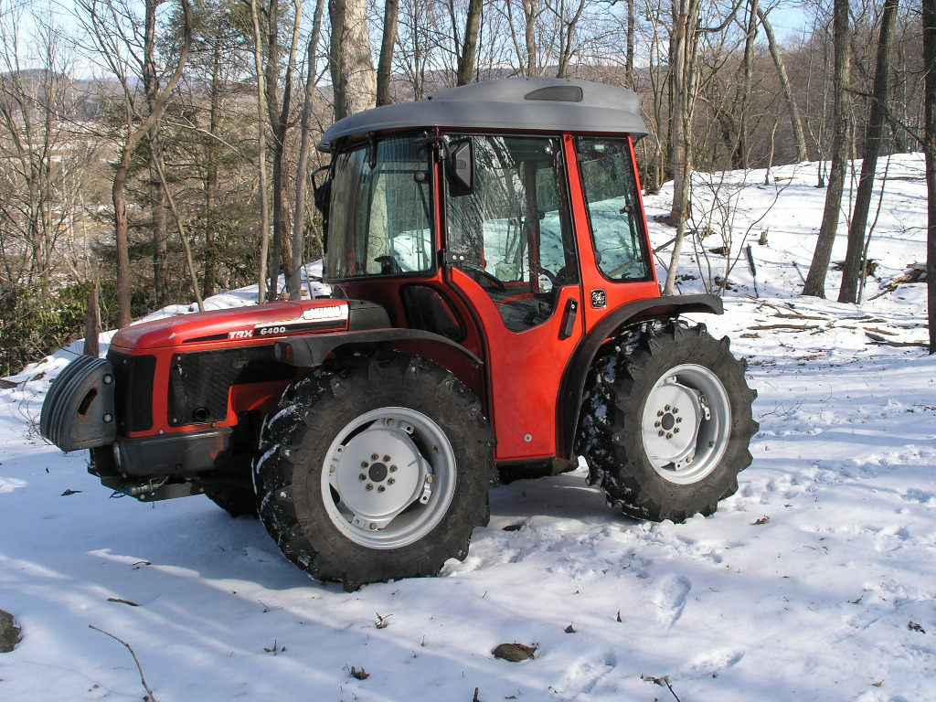

Hello all,
I goofed up and let my tractor sit for too many years and now it won't run. It has heaters, and after the dash light went out it started immediately like it always does. It idled well for about 15 seconds, shut off, and will no longer start. There is a primer lever on the side of the engine. I could feel light spring pressure but it didn't seem to be pumping any fuel. Best guess on the age of the off-road diesel is around 8 years. I siphoned the remaining out of the tank and didn't notice anything odd about the fuel or color. Remote location and I was there for another reason but didn't have the time or tools to do any troubleshooting.
If anyone has ever been through this before I would really appreciate some troubleshooting help and what to bring up with me next time. I have lots of gas experience but no diesel.
Thanks

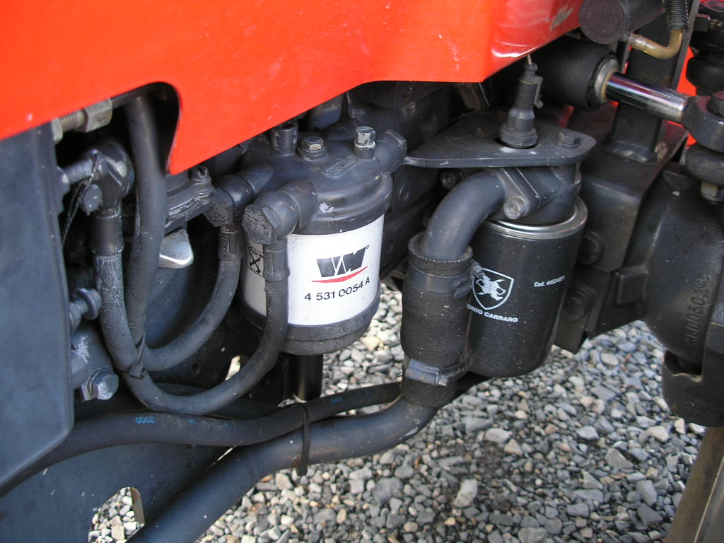

Thanks, I'll take a look in the tank, which is high up, and follow the outlet hose. The fuel filter hangs upside down so I can fill the new one with fresh fuel. The primer lever looks to be after the fuel filter flow wise. Is that mainly for bleeding air if the tractor was run out of fuel? It doesn't feel like it's pumping anything.

Not that it couldn't be bad again, but I replaced it about 10 years ago when I noticed it leaking.

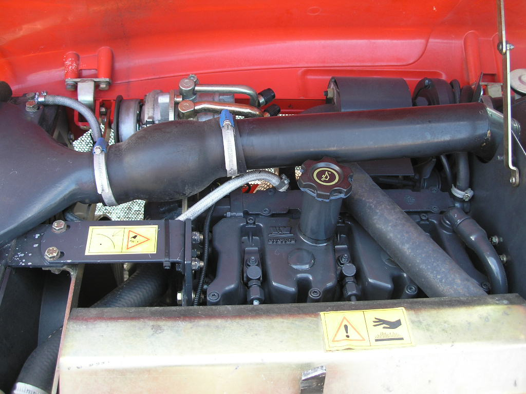

It's a 2001 Carraro TRX6400 with a VM Motori 61HP engine.
Stored out of the weather in a barn. It has a 13 gallon plastic tank and there was about 2 gallons in the tank. Yes, I saw the big difference in opinions plus long term success/failure in the ongoing "diesel fuel" thread.
The starter motor freewheels when i try to start it, meaning the engine is trying to run with very little load on the starter, but stops when I let off of the key. I think whatever the ignition switch controls to allow fuel is working OK or it wouldn't try to start. The silver primer lever is just to the left of the white fuel filter but it doesn't feel like it's pumping any fuel. I actually heard little puffs of air coming out of the air filter when I pump it fast. No clue why it would do that.
