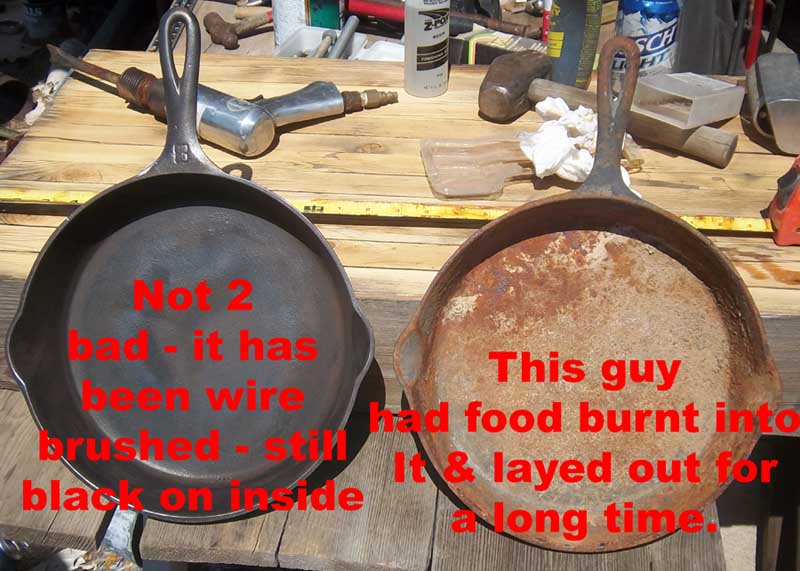

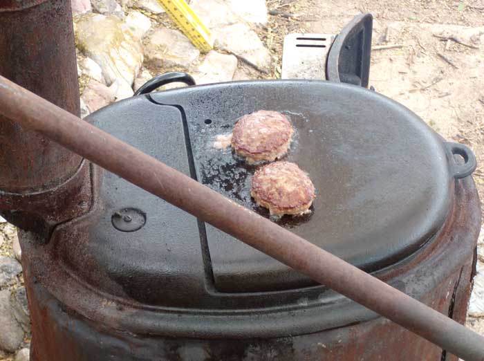

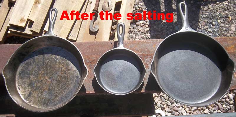

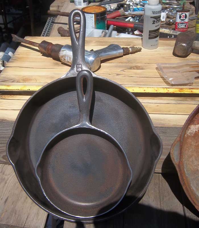

I just did 3 old skillets and a few years ago the top of a cast iron stove top.
First wire brush all the loose rust off, where you find the most pitting is on the rims, sand or grind that off.
If you can do the following outdoors, as I usually make a mess. Heat any kind of cooking oil in them add in a lot of table salt. Then smear the oil & salt all around. keep it up for a while and let the mixture get real hot. After they cool a little pour out the mess, wipe clean, re oil and heat again. When they cool wipe them out again. Your now ready to start cooking.
If you find deep pitting that hast to be ground out. Curing will take several go around's with the oil & heat.
Don't do as I did. Tried to do all 3 at the same time on the outdoor stove. Only 1 big and the small one would fit. IT was just 2 busy to keep up with all 3.
You can take the hot oil mixture and scouring rag to almost anything handy that needs some rust removed.
