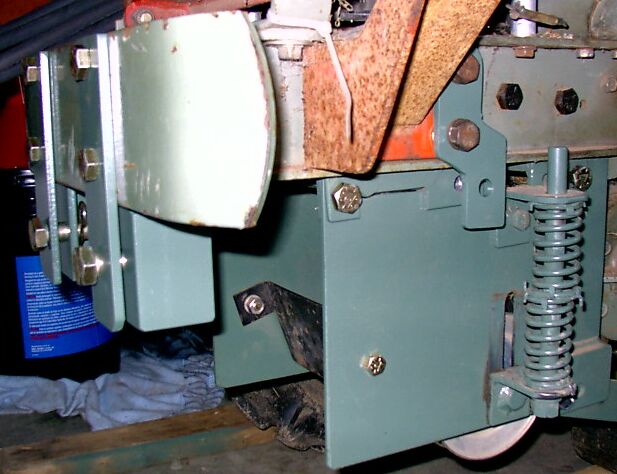

I am designing a belt and pulley system to get the belt to the deck. The belt will be driven by a pulley attached to the crank pulley at the front of the engine. Then two idler/tensioners will do a 90 degree forward direction change to the deck. Right now, I am trying to figure out whether I can fit an electric clutch in there or not. I'd prefer not to use one, but I don't think I'll be able to get enough slack in the belt to disengage it from the drive pulley and still allow the deck to be raised and lowered.
I did a bunch of this kind of design work to move the electric clutch on my YM1301D. The original design had the clutch in front of the bumper, but I couldn't use the loader with it there. So I moved it under the hood and designed my own idler/tensioner system. It works great, I have used it to mow my yard for the last two years. I attached a photo of the finished product. You can see more details at my web page.
