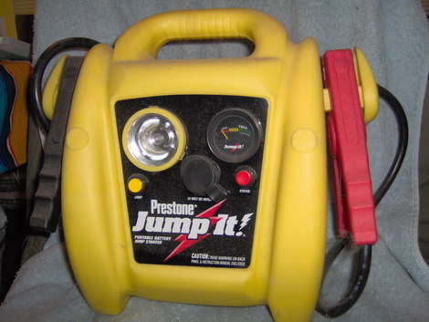

What I did was loose the battery and make a plastic block out of cutting board material and put two lugs on it, + and -. They are wired to the winch and I just use my jumper pack to run it. Has plenty of power and can easily load heavy stuff. I had to load my neighbors GM truck 3 times in one day and never strained.

Neat solution. Which jumper pack do you have? I'm looking for one now.

Seeing how the wires and hookups are going to be over $100 on each vehicle, not a bad idea. Which one you got(and how long have you had it)?
/ OK. I get it, but which winch? #11
Its a better one, about $100, and I have had it for over 8 years and its not missed a beat. Used it over the weekend to start a boat. It lives in my truck and I take it out and charge it about once a month.
It is not a WalMart special. No air compressor or anything like that. I am not sure of the model but its marketed by Peak. I have never seen another like it. I picked it up after going through 4 or 5 cheap ones. I got it a towing supply company in Indianapolis.

8 years! Might not find the same model, but at least give me the brand. Most of the ones I've known lasted for a year or two tops.

Thanks for the info. Peak has a nice 450 amp model that looks promising

Well sorry guys. I went out and looked and its a Prestone Jump-It. Not Peak. I had a "P" named company in my head. Its a model P-1410 and says 575 on it so I am guessing that is 575 amps. Its been by far the best one I have had. Most others will only last a few years as others have stated.
Sorry again. By the way I can not find any info on the web on it but will tell you its strong. It will start a diesel tractor, run a winch, start cars and boats, ect.
Chris
