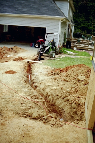

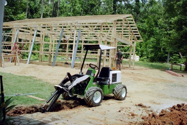

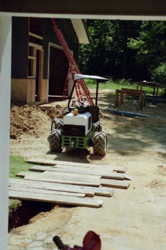

""That does look like it would take some getting used to. Pucker effect, I bet!""
PT Pucker is like driving a RWD car on snow covered roads. Each Winter, the first few times that the rearend slips to the side, your heart skips a beat. But by Spring you go down the road with the rearend swinging like a barn door, and think nothing of it!!
""I was wondering if the hoe would just pull the PT rather than digging in. I didn't realize the PT mini-hoe didn't move to the side either, but looking at the setup I can see that now. So there are more limitations than I was aware of""
Not really!! The advantages are many, the limitations are few!!
Here's a picture of my PT-425 digging an electric trench to my Morton Building. I dug from both directions, then did the center section. A few planks across the trench allowed me to easily proceed and pile the dirt well off to the sides. If I dropped a wheel into the trench, the PT just drove up and out of it! The amount of oscillation limits how far a wheel can go into a hole, and the PT doesn’t become unstable at all! NO stabilizers required! With my wheels reversed and the light weight of the PT-425 there was also less danger of the walls caving in!
The curl of the bucket does the digging, not the force of the arm. So you lower the arm, scoop out a bucket full by curling the bucket, lift the arm, then use the steering wheel and pedals to dump the dirt wherever you want it.
Buying a PT is like buying a car. Most people do NOT buy the cheapest one, or the one with the smallest engine, or the one without a nice AM/FM/CD, or without A/C, etc!! They get the best one they can that will be a pleasure to own and drive. So, get the PT-425 and enjoy that better PT, or try to save a few bucks and live to regret it!!
