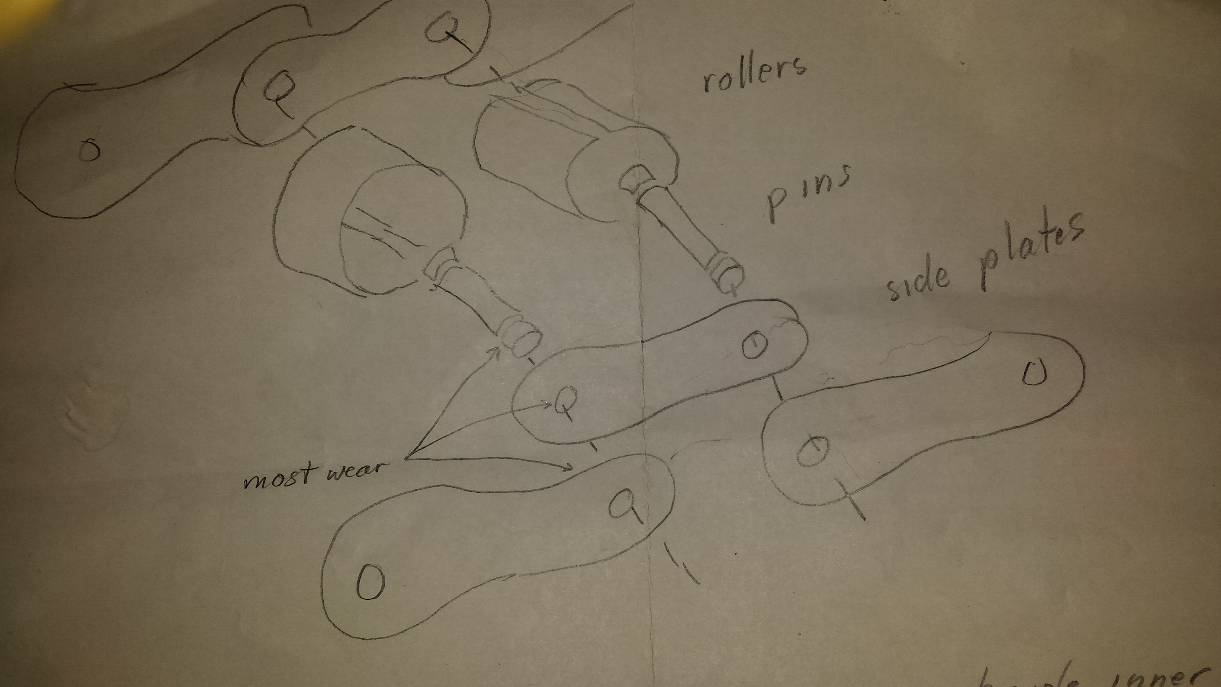

As bicyclist with over 100K miles in the past 5 decades I have some knowledge and opinions about chains. The greatest wear is on the pins and side plates. Chain "stretch" is the result of this wear elongating the holes in the side plates and reducing the diameter of the pins. Getting lube to those surfaces is problematic because the inner and outer side plates are in contact with each other and the pins are shielded by the rollers. As the chain elongates the rollers wear against the sprocket teeth in an attempt to increase the pitch. A good lube should be thin enough to penetrate to the pins but thick enough to provide lubrication, tacky enough to be persistent and displace water but not so tacky as to attract dirt and form an abrasive slurry. Obviously these qualities are opposed to each other, and there will be trade-offs.
The most effective lubrication is by running the chain in an oil bath within an enclosed chain guard. I recall some snowblower having this, but it is an expensive proposition. I also recall a snowblower with an oil reservoir and a petcock that could be adjusted for a continual drip. I do not recall the brand name of either machine. Most blowers have an exposed chain. As might be expected, conscientious, frequent application is more important than the lubricant itself.
My blower manufacturer, Lorenz, calls for 30 weight oil. When I change oil in any of my motors, I invert the "empty" oil jugs over a gallon can to collect the drippings. I put this oil in a "flexible spout oiler" I think I bought at HF or TS. To lube, I tie a light wire (24 ga telephone or a wire twist-em) to mark the first link and pump a drop of oil big enough to extend across each bushing from side plate to side plate. I turn the auger by hand until I have come around to the wire-marked link. (The wire is much more obvious than the "master link").
