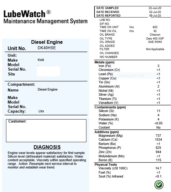

I've noticed that as of late, the T6 will show a greenish color as it begins to darken as the hours accumulate and the oil starts retaining products of combustion. All my engines exhibit that green tint now so I have to assume it's something in the formulation as none of them have any mechanical issues at all.
It will go from the greenish hue to brown to black as the deposit concentrations grow.
Just stick with your recommended change interval or use a spectroscopic oil analysis like (Blackstone) to determine when it needs renewed.
Not a big deal.
   / Oil with green tint
#20
Thanks 5030, that makes me feel better to hear someone with similar observations. I was trying to keep from using it until the oil analysis came thru but now with the USPS issues it will be 3-4 weeks ......right when I need it the most with vacation time and such to get things done.
I used it a couple hours the other day after we finally got rain to burn a few brush piles. Kept a close eye on the temp gauge and sound of everything and I am fairly confident it's healthy. Will keep using it I guess for now but still trying to get that analysis complete Asap.
