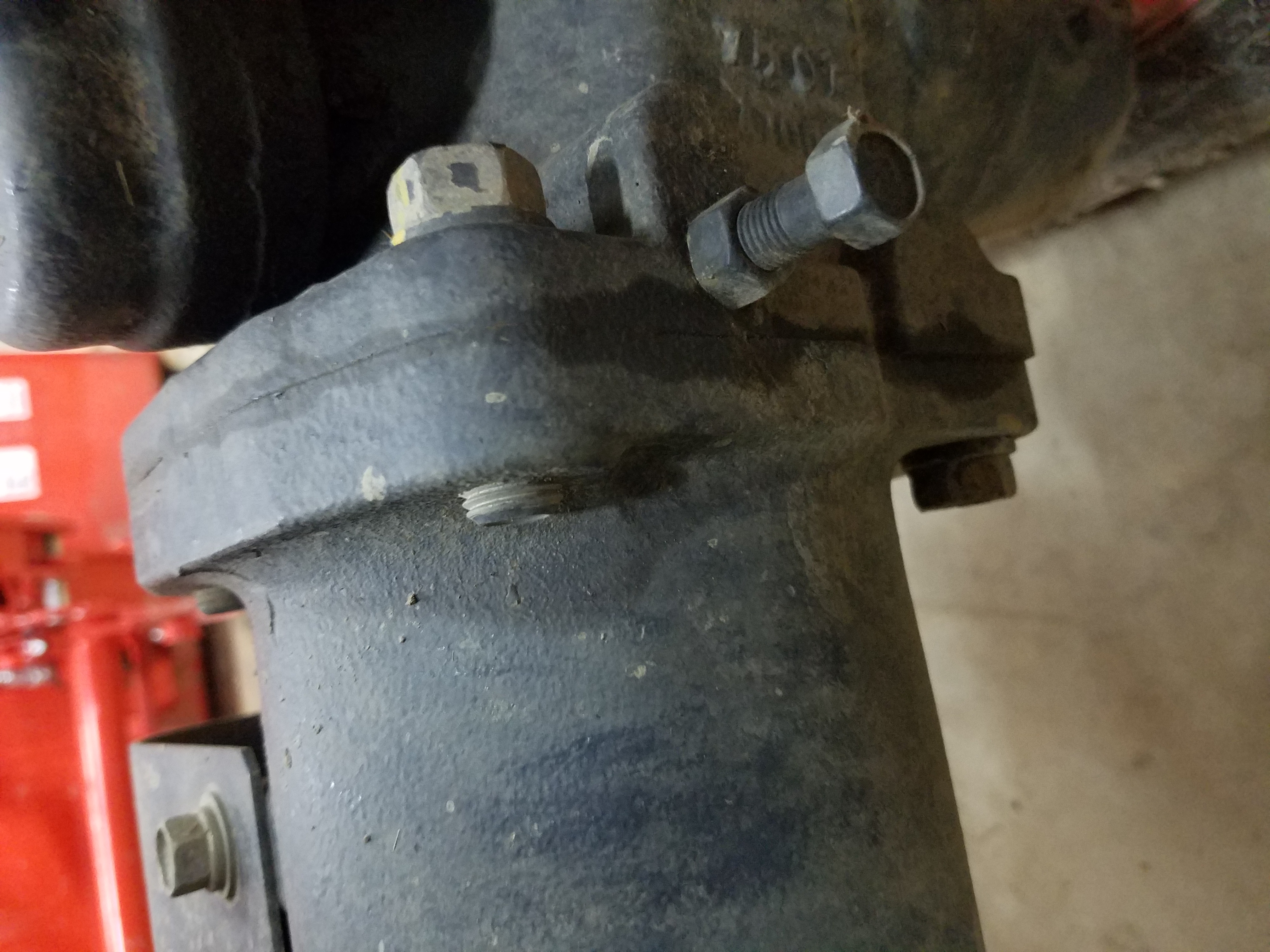

Jun 7, 2019 / Oil seepage front axle hub #1 G GamblerAcres Member Joined Nov 17, 2018 Messages 45 Location Ohio Tractor 2018 Kubota MX5200 MX5200 with 75 hours. Is this normal? Anyone have the torque specs? Attachments 20190607_222537.jpg 3.3 MB · Views: 114
Jun 8, 2019 / Oil seepage front axle hub #2 mdhughes Bronze Member Joined Jun 20, 2015 Messages 62 Location Festus, MO Tractor Kubota L3901DT With 75 hours on it, I would take it back to the dealer to have it looked at. The O-ring shouldn't let oil past it.

Jun 8, 2019 / Oil seepage front axle hub Thread Starter #3 OP G GamblerAcres Member Joined Nov 17, 2018 Messages 45 Location Ohio Tractor 2018 Kubota MX5200 I checked the axle housing for a vent. There isn't one. When I removed the fill plug I could hear a hiss as the positive air pressure escaped. I'm guessing the seepage will stop for now. Need to install a vent tube I suppose.
