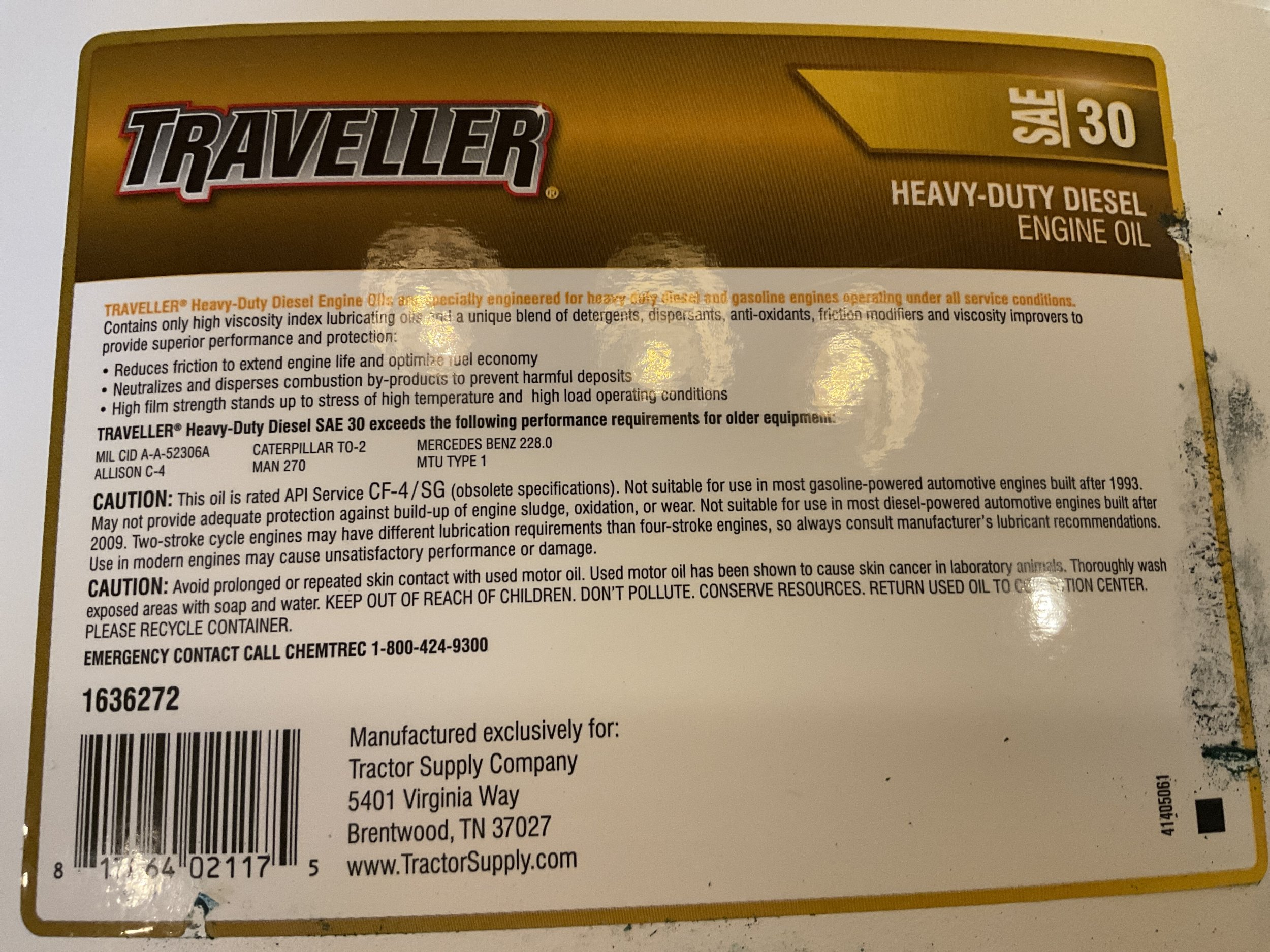

Read the parts of the label that says "do not use in diesel engines made after 2009". "Use in modern engines may cause unsatisfactory performance or damage" After reading that... I would have put it back on the shelf
/ Oil question #24
*R.T.F.M.*
He did, calls for CC which this oil covers. However I agree with the others that newer oil would be better.

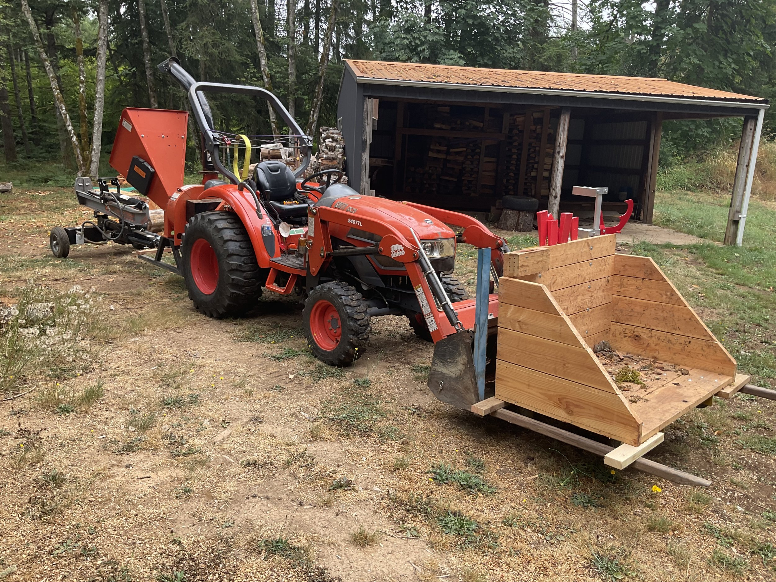

Thanks for standing up for me bro! I do have a Costco in the area, but they don't carry that type, but online they have it. Just ordered a case, great price and fast delivery 🚚. I'm going to change it out. I only have a couple of hours on it, what I didn't like was it is 30 wt,oh well! Thanks again brother.🇺🇦☮️✌🏻View attachment 743335
Nice rig, I like it (y)

From the Kioti CK 25/30/35 manual on
SAE 30 should be used in temps above 25C/77F.
IMO I would find a CK-4 15w-40 oil and just do a drain and fill. No need to swap filter. I’m seeing a lot more diesel oils recently at Walmart and my local TSC. If not, an auto parts store will surely have some.

That's exactly what my manual says!👍🏻

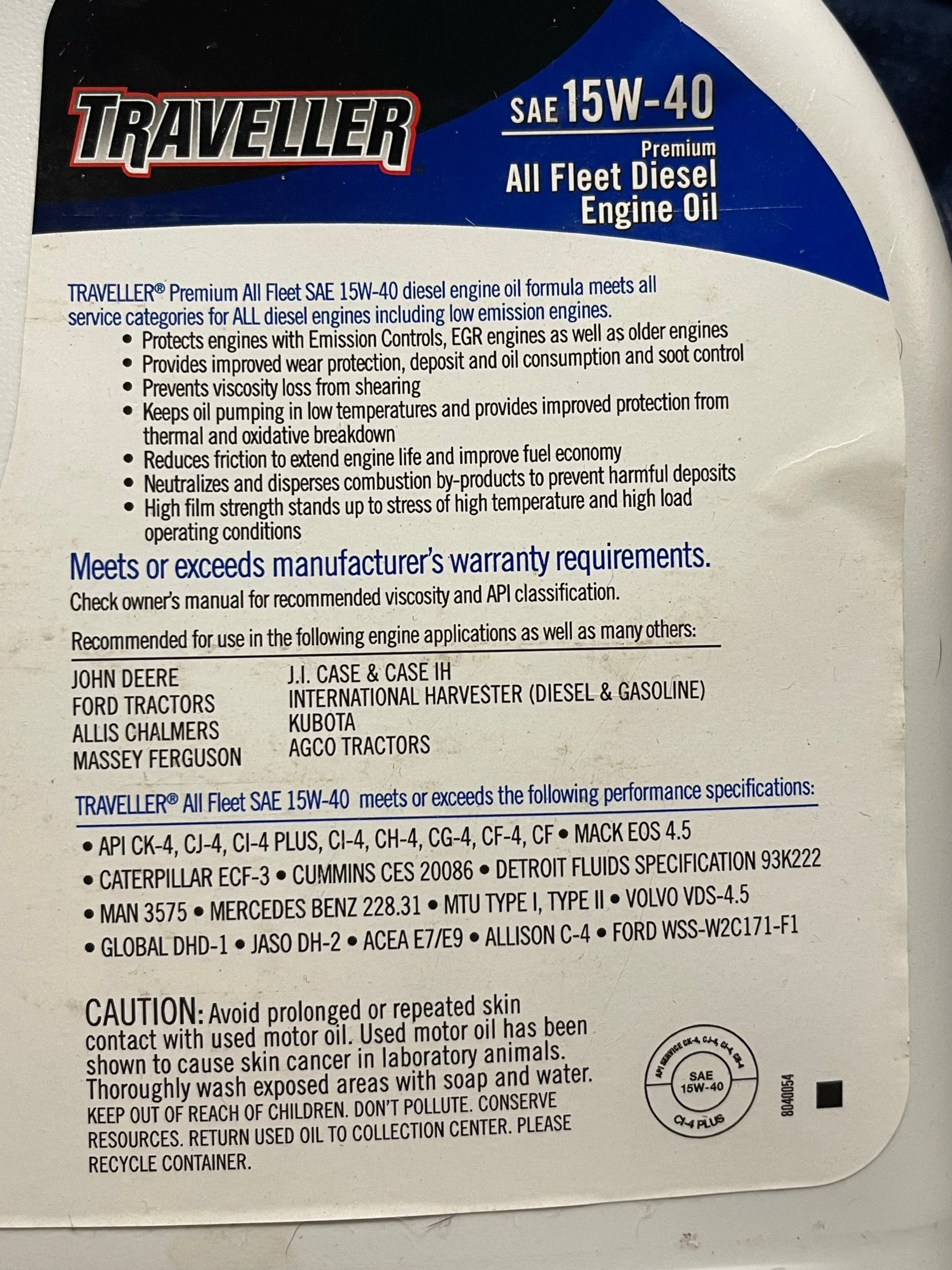

Hi all, need some help in determining if I used the right oil in my kioti CK25 hst. All I could find at TSC was
Traveller heavy duty diesel oil, manual calls for cc or cd, they were out of stock on most types!
Anyone have any knowledge that would put my mind at ease if I could leave said oil in engine? Thanks in advance! ☮️✌🏻

Go full Synthetic. Very simple answer to your concerns. Every vehicle I own, gas and diesel run on Synthetic oil. Will never go back to non-synthetic oil.

Thanks everyone for your help. I changed to full Synthetic the other day! 🇺🇦☮️✌🏻
