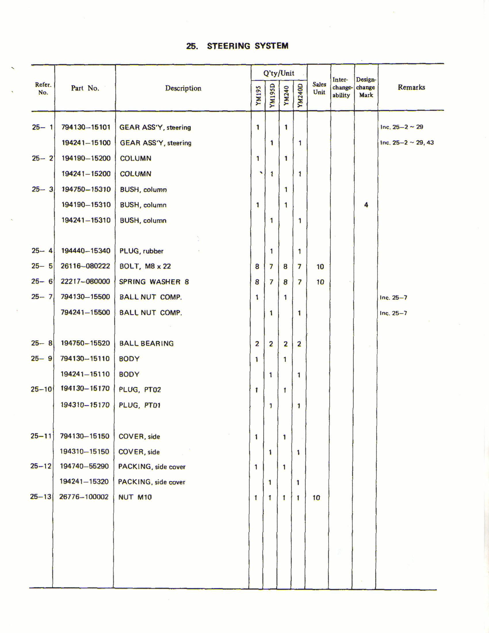

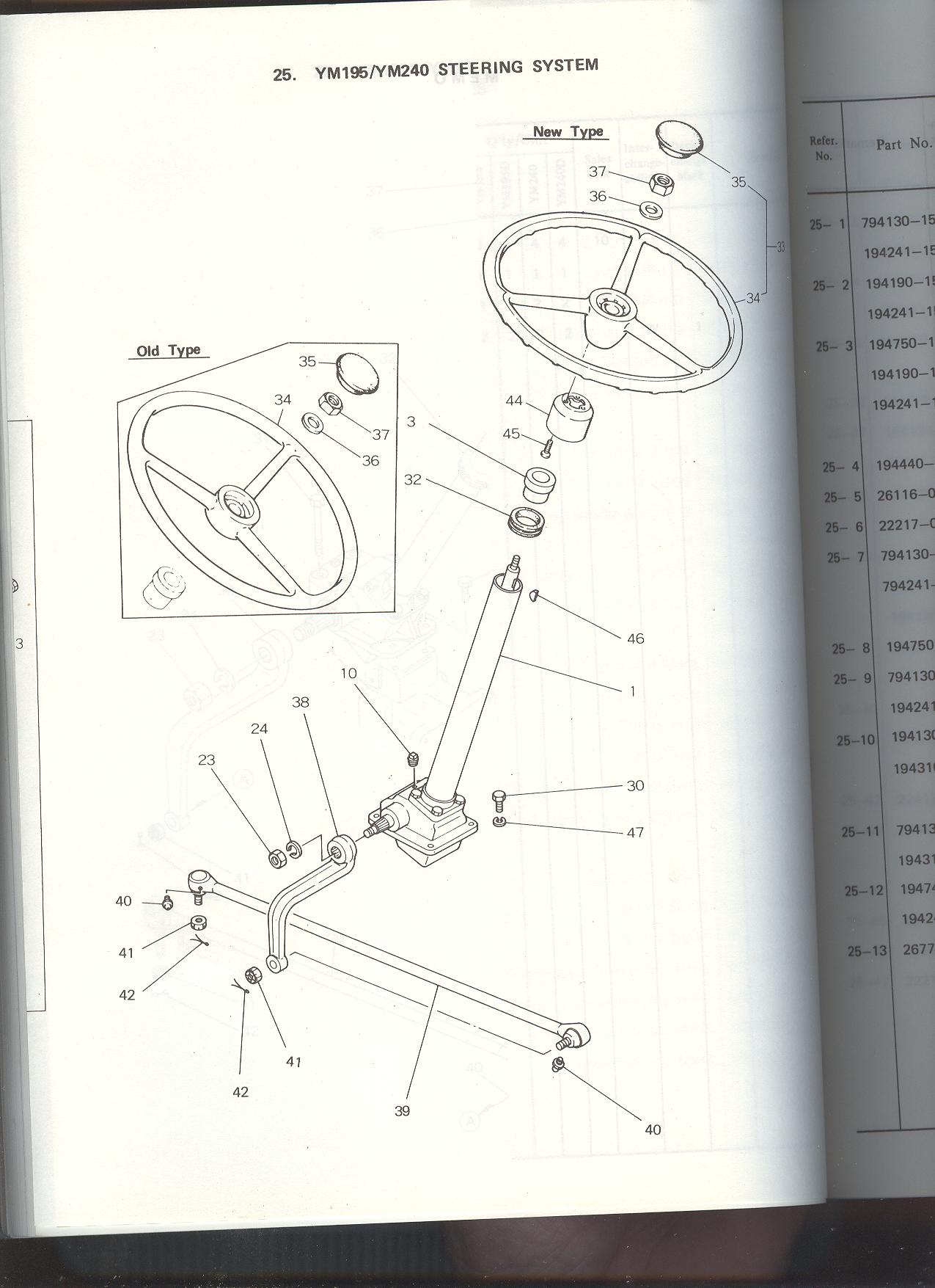

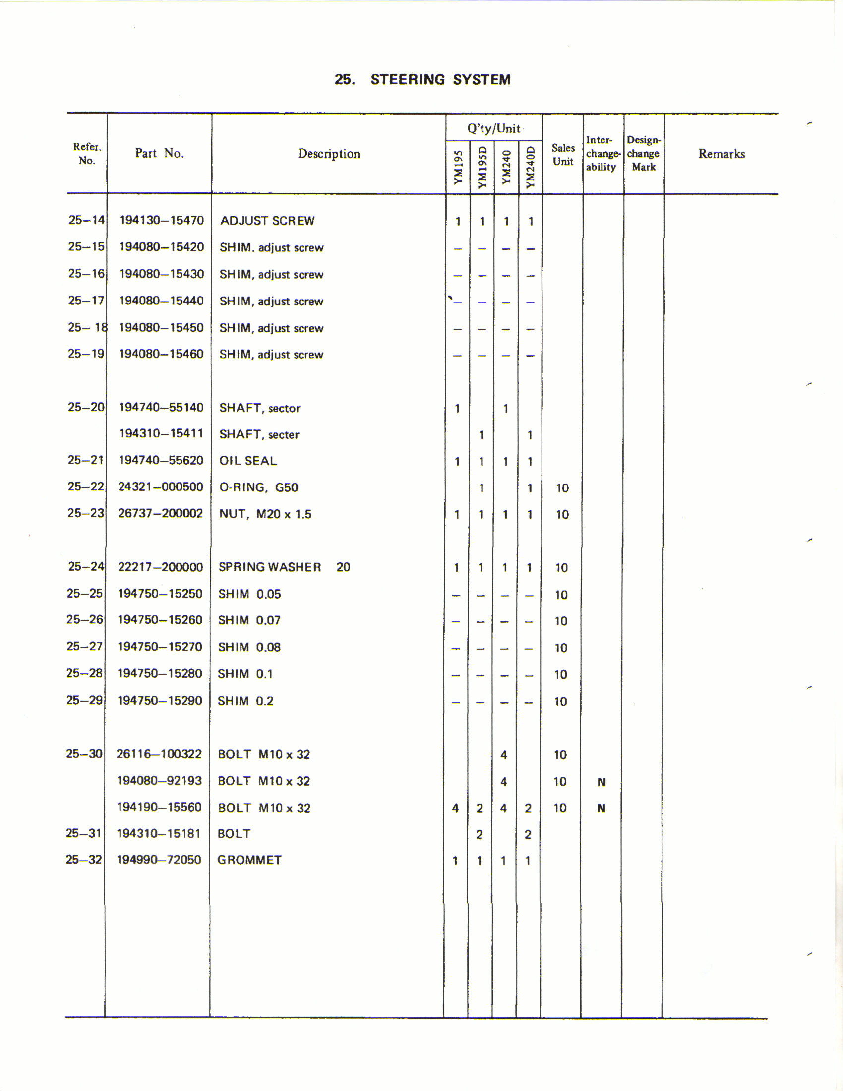

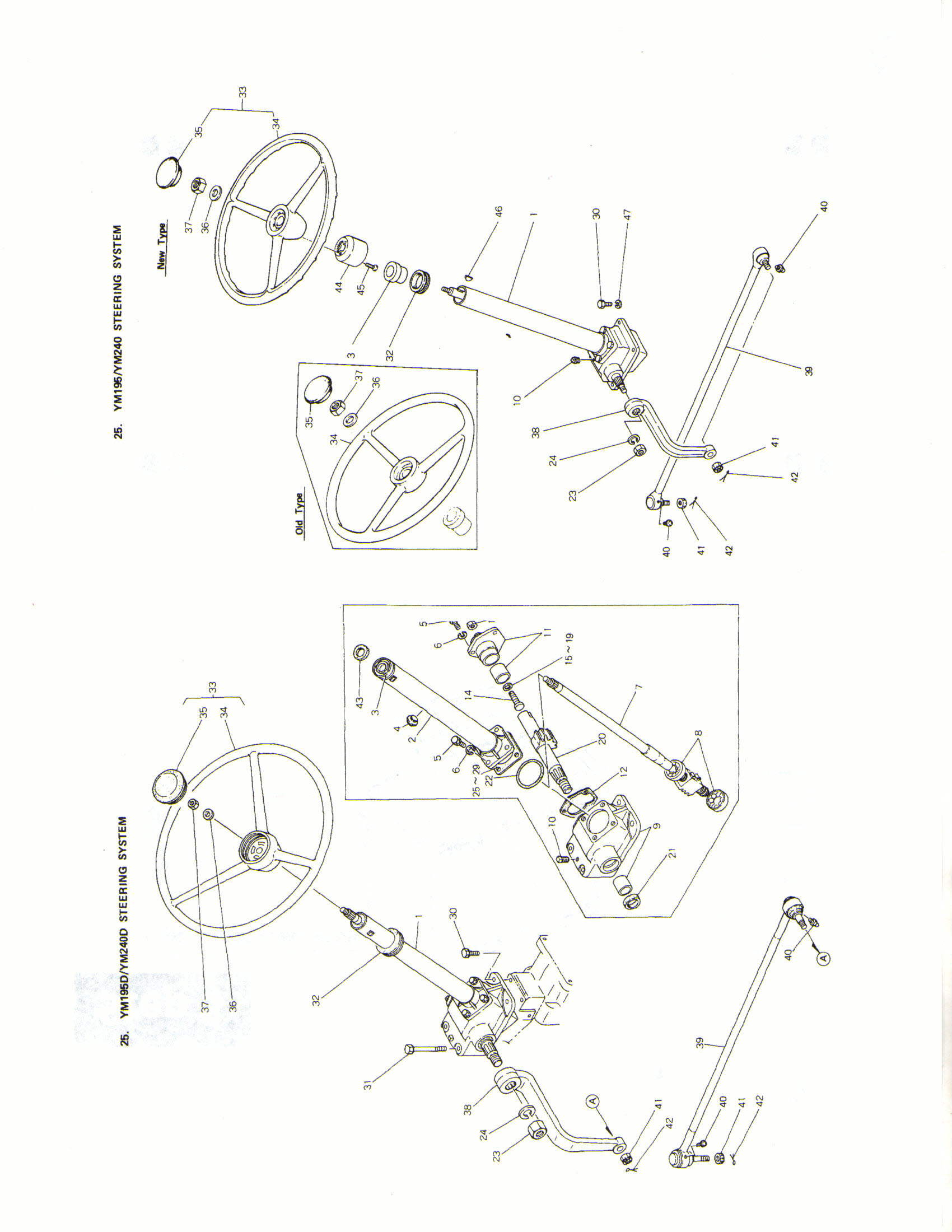

my little tractor has developed a leak around the steering shaft coming out of steering box! seems to be a seal there but i could not locate it in the service manual, any help would be appreciated. Thanks in advance
   / oil leak #2
SEAL - HORIZONTAL SHAFT IN STEERING BOX: Yanmar Tractor Parts 2021-01-23-062454_3.jpg2021-01-23-062454.jpg2021-01-23-062454_2.jpg

It's good to have the Parts Manual to see how parts are arranged in the diagrams. The images Winston shared are from the Parts Manual.
See attached for the YM195/YM240 machines.
