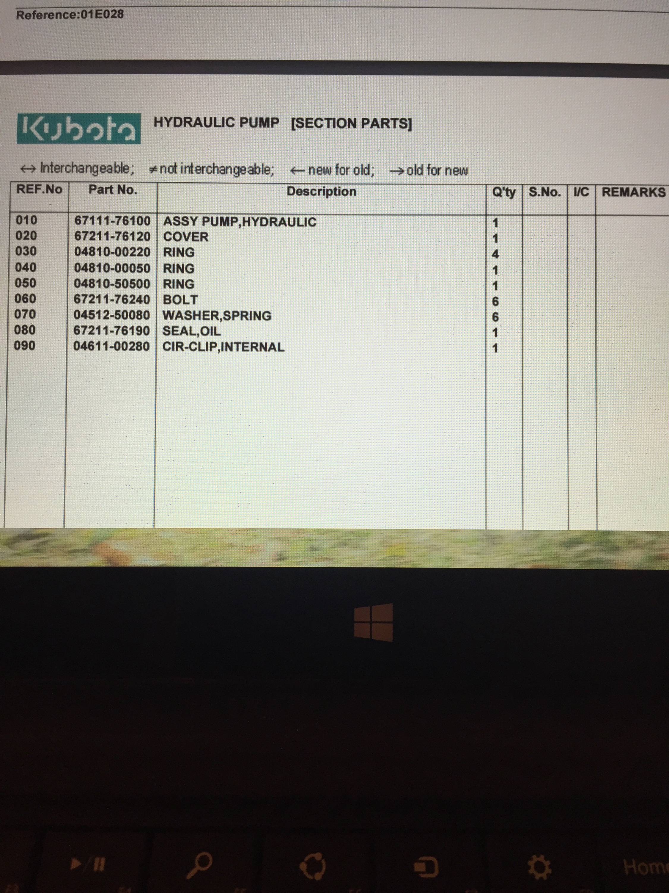

I haven't done one but it does not look too complicated. I'd guess that part 67211-76190, the seal between the pump and the engine, would be the culprit. If I was doing it I'd buy all the O rings and replace them while it's open.

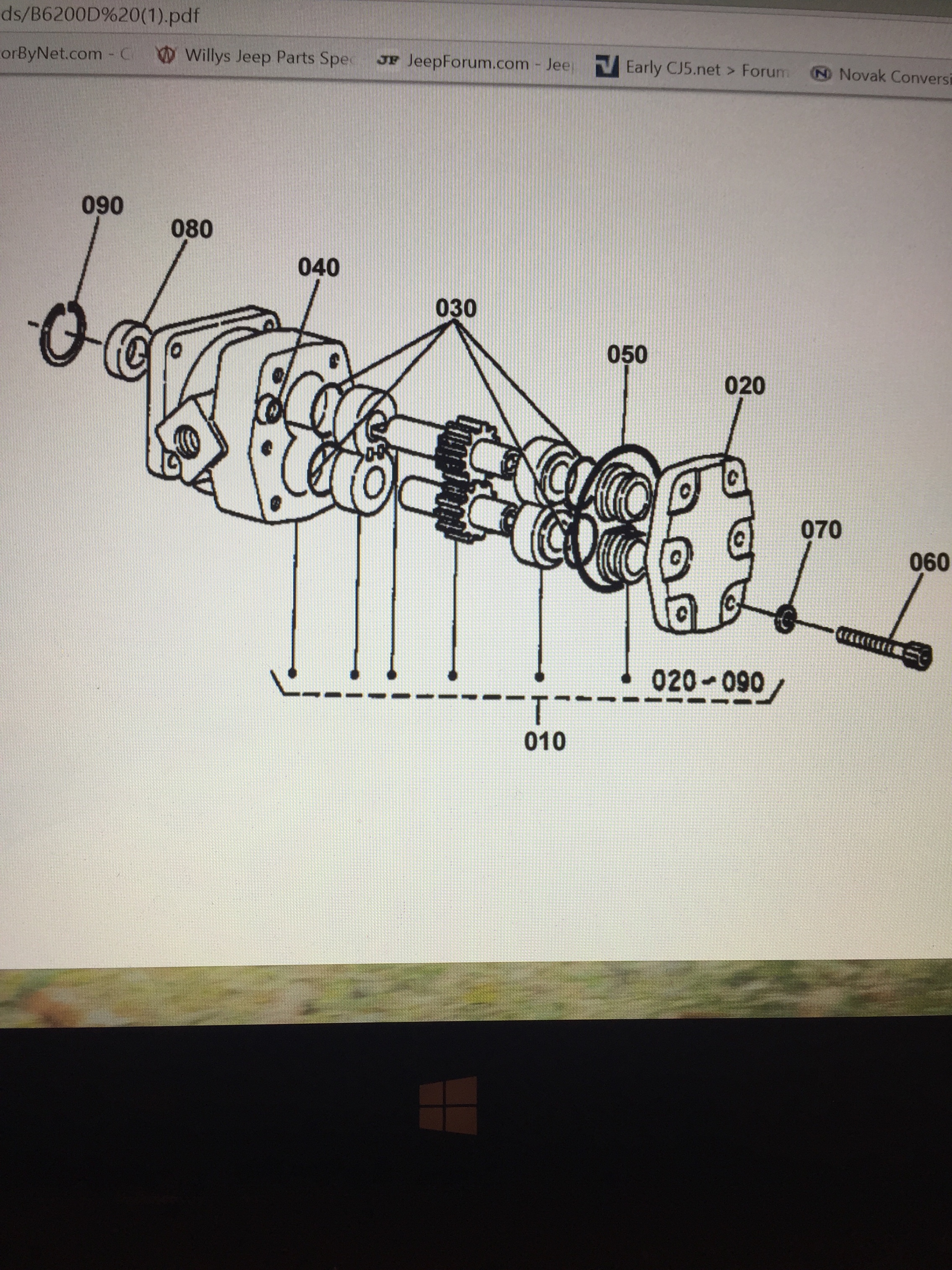

Does this diagram look correct? I'm guessing the 4 O-rings need to be replaced
/ Oil from overflow hose b6200d
I ordered the parts from Messicks and will post with updates. I hope all goes well.

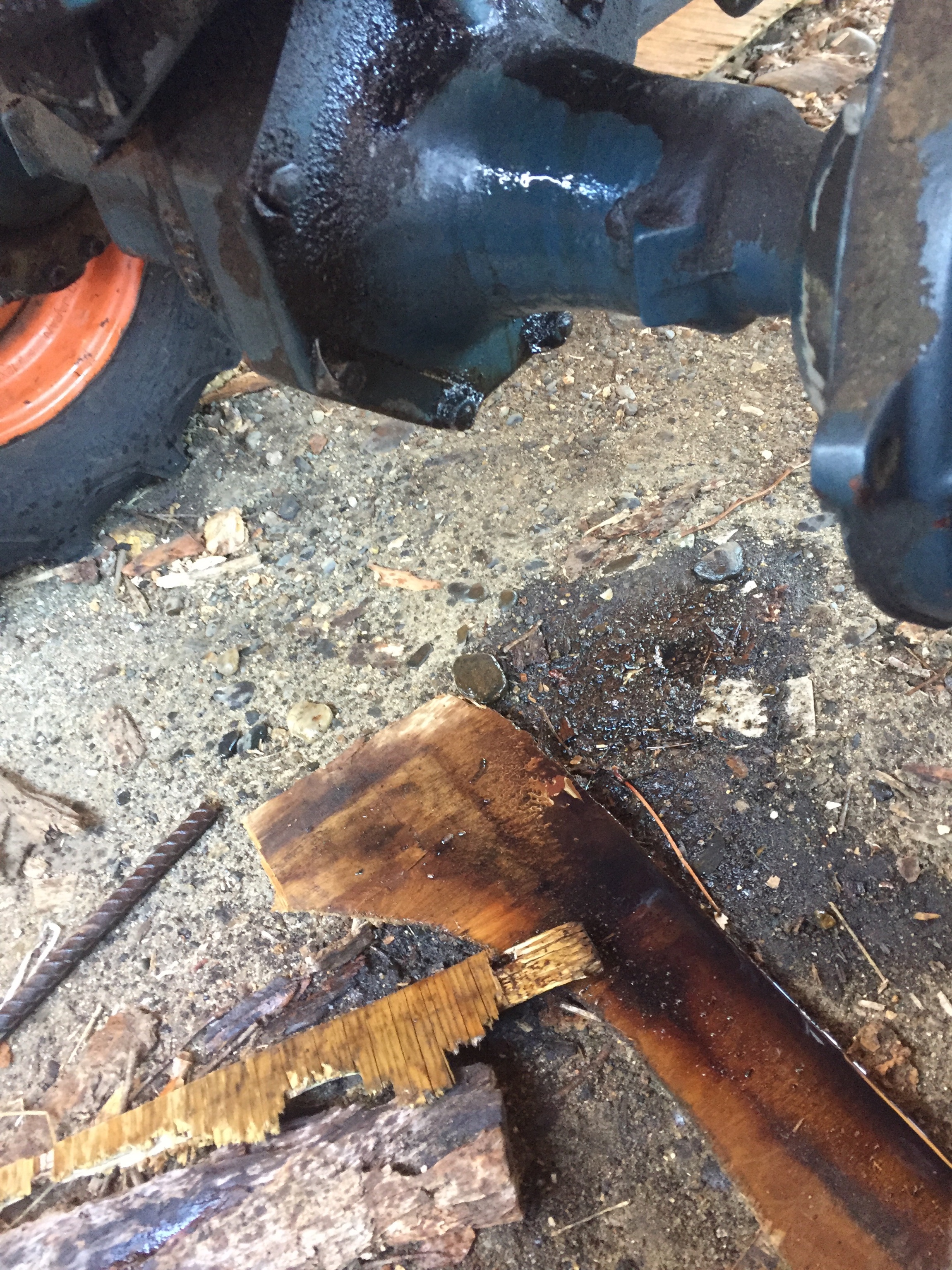

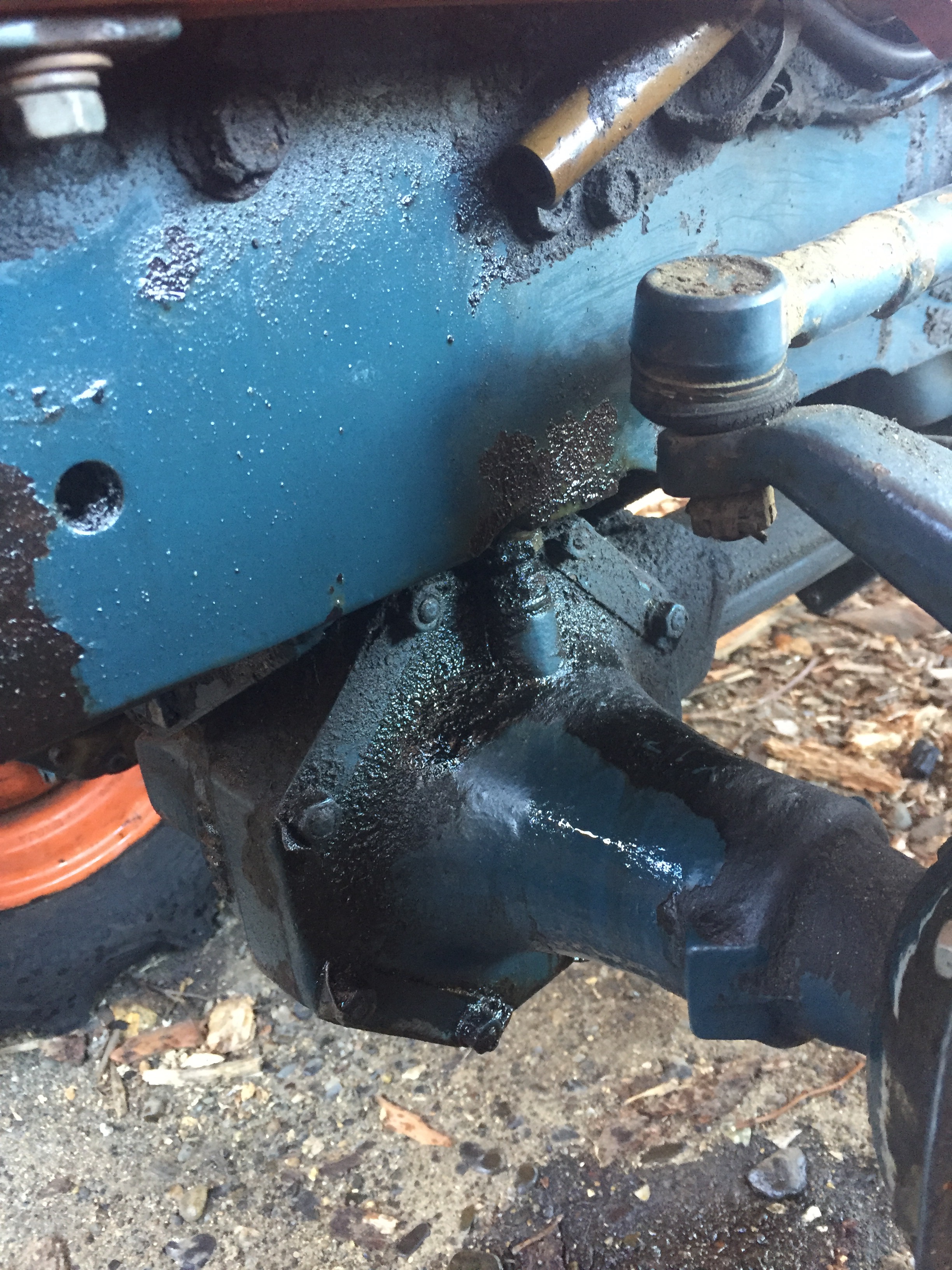

Took me 45 minutes to take the pump out, 15 minutes to replace the o-rings and the seal, and 1/2 a day to put the pump back on the tractor!!! What a PITA. Hopefully this fixes the issue.
#19
after all that work, the hydraulic level is still going down and the oil level is going up. Any suggestions?
/ Oil from overflow hose b6200d #20
Other than the pump, what are the possible entry points for hyd oil into lube oil? The pump is the only point.....isn't it?.........................Mike
