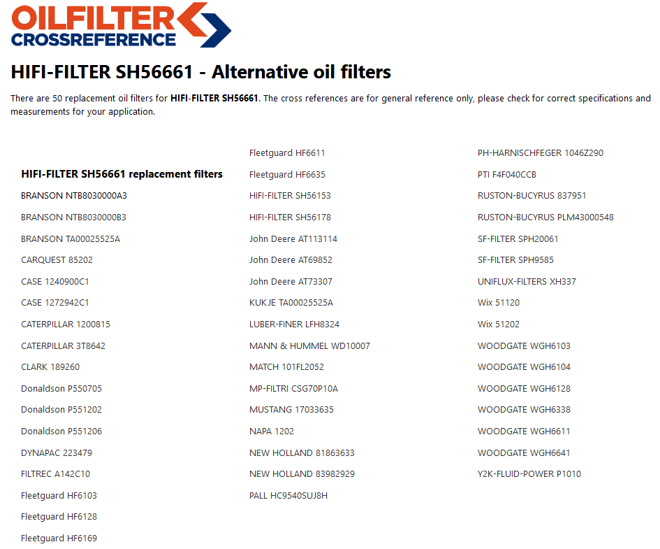

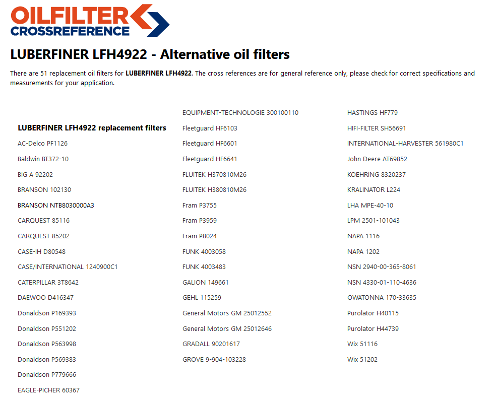

YF, I'm not getting many hits for a cross reference to this filter number.
The L-F has many cross references,
The HIFI got these as hits, NOTICE the 3 Branson sizes mentioned - - -
Are the filter threads identical for size and pitch? Are the canister sizes between the two withing an inch? Then they are basically the same.
Most Japan made tractors used common filters for many models. Hey, I don't have to educate you on that, right? :LOL:
If the filters had a cross reference to WIX or Fram or Purolator, I've would of been able to find further details. Rule of thumb, always go for the taller filter size.

oh, here is the linky for anyone to find filter replacements. :)
Oil filter cross reference
Even though these are CROSS REFERENCES, it's only for fit/form/function.
NOTE: There is no guarantee a filter has a by-pass valve inside. It's best to have one on a diesel engine ! So check the MFG website of the cross reference or call the MFG or dist of them. Best to be safe than sorry.

If you take the WIX equals, you can compare the two wix for micron filter sizing, by-pass valve, seal ID, threads and pitch. Then you know how close the two are to simply interchange.
