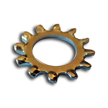

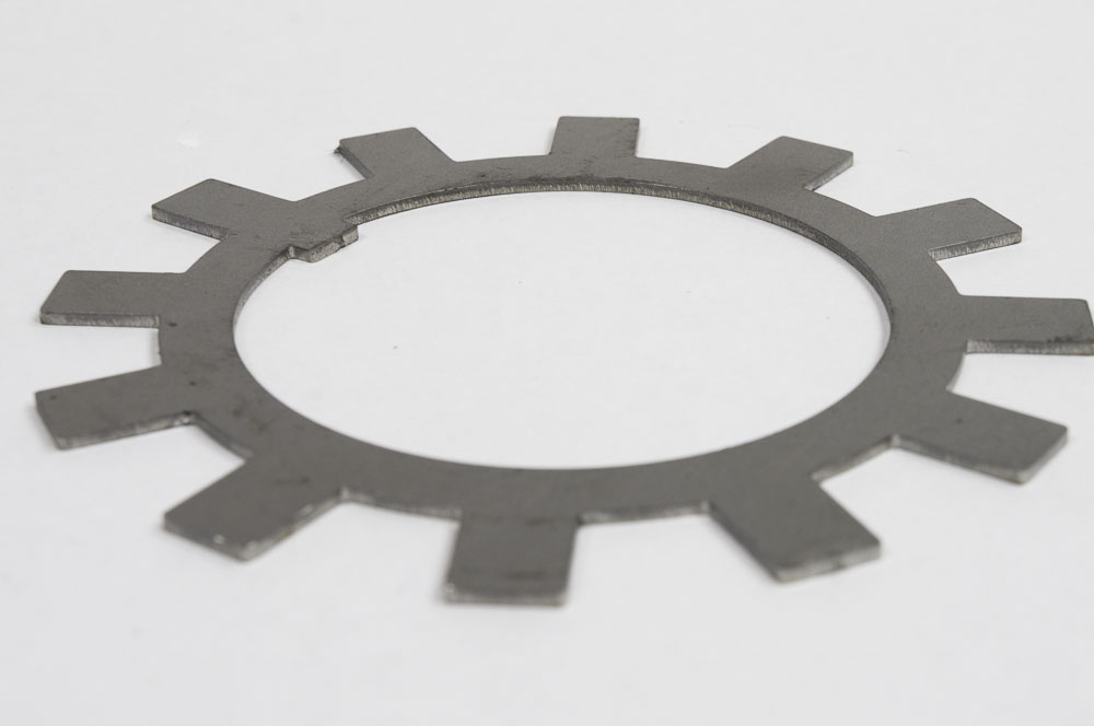

Is there room to include a lock washer?
If not (probably on a banjo fitting) then a Star Washer
There's a bunch of different designs
