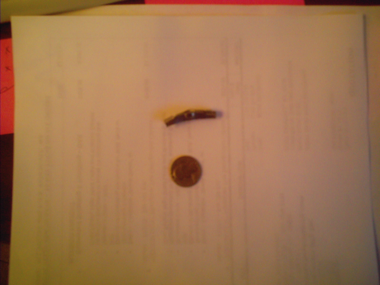

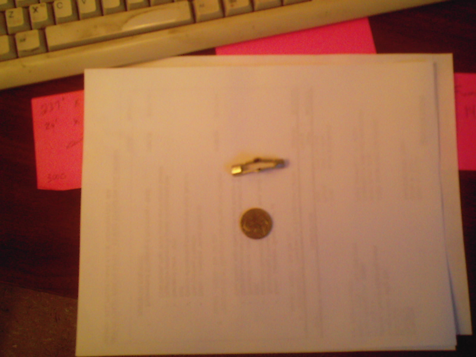

I have a high milage (200,000) 99 Ford F350 4x4 with the 7.3.
The guy before me used the quickie lube places to do the oil changes.
When I did my last (first for me) I saw it had a cheater plug in the drain pan.
One of these New Page 2
So I went to tighten (with my fingers) this thing up and the bolt snapped, which leaves me with the remainder of the bolt and the butterfly up inside my oil pan.
By all accounts I can find the pan will not come off mine while the engine is in the truck.
The three options I see and their plusses and minuses are below.
1. Leave the wing there (we spent a couple hours trying to get it out last night without success) put in a good repair plug and drive on.

Yes, if I could get that dang thing out, I would put a cutter plug in, in a flash and not think a second thought, I had it over the hole twice, had pliers on it, but could not manuever it to come out of the hole and currently cannot locate it in the pan. I have a feeling that it is now three legged, looking like a big T, the butterfly, as well as the remains of the threaded bolt that was through it. Not sure if they are all hung together, or if they are drifting around apart.
The hole is 14mm which is 9/16.
Thanks for any advice

if you think parts are still close to drain hole, add a quart of oil and see if it washes it to the hole. magents, claws, mirrors, and such on flexable shafts might help. Also the pan wouldnt have to come all the way off, remove all bolts drop as far as possible then tilt, wiggle and shake to get parts either over drain or into a corner then magnet out?

A couple of things- the Powerstroke pan is sealed on with a special silicone material that is as tough as it comes...you most likely aren't gonna break the seal loose with the engine in the truck without damaging the pan.
You already have a pretty big hole in the side where the dipstick goes in, around 2" or so. Carefully remove the dipstick assembly, being sure not to drop the inside part into the pan, you said it is leaking and needs a seal anyway. Fish around from there and see if you can pull it out the larger dipstick hole....

You could also try a big magnet and try to "drag" the part closer to the hole.

As was mentioned already the silicone used is rather strong. It has a high aluminum content and the factory tool to remove the pan is basically a blade with a handle and a place on the back of the head to hit with a hammer. It is driven between the pan and the block and driven around the outside edge to cut the silicone. If all else fails I could always mail you one of mine to use if it becomes a last resort.
Yes, in most applications you do have to remove the engine to pull the pan, especially on 4x4's. I usually found all I had to do was remove the motor mount bolts and pick up the engine as high as I could until the turbo would touch the firewall/cowl to gain just enough clearance to get the pan out. It's a very tight fit but can be done.
My first option would be to fish the wing/toggle nut out. You will probably not be able to get to it with a regular extendable type magnet. What I usually do in this case is get a good strong but small magnet and glue it to a cut off coat hanger. The coat hanger is nice and flexible and much easier to fish around in the pan through the rather small drain plug hole. Keep your fingers crossed the nut is not stainless. You can also get magnets on flexible shafts, I have a few but still find the coat hanger method works best through very small holes. It's much easier to manipulate due to it's small diameter and hey, there cheap. :)
I would highly recommend against leaving it in the pan and driving around with it. The last thing you want is it getting kicked around in the pan by the crank. Does the new plug have a built in magnet on it? If not this might be another option. Install a magnetic drain plug and try rocking the truck back and forth after the truck has warmed up. The oil's thinner at operating temp and hopefully the nut will get sloshed around twords the magnetic drain plug and stick to it.

Anyway, he lent me a borescope, and reminded me of something I had forgotten that one of the best tools in the world for that was a pair of hemostats.
So, went home, ended up 5 minute epoxying the magnets, one to an aluminum welding rod, one to a coat hanger, the Super glue kept giving up the ghost.
Played with the borescope for a while and could not get the angles to work right.
Went fishing in the dark with the coat hanger and with the little magnet epoxied on and heard a satisfying "click" then got it over to the hole, and with the hemostats was able to lock on and get it wiggeled, up, around, sideways and out.
Man, am I relieved.
Now I just need to find a drain plug, the threads dont actually look that hurt so I am thinking a Fumoco and red locktite at the moment.
Thanks so much for all the help and those that took the time to respond.
