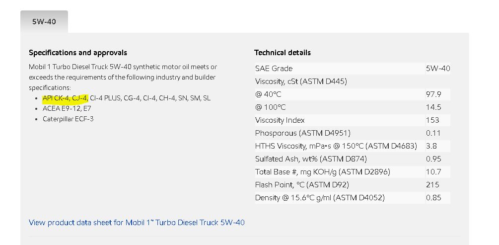

Lemme understand this. You can either use CJ-4 diesel engine oil designed for a tier 4 engine with a DPF, or you can use Ck-4 which is the exact same thing, but only 'out preforms" it, all in the same weight/viscosity?
pretty much all CK-4 oil is CJ-4 rated. It's kinda like going 55mph, you gotta go 50 before you can go 55!
From API:
API | Latest Oil Categories
My preferred oil (linked in a previous post)
It's not 30 weight.
"Clearer Directions?" :duh:
I... I just dont know. I have read and re-read that post, trying to make some kinda sense out of it. :irked:
