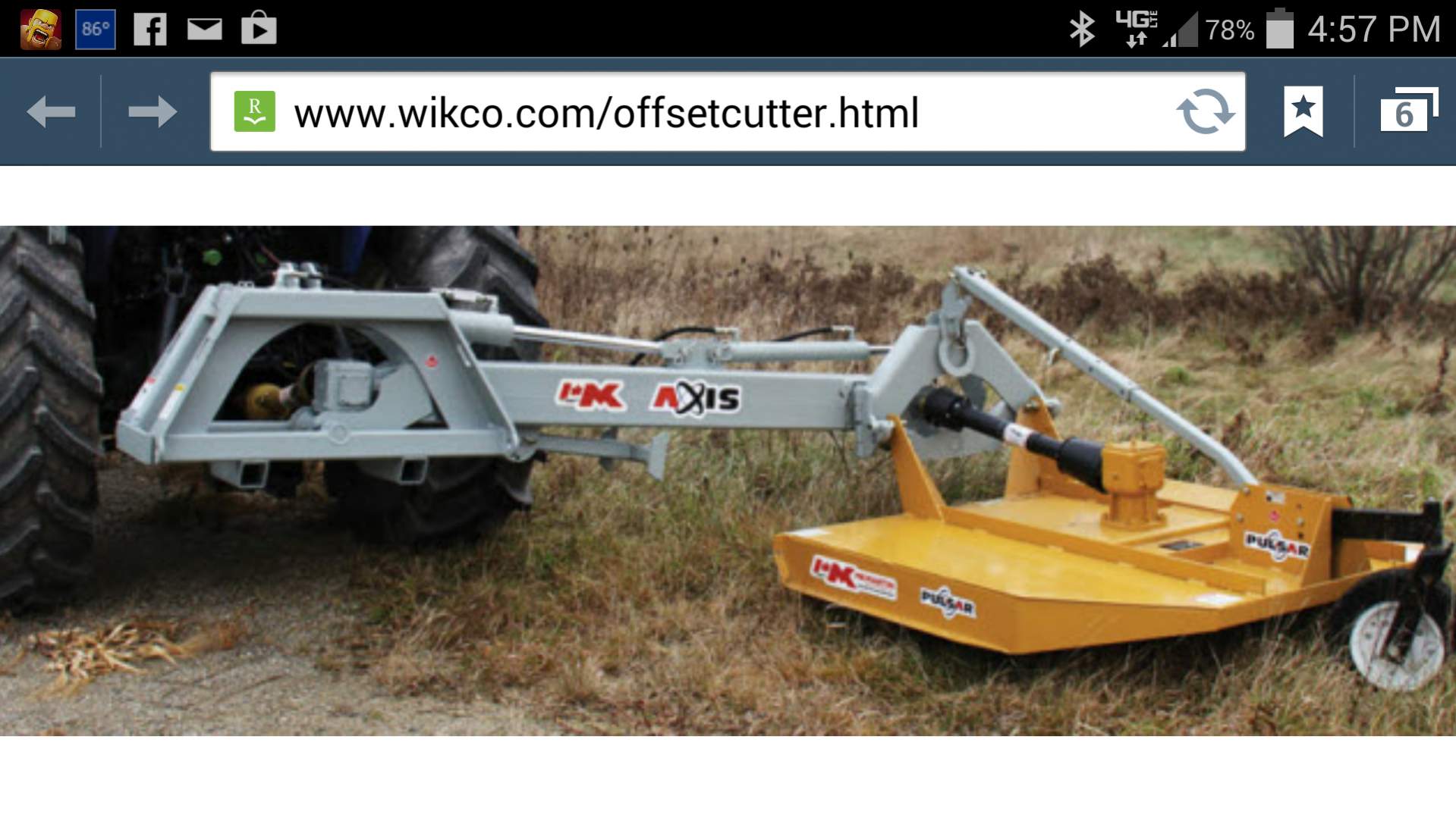

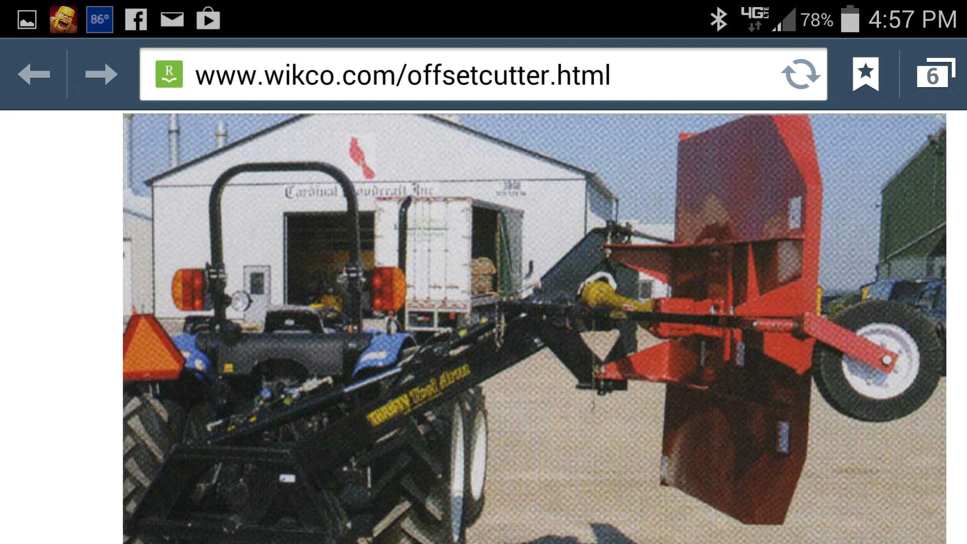

I've always wanted to build something like this never knew they where already out there any ideas on how this one is driven or ideas on how to build a drive for a homemade one. Maybe chain and sprocket ?

I appears to have 3 gearboxes, and a shaft that run along the boom.
   / offset bushhog #3
I am surprised they don't have any counterweight on it, at least that I can see.
   / offset bushhog
I wondered about that too it seems like it would really rack your lift arms.
   / offset bushhog #5
I know. Seeing how the far 3 pth arm has no down force to counter the torquing / twist effect, how do they stop this? Anchor to the drawbar?
   / offset bushhog #6
How big of a tractor u going to put it on????. i would design a way to put tractor suite case weighs on it so u can +/-any counter weighs
   / offset bushhog #7
I was just going to say... you need a heavier tractor to handle it... My 3011 has no problems lifting the 600kg, 2 meter Krone mower but in a heavy stand you keep correcting the steering because the offset pulls the nose into the uncut grass...
   / offset bushhog #8
We have an Alamo ditch bank mower at work. same principal only it is a dedicated mower. It has a hydraulic pump on the pto and works well. Like others have said though it has something in the line of a 50-60 gallon aux. hyd. tank as counter weight opposite the deck and it is very noticeable that it favors the deck side. I would suggest at least to match the weight of the deck if not go 20% to 25% higher for counter weight if you want good steering and traction. Also a good hefty tractor is helps to keep you going straight.
The mower this newer one replaced was shaft driven and was diverted through gearboxes at each 90* bend in the system. not nearly as flexible and lots of greasing required.
Good luck if you do decide to go about it and be safe.
