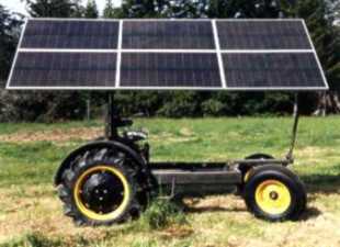

Hey, I also found a way to link this to tractors -check out the picture.
