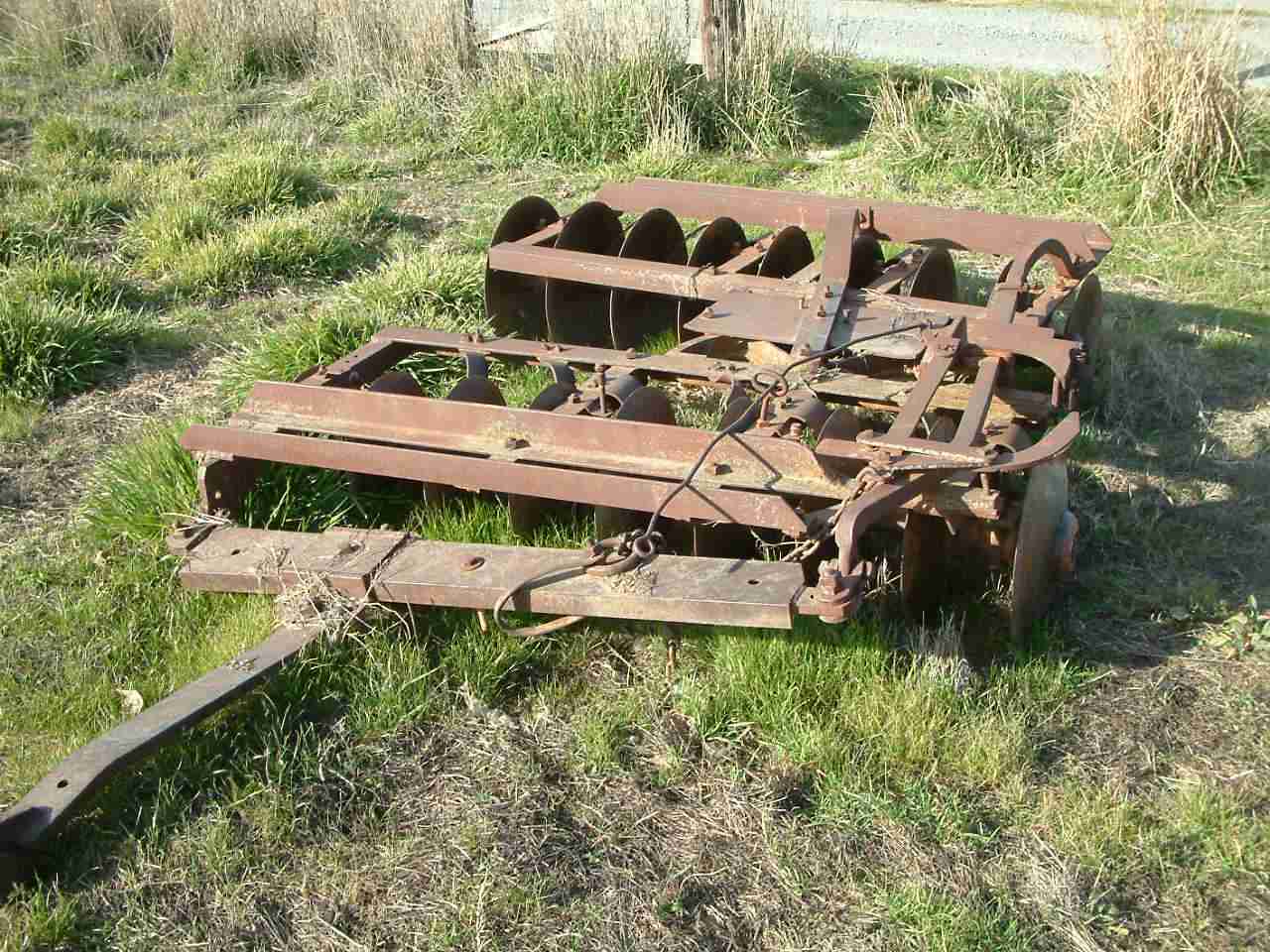

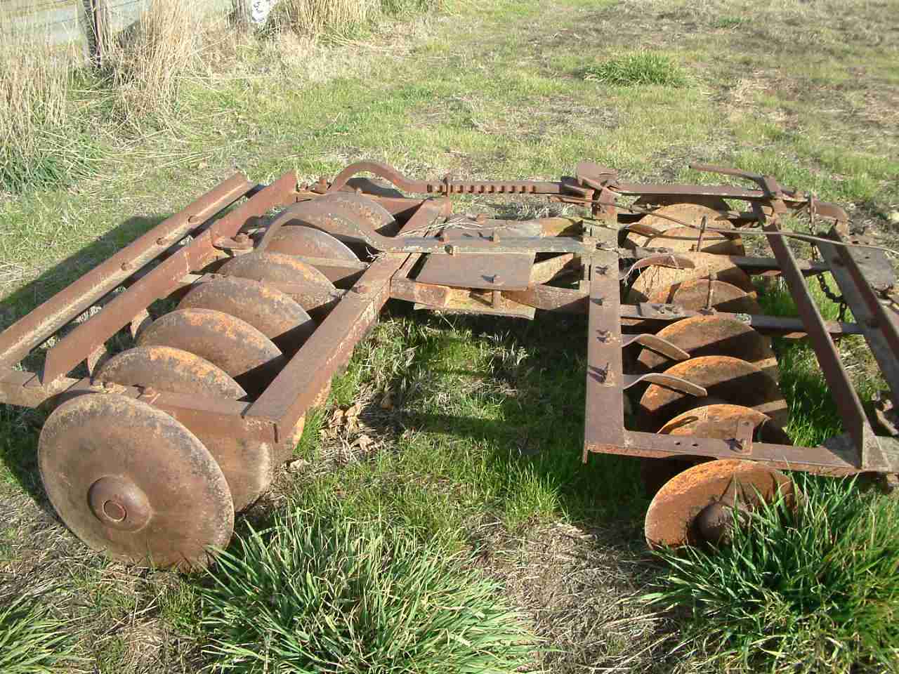

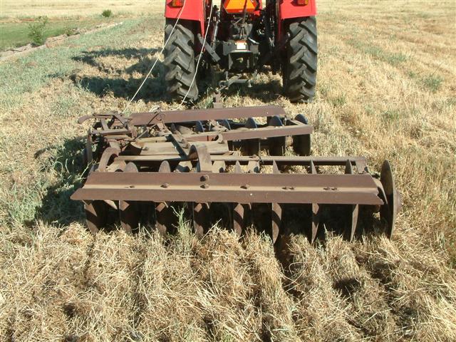

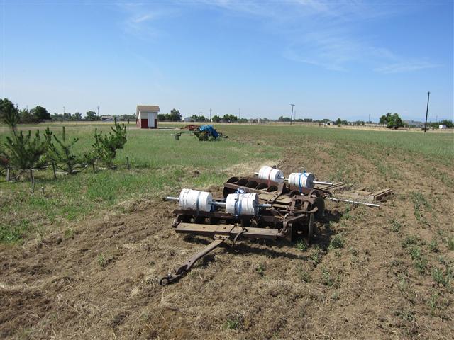

The larger offsets (10+ ft wide) generally are configured as wheel discs. My offset is an old 6.5 ft wide Towner pull type disc without transport wheels. A neighbor gave it to me and I fixed it up (a few new pans, new grease zerks).
I added about 500 lb of extra weight to get it to work better.
IMG_0371 (Small).JPGDSCF0063-small.JPGDSCF0064-small.JPGDSCF0292 (Small).JPG
In soft soil my 2008 Mahindra 5525 (54 hp engine, 45 hp pto, maybe 40 hp on the drawbar) works hard to get that offset disc moving fast enough (5 mph or so) to work effectively.
Here's info on a 9-ft offset disc with wheels. Looks pretty pricey.

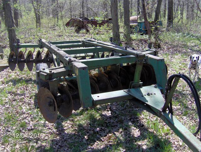

We pulled this 9' off-set with a 1958 JD 720D (54 HP);
/ off-set disc #11
I do not know how you pull that disc with 54HP. You may move it, but working it is another story. You need to run pretty good speed, 5-7 MPH. Any less and you are not getting out of the disc what it is capable of. I have that same JD disc, and when you put it all the way in the ground, 80 HP is not enough to hold proper speed. Usually I pull it with my 1066 IH (over 100 HP, and pushing 18-20K in weight) That JD disc works that tractor, and tears up a lot of dirt off the tires when it is being used.
If all you have is 62 HP to pull this, you will need a small off set to match to your tractor.
/ off-set disc #12
Dad bought that disk new around 1969 & quit moldboard plowing. Wheels up in 4th gear on the 720, tractor pulled it just fine! As memory serves, we were probably running up to 5" deep, depending on the ground. We would also use a JD spring chisel every few years, again depending on the ground. It started out with 20 or 22" blades, when I sold it 1-1/2 years ago the biggest blades were 18". ~~ grnspot
