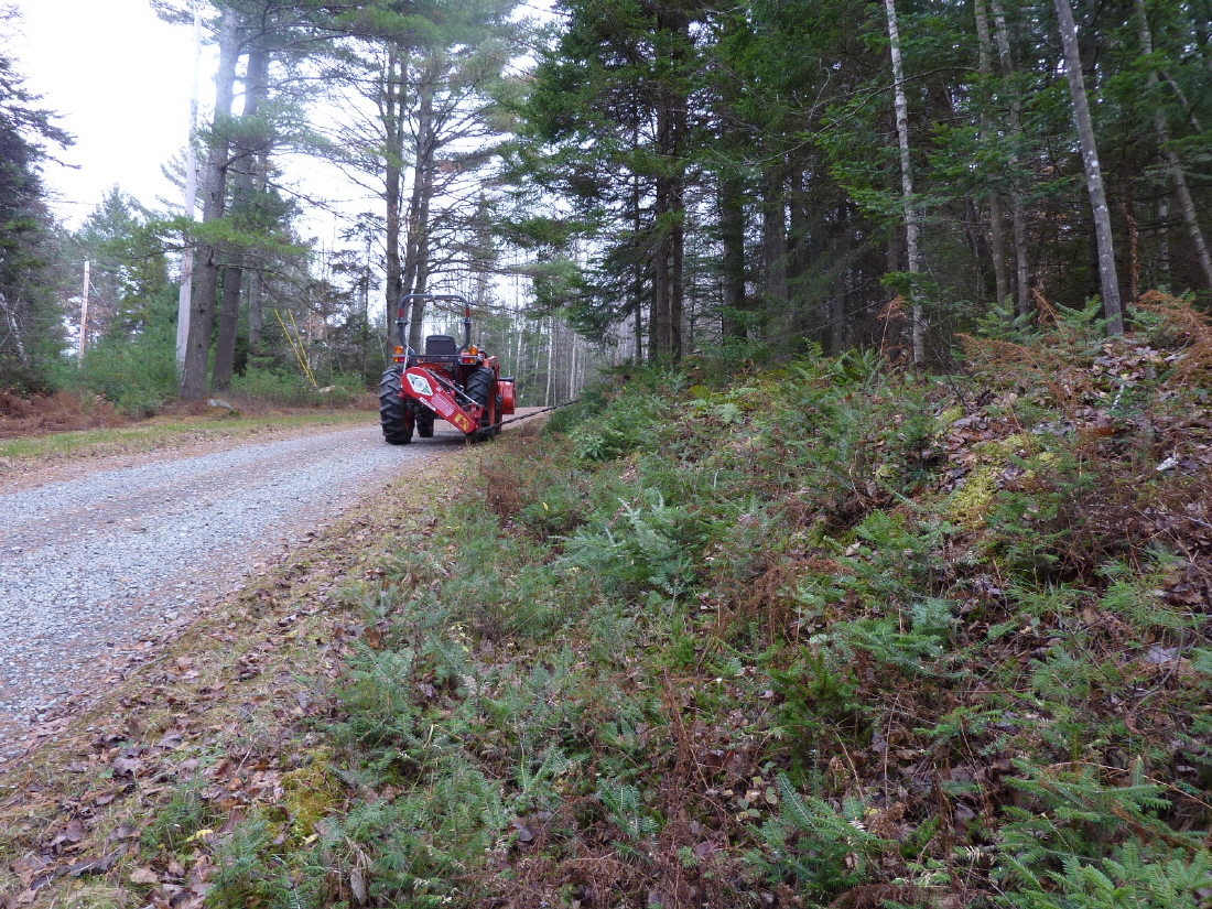

I have a Kubota M7060 tractor with a 5' bushhog that I use for clearing brush. It works very well, but there are many areas of my property where I need something offset from the tractor that can clear the brush. Example, fence lines where there is a lot of overhanging brush. I also have buried creeks, in the fields, which are a major hazard. Huge sinkholes can open up so I just can't drive a tractor in those areas. I'm considering a sickle bar, but wanted to see if more experienced folks had any recommendations. Help!

Hardee makes a good side brush hog, our hunting club has one for cutting canal banks and cutting back limbs

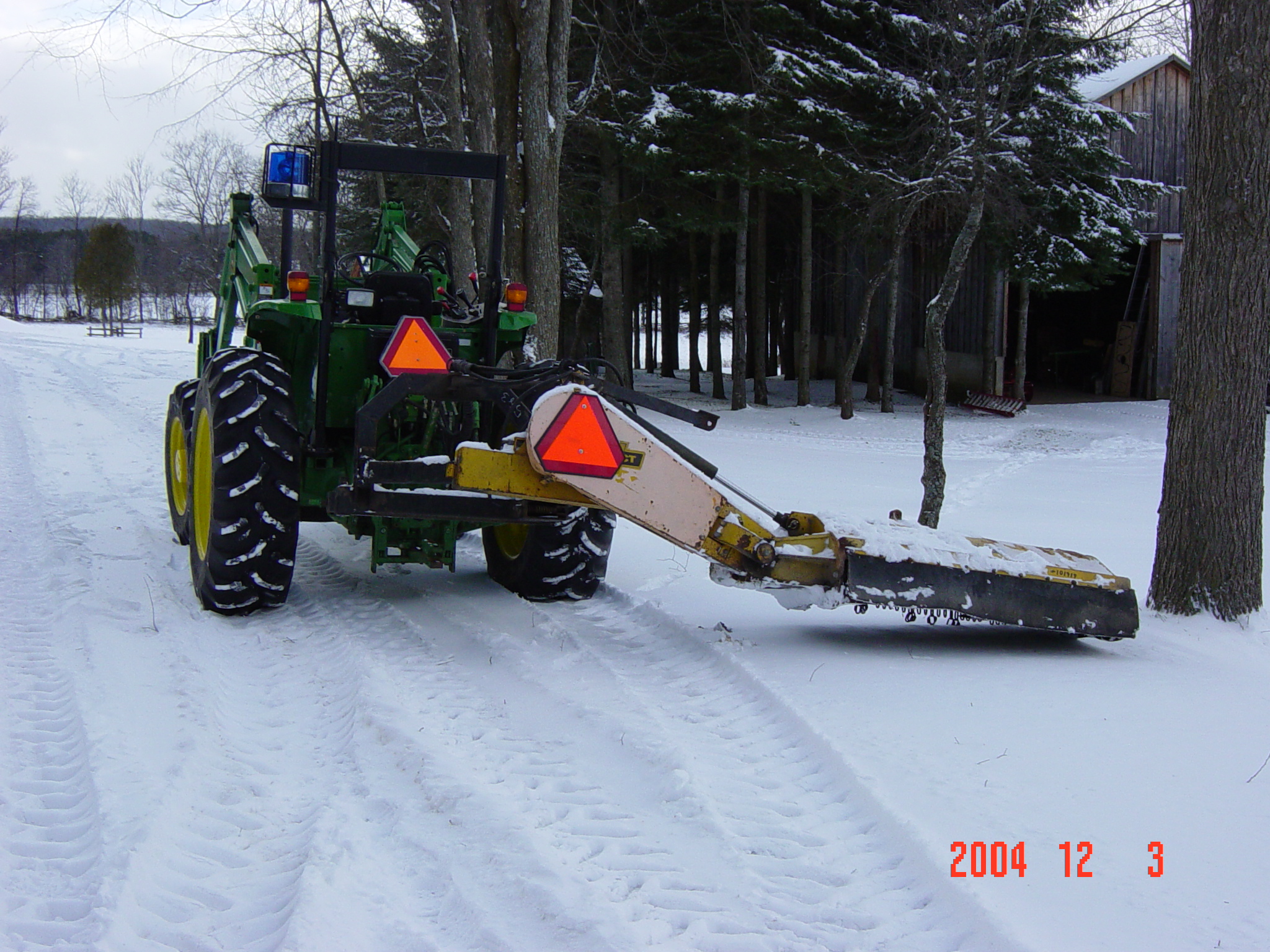

   / Off-set Brush Cutting #5
   / Off-set Brush Cutting #6
Kind of an odd picture in the winter, but I had just got this and wanted to try it.
It has heavy hammers and will pulverize 3" brush but also cut grass amazingly well. Stones lay a real hurtin on the knives
It's a PERFECT by Van Wammel in Holland, but there is an almost identical machine out there
A hydro would be much nicer to maneuver it.

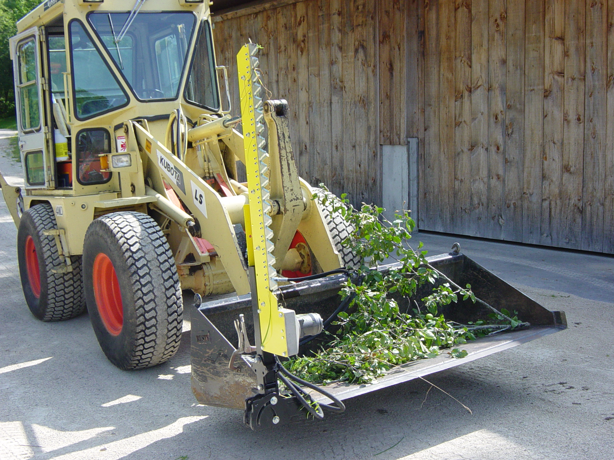

Oh, then there's this hydraulic sickle, I got last year. First time out, fifteen minutes later all the knives were badly damaged!
   / Off-set Brush Cutting #8
Okay, what damaged the knives? I am in the market for small tractor ditch bank cutter and this is one I thought on. Have about same size and heavier tractor then the OP is using to use full size boom mower but need small tractor for use in normal trim type work. Too old for hand held trimmer.
I grew up in the '50s mowing hayfields with a sickle bar mower in Pennsylvania. Any rocks/pebbles/dirt mounds will tear up or damage the knives. The knives are riveted on the bar so it takes time to change them once they are messed up, and constantly need to be sharpened anyway. They will not cut brush of any size without damage to the knives.
