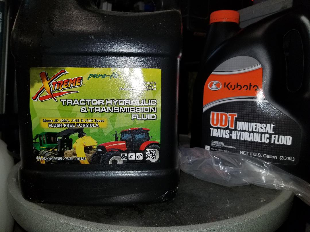

I'm with you on the so called OEM fluid.
Let us know how you like the Mobil 424 fluid after you've had a few hours of run time.
Went to NAPA and ordered 10 gallons of full synthetic. (Coastal) Did not retail in smaller containers so went to local bota dealer and got a gallon in case it needed topping off. But 10 gallons was dead center of indicator.
Now the machine starts up and there is no hyd surge and loud whining noise.
The range shift selector is a whole lot smoother, etc. no down side for sure.
Slowly learning about dealers. I do not see Kioti dealers using a vendor specific Hyd fluid but rather whatever a good salesman talked them into using.
Not knowing what is the OEM fill I sure did not want anymore of that stuff. Loud whining, had to always jiggle lever and a pedal to engage a range etc. it was very irritating.
Well drifting off topic maybe. Keep us updated.
Regards....
OEM-oil.jpg Is this the fluid your dealer retails?
