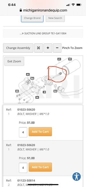

Is this a check valve that goes into the filter? It is not listed separately. Did you notice this gizmo when you change the filter?

K5lwq, that's a magnetic pickup. I cleaned it off (nothing really of interest found); nothing else is supposed to be done with it that I am aware of.
