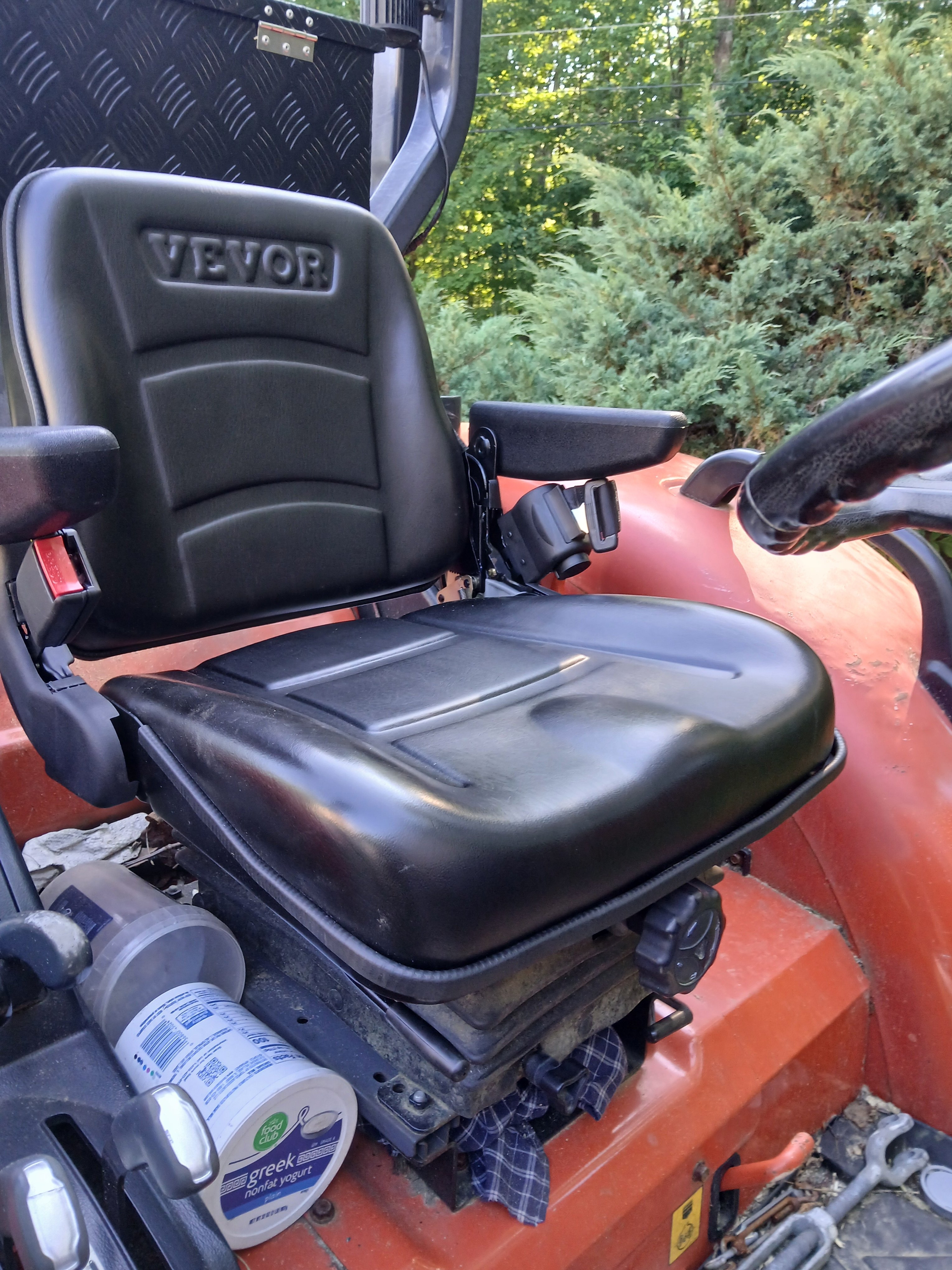

If you ever price a new seat cushion for your Kioti tractor you will cringe. New Kioti cushions are over $600. I replaced my bottom cushion 2 years ago. It already has cracked in several places. This time around I said screw it and bought a folding seat with armrests from Vevor for $120 shipped. The mounting brackets are adjustable on the width and plenty of holes front to back. It also has armrests and a seatbelt. Plus the backrest is adjustable. The seat is adjustable and can be slid off the tracks to remove it. I can buy 5 of these seats for the replacement costs of one set of Kioti cushions.

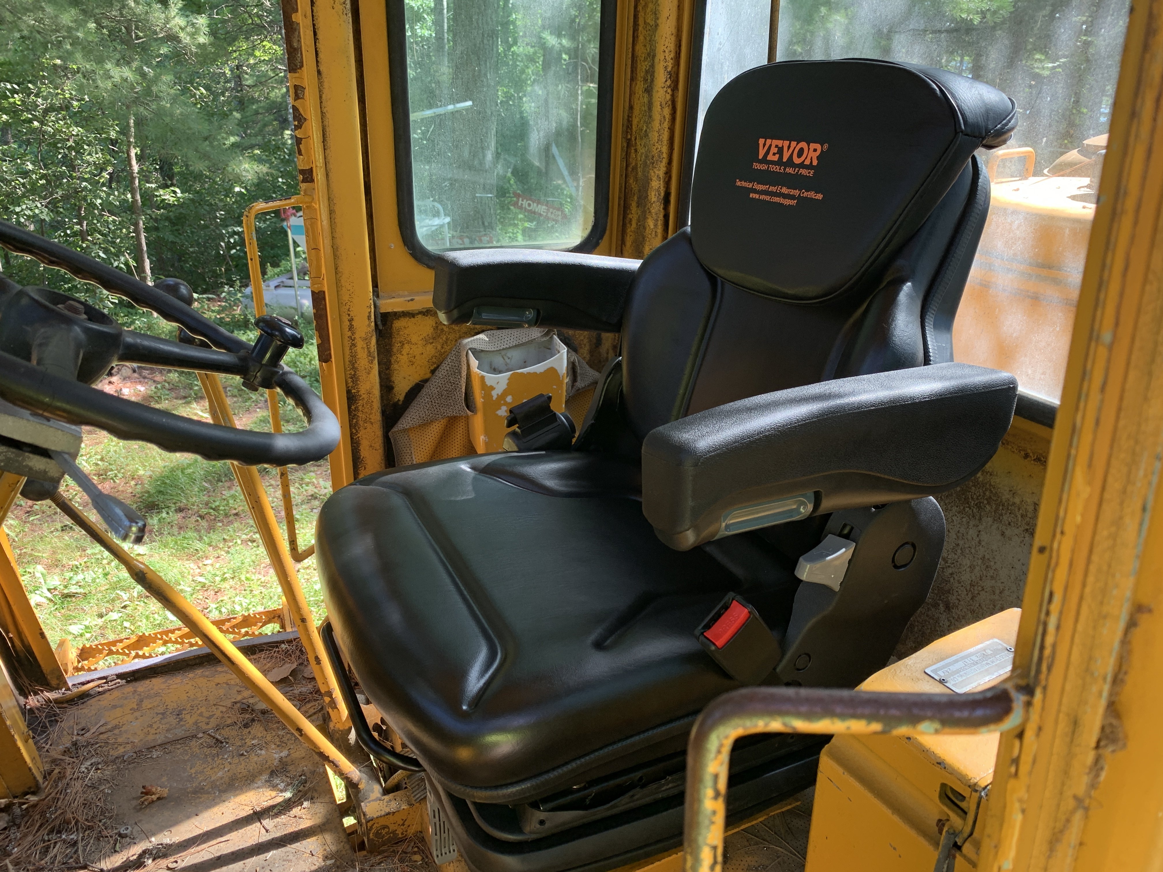

Last year, I replaced the worn-out seat in my Hough Payloader with this Vevor suspension seat that looks something like a much cheaper knock-off of a Grammer MSG65 suspension seat. From my experience, this same Vevor seat should (should, but I don't know for certain) be able to fit into an NX cab. That said, I suggest that a guy measure the stock seat height and compare it to the Vevor seat.
