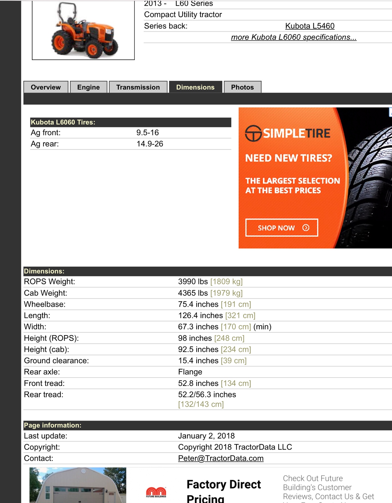

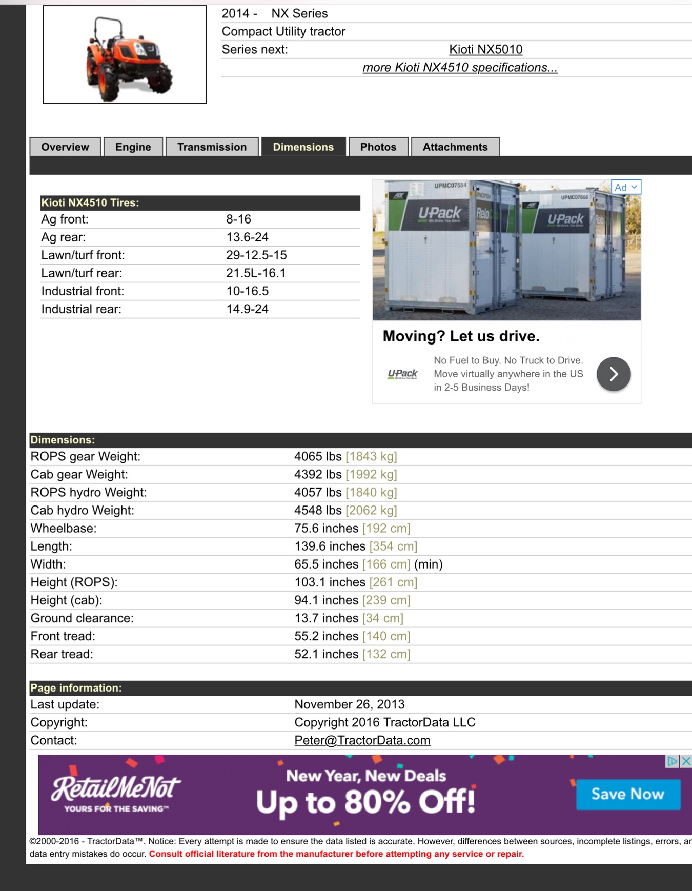

Here are same basic dimensions of both tractors, might give you a basic idea of size differences.

In my opinion if the only question you have regarding upgrading to a L6060 is the dimensions, then it probably isnt worth the cost.
These are essentially the same class size of machine.

Based on the specs I would say the difference is negligible.
