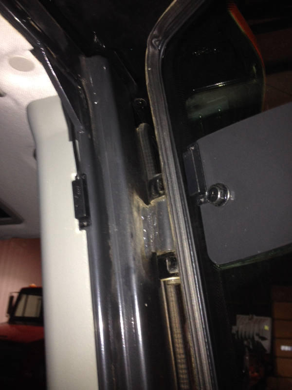

Well I decided that it would be nice to have the dome light to also work as a courtesy light when you open the cab door. I wired in a small magnetic reed type switch to the dome light, so now when the left door is opened the dome light will come on. Works really well getting in and out of the cab in the dark. I soldered the switch wires onto the dome light itself after the factory switch, this allows the dome light switch to operate normal for manually turning it on and off, as of now the light is on anytime the door is open so if I find later that I need the light off which the door open for some reason I'll install a new three position switch in place of the factory single position. The door switch is very small and comes with double sided tape on both pieces and also screw holes on both for mounting with screws, I chose to use the tape and seems to be working well.

Very cool.

Did you glue the switch on?

I used the double sided tape that came on the switch halves.
