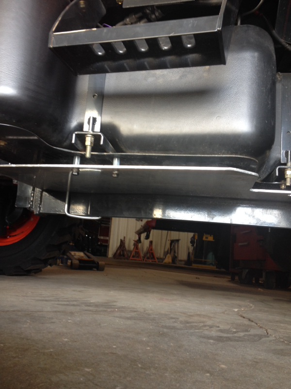

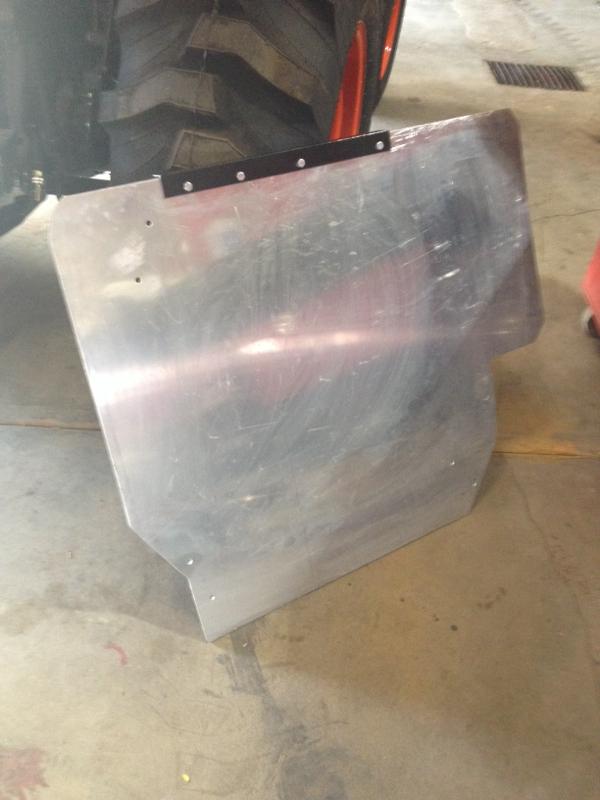

I decided to make a real fast simple belly pan for my NX 5510 , main concern was the fuel line and outlet on the bottom of the tank. I could have just cut enough to cover just that area but decided for now to make it cover from side to side. The loader braces that run under the tractor to the rear on a NX have the left side lower than the right side due to the fuel tank, so I let the left side set on top of the loader brace while the right side stayed below. I secured it with four large U-bolts one on each corner around the loader braces, also I removed two of the tank skid plate nuts and installed thread couplers to thread two bolts in to give a bit more support to the part under the tank.

CB, what material did you use for the belly pan? Looks like it might be 5/16" thick! Did you make a template, e.g., out of cardboard, to ensure accurate cutting and drilling? Looks very professional. But, then, I'm rapidly coming to the conclusion that you are a professional. :thumbsup:

I used 3/16 thick aluminum plate , I was going to use some 1/4" I have until I remembered having this piece. I just took some basic measurements and started with a square then trimmed it down to my final size. Once I got it close I put it in place and held it up with a floor jack, then used a black sharpe to mark any final trimming and holes for the u bolts.
