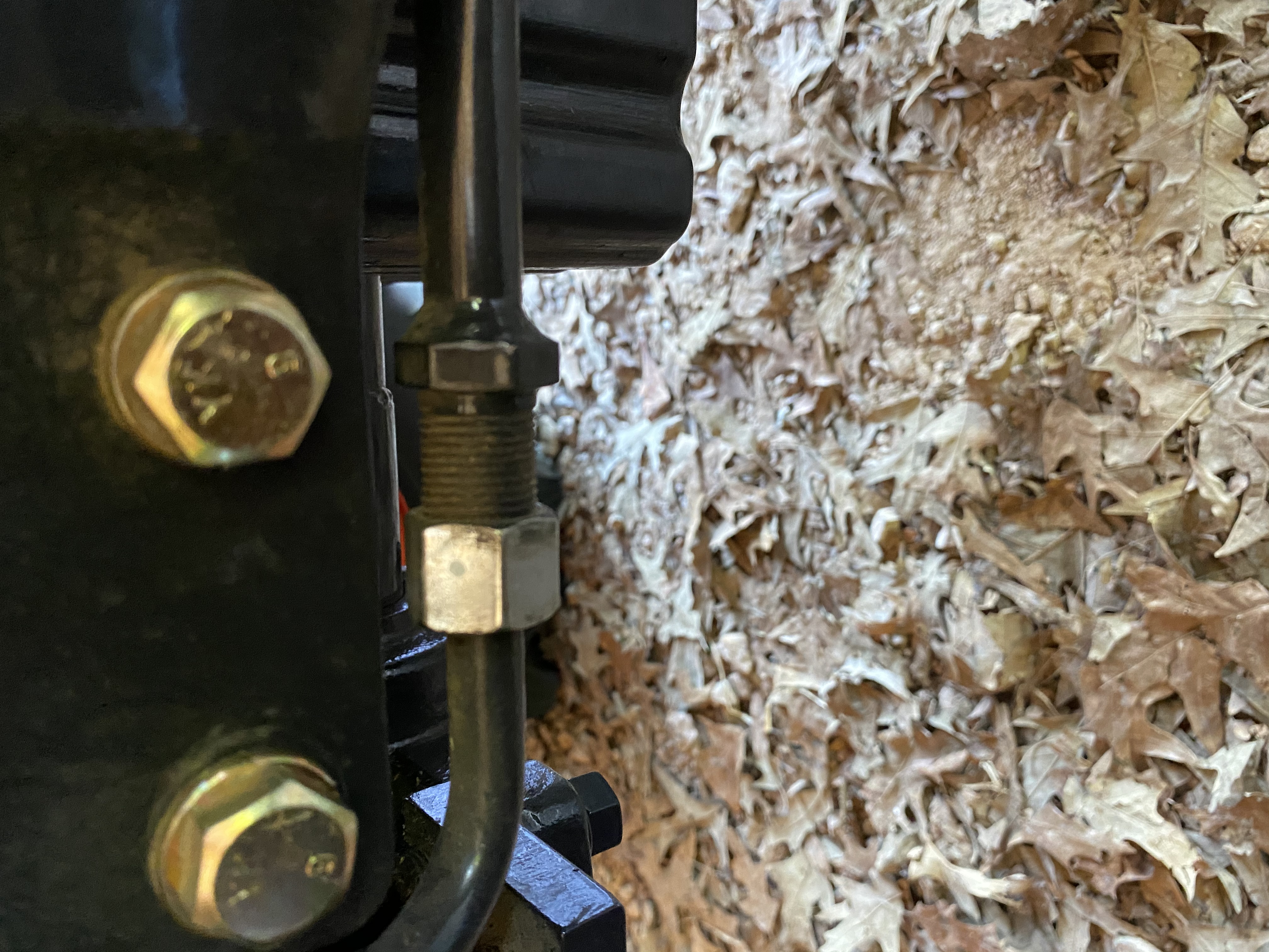

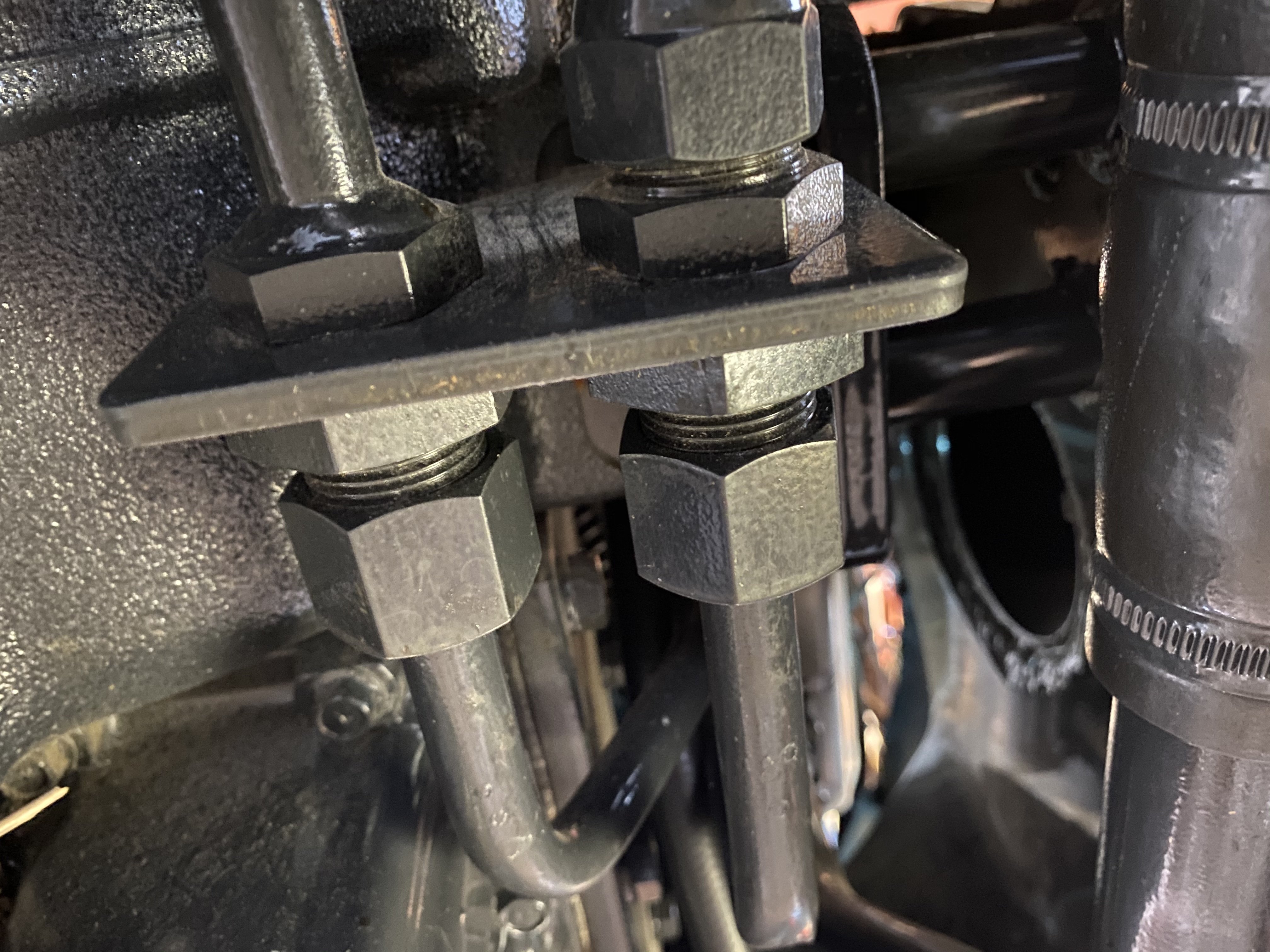

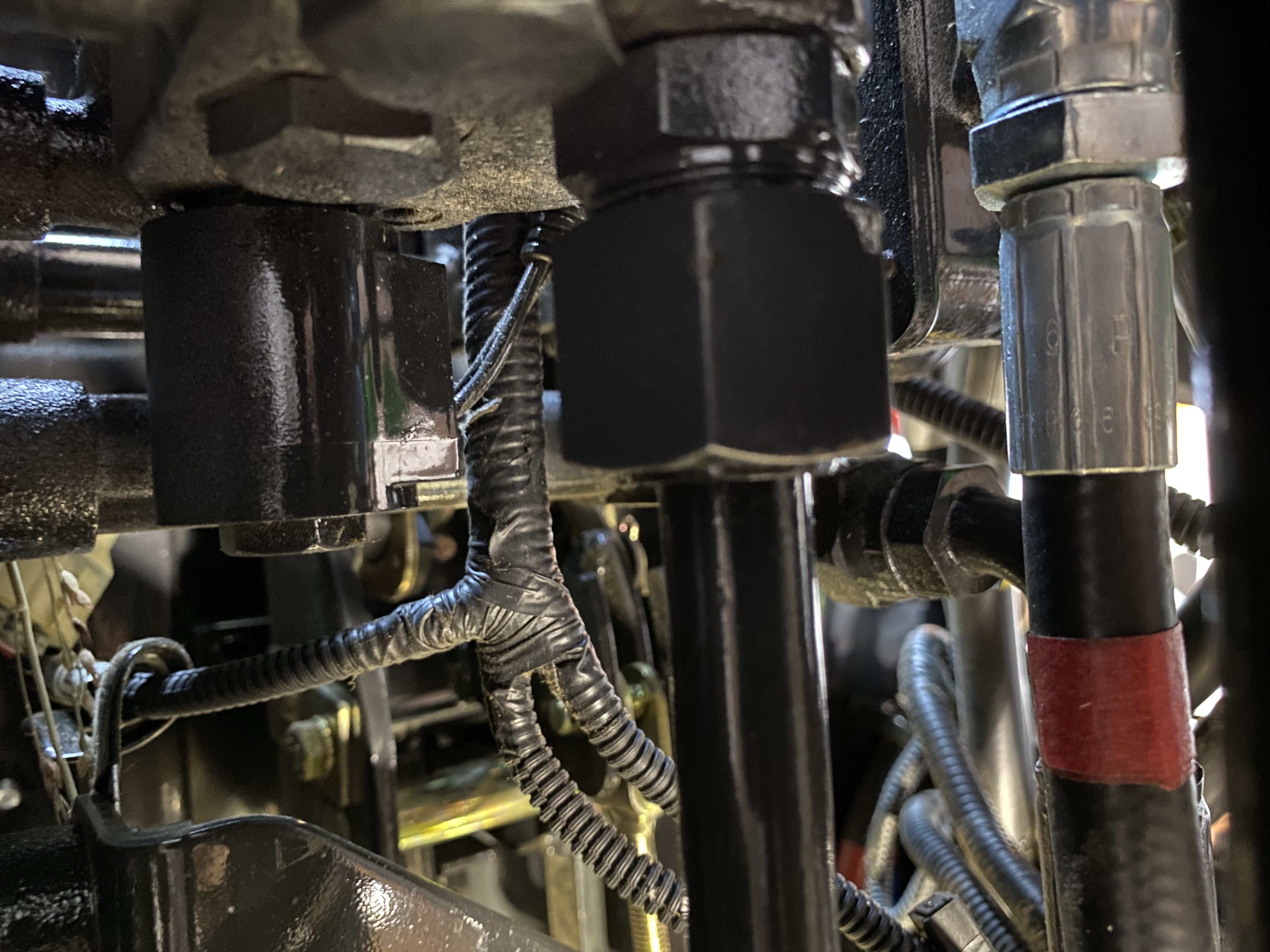

   / NX 5010HST Cab reverse intermittent and jerky #33
2DCB8E0A-CA67-4323-8793-85643B478EAA.jpeg48A46A21-0753-4CDE-904D-93316B58D2A3.jpeg848FDAAA-EFE1-4A19-98DD-80D078771489.jpeg
Hard line into modulate valve larger than the 3/8 coming out. Shows both hardliners out of pump the same size. Hard line that drops down from cooler to below the alternator hooks up to a larger diameter hard line that goes into the hst filter.
