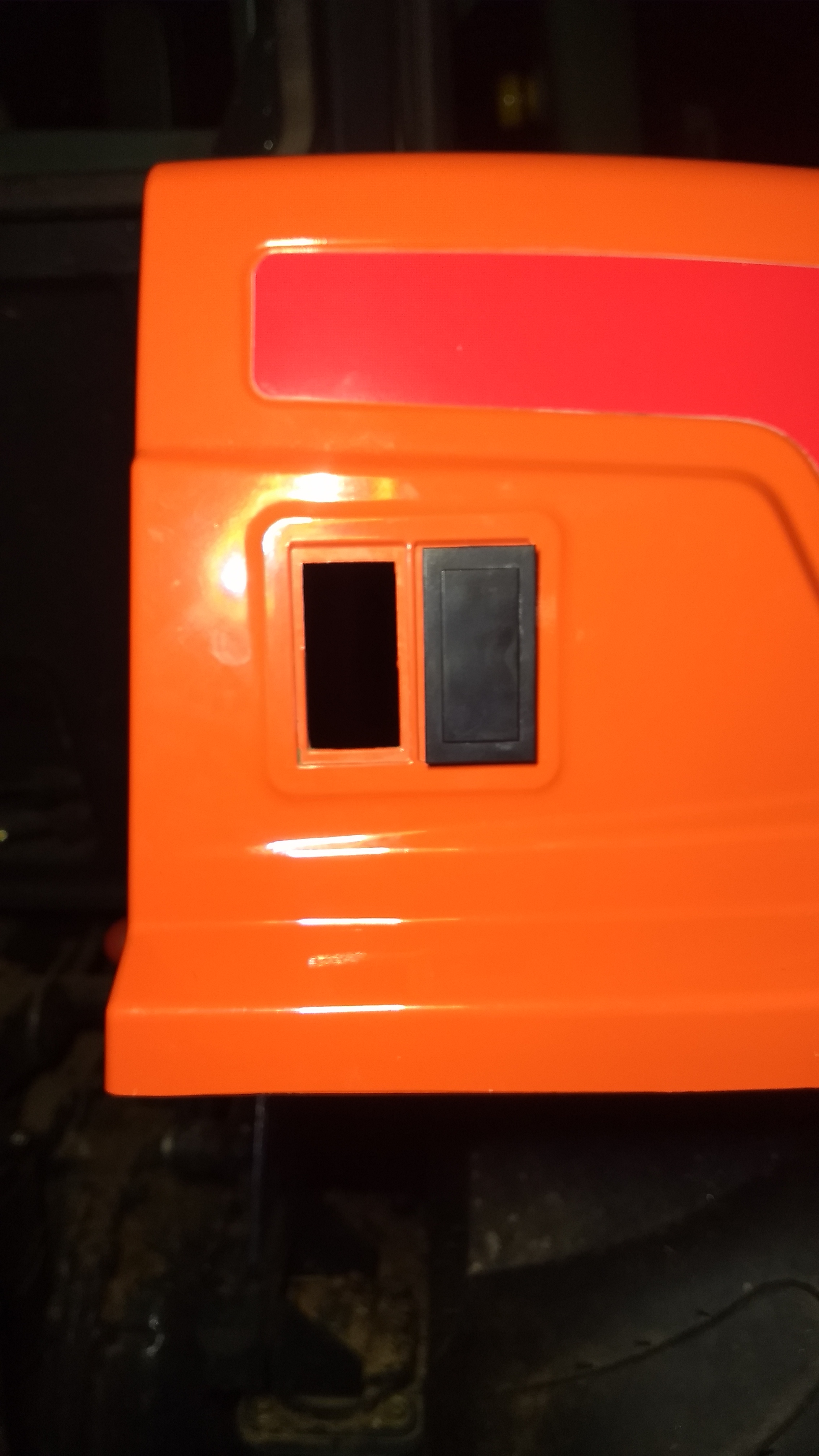

I am new to the forum although I received advice from here for many years. I have a new Kioti NX4510 It is suppose to be the newest model with upgraded seat and fuel tank protector housing and things I haven't discovered yet. On the Right rear fender there is a plastic housing for two square light switches and wiring in a box behind it. The left fender has the indents in the same location but not the plastic cover or wires. Does anyone know what these are to be used for. I am thinking I could mount light switches for working lights but I would rather have the switch within reach of the seat for that. Thank You in Advance for any help here.

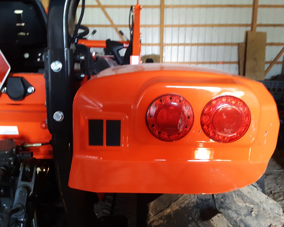

My NX5010 Cab has the rear lights mounted above the fender, but it has the same rectangular knockouts as your photo shows. There is no box or wiring behind / under the fender. I have also wondered what option these might be for.

For the cab version of the NX (at least my 5010C), there is a mechanical rear remote lift arm lever that is connected to the in cab lever. It still has the two knockouts on the right fender per the OP's photo. I guess rear PTO is a possibility, although the PTO knob in cab (big yellow twist and press style) is large enough to cover both knockouts.

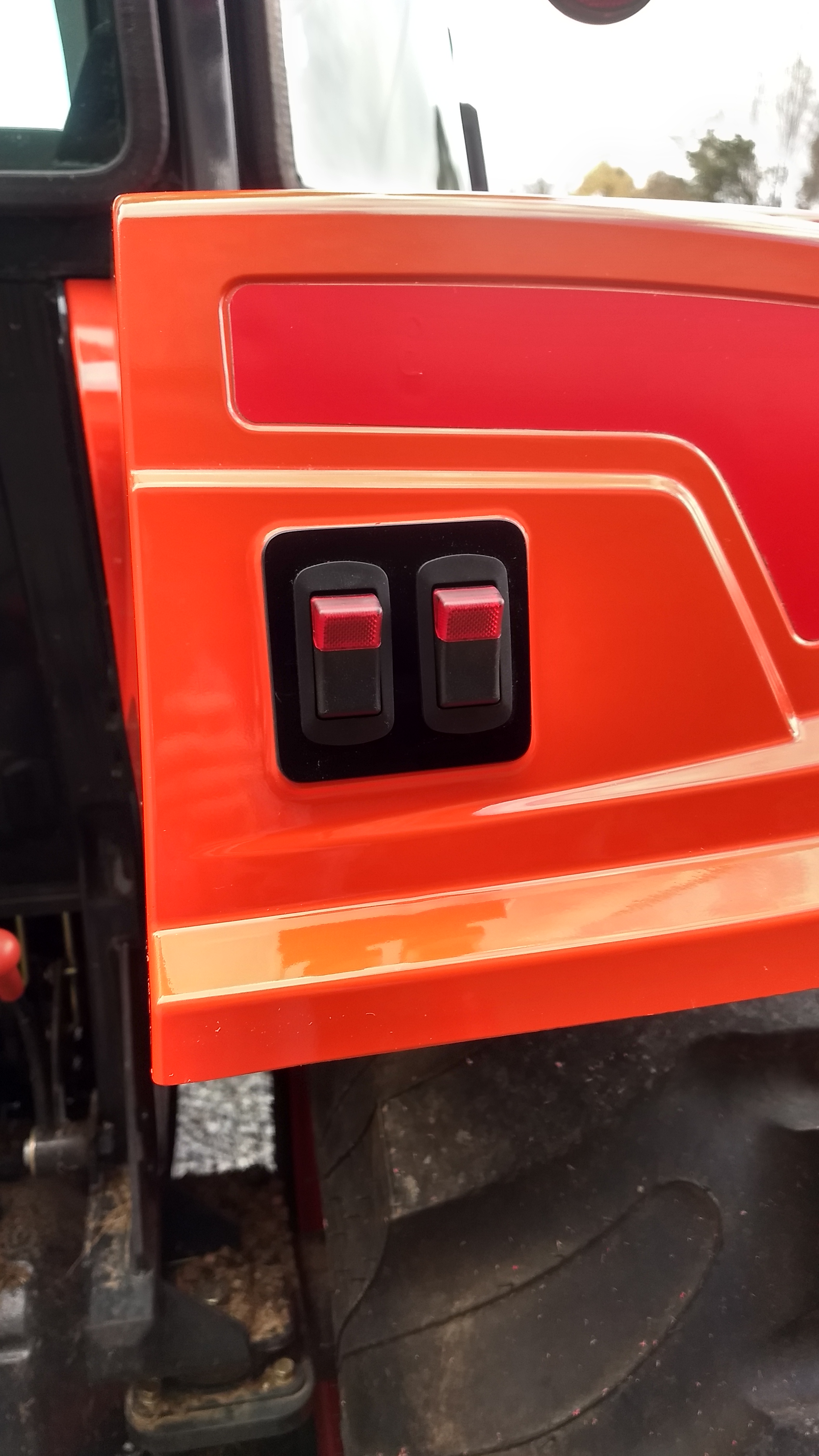

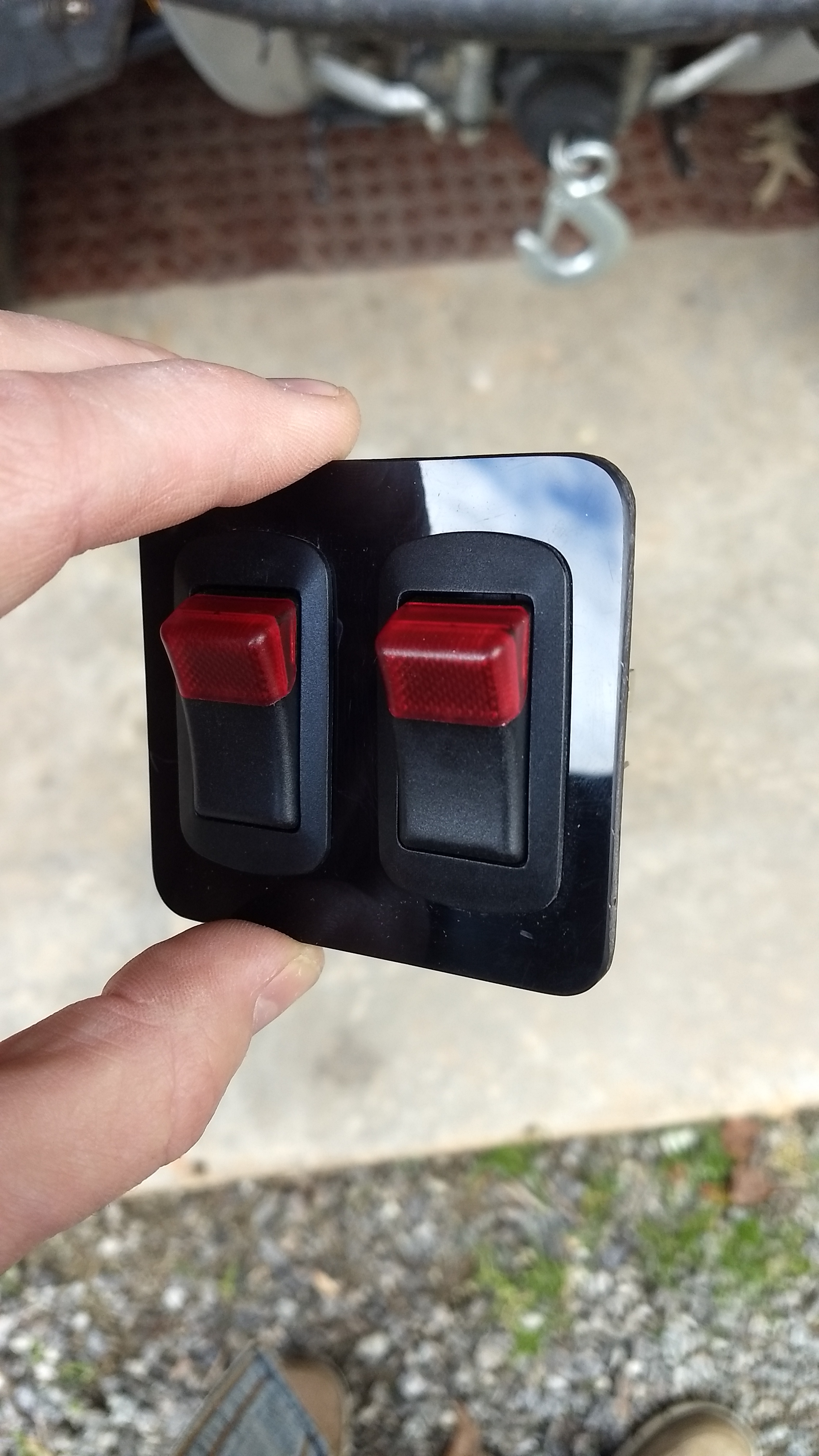

I installed two waterproof switches I bought online. I had to make a new mount plate (black acrylic from Amazon) because I couldn't find anything to fit the existing holes that WERE waterproof.
I have installed two light pods below (I don't have a pic of those, but will try to add tonight) that run from one of the switches to ease hook up of attachments. The upper floods on cab don't illuminate this area much-they do more out behind the tractor.
The other switch doesn't have a function..... yet.
IMG_20181103_191524664.jpg IMG_20181104_145610359.jpg IMG_20181104_145640887_HDR.jpg
Link for the switches... NTE Electronics 54-231W Waterproof Miniature Illuminated Rocker Switch, SPST Circuit, ON-None-Off Action, PC Red Led Actuator, .25" Quick Connect Terminal, 21 Amp, 14 VDC: Wall Light Switches: Amazon.com: Industrial & Scientific

Good look to that mod! I may pick some of those up for a future project - thanks. :drink:
