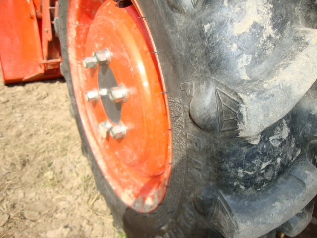

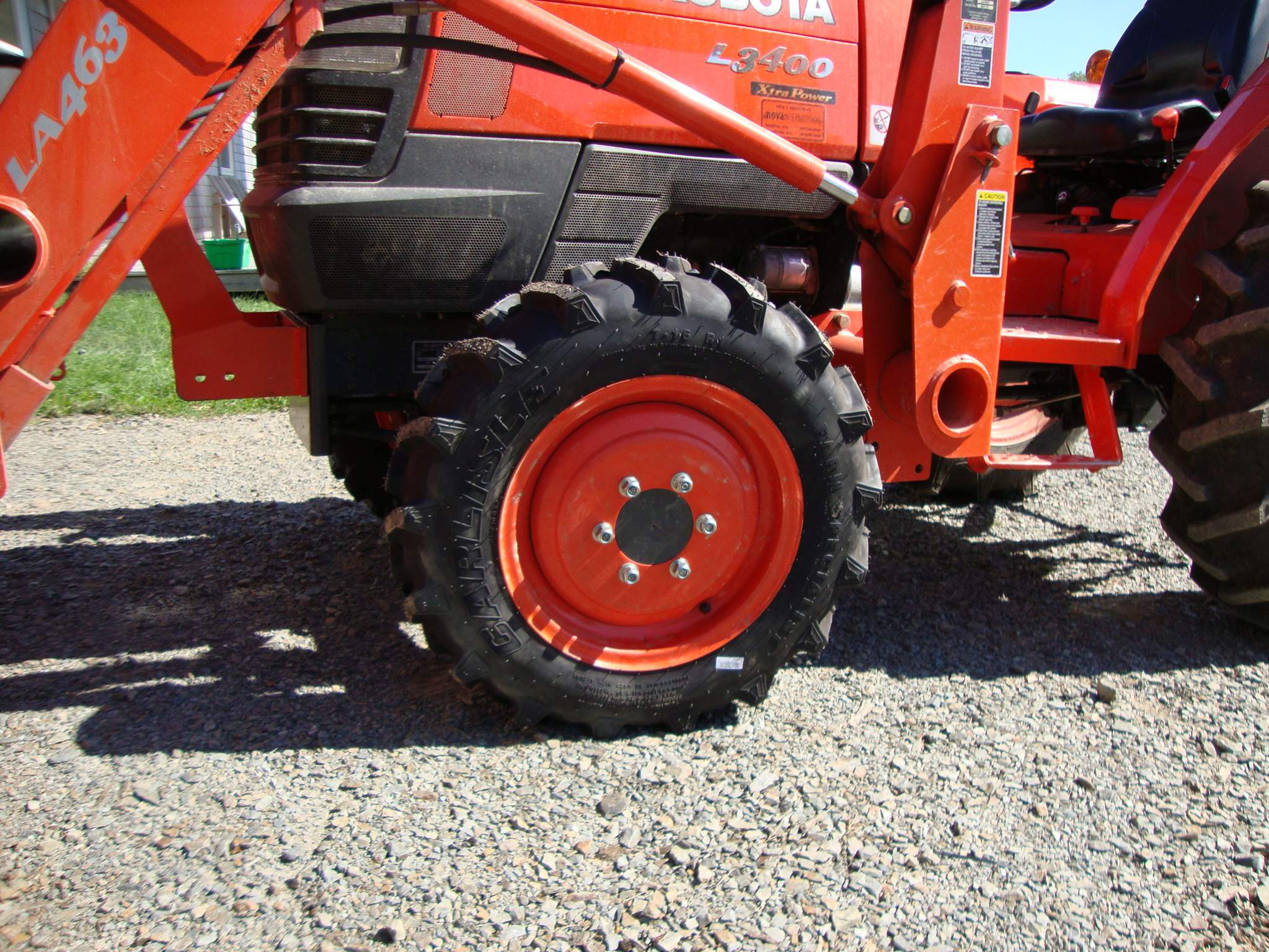

Just a thought.. the front wheels on my L3400 don't have tapered holes, so the nuts are turned around so the flat end of the nut is toward the rim, and there's a lockwasher under the nuts. If you had the tapered end of the nut facing a flat hole I think it would rapidly wear into the steel rim due to the small contact area.
You should be able to see what I'm talking about in the attached picture.
Your rim MAY have had tapered holes and the nuts just came loose, too.
Sean
