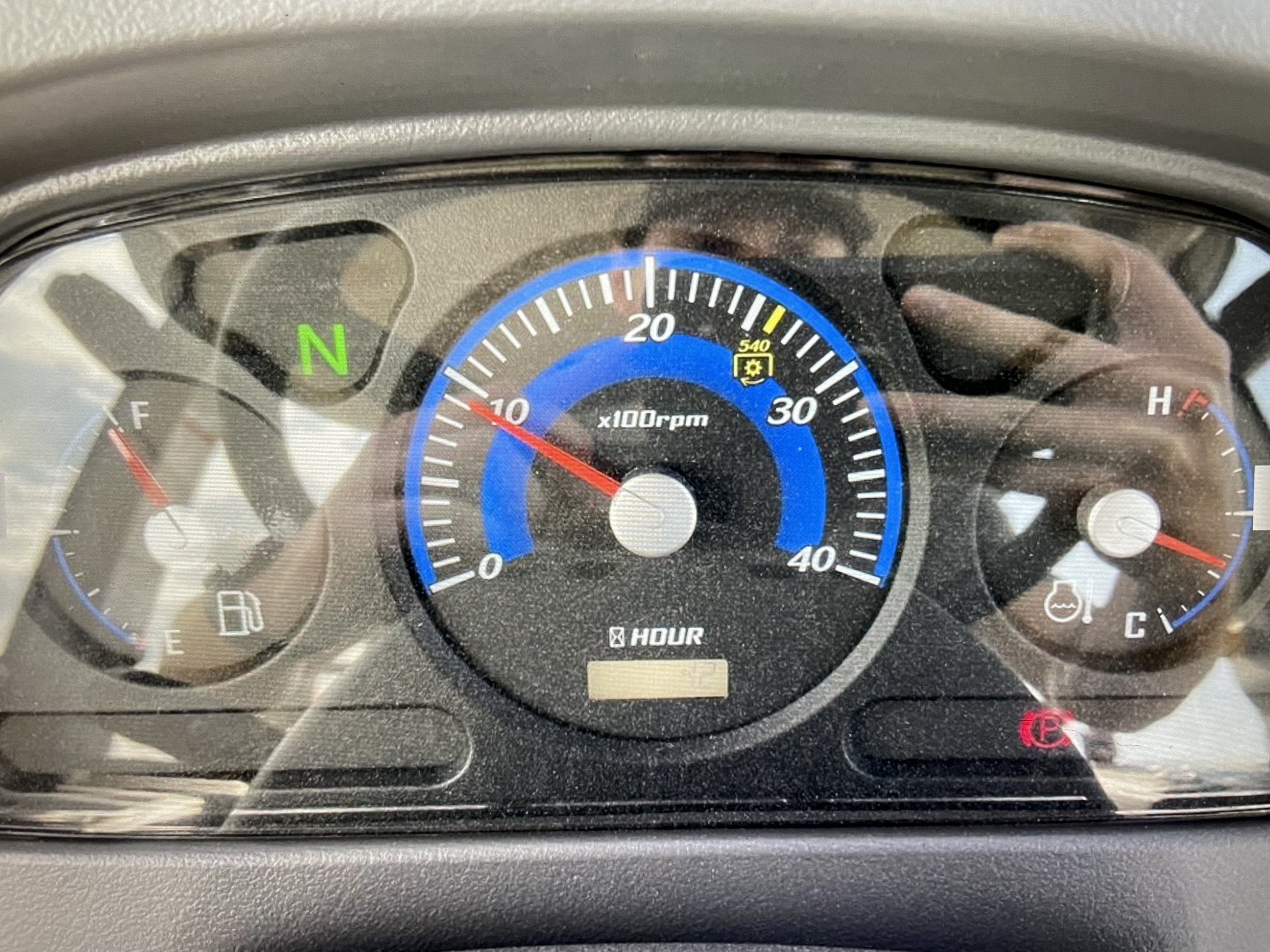

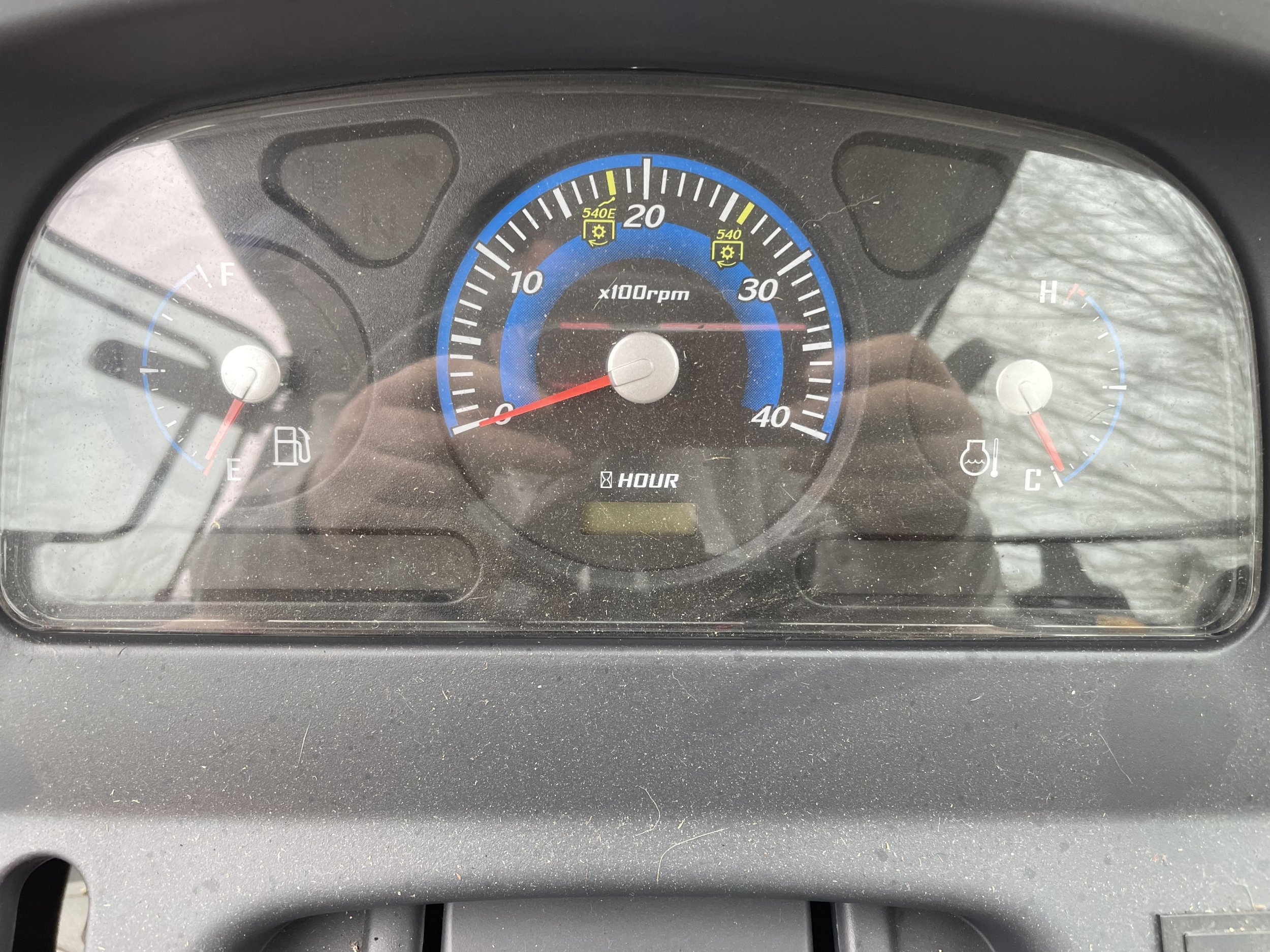

I didn’t see anything about this in my owners manual, however, the DK does have an indicator at the 1800 mark. Now that I’ve looked, I am surprised they use 2 different meters. I run mine at and above 1800 and no I am not a believer of the e-pto. IMO, pto powered is at full pto speed, not a guessing game on torque curves.

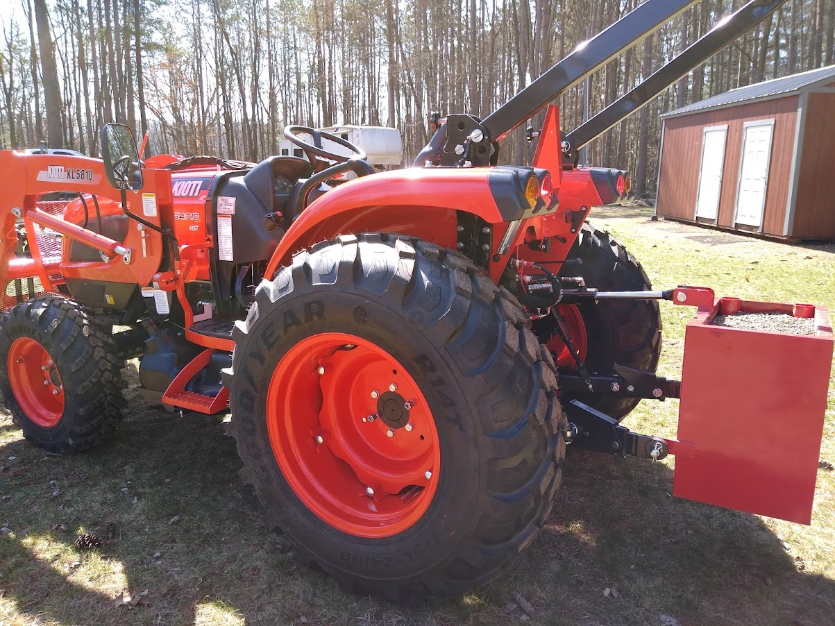

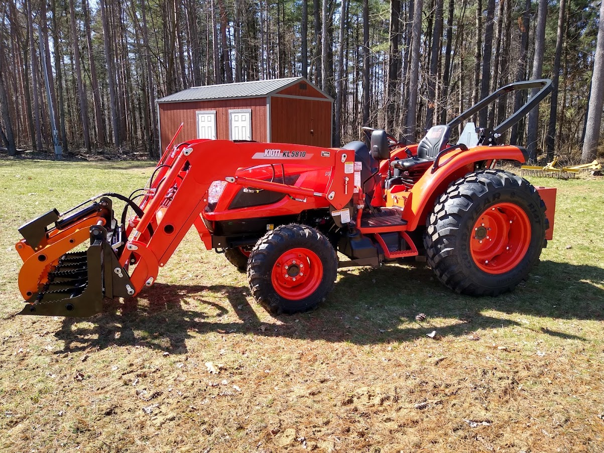

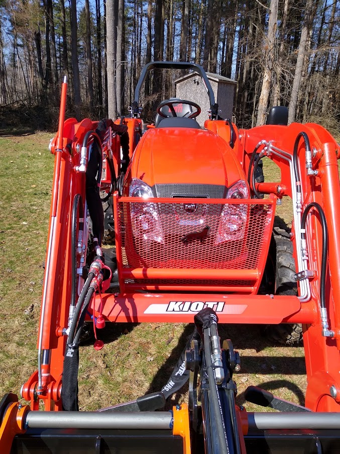

Just got back from getting my new NS4710H setup. Added my canopy, made it hinged so I could collapse it down then angle ROP down and get into my 8 ft opening. Put lights on front and back of ROP, wired in electrical for my 12k winch on the rear, new larger tool box, aluminum scabbard mounted for chainsaw. So far so good. Extras I had dealer do is hydraulic top link, 3rd function kit and they welded in a wire brush guard and one of their in house made 60" grapples.
