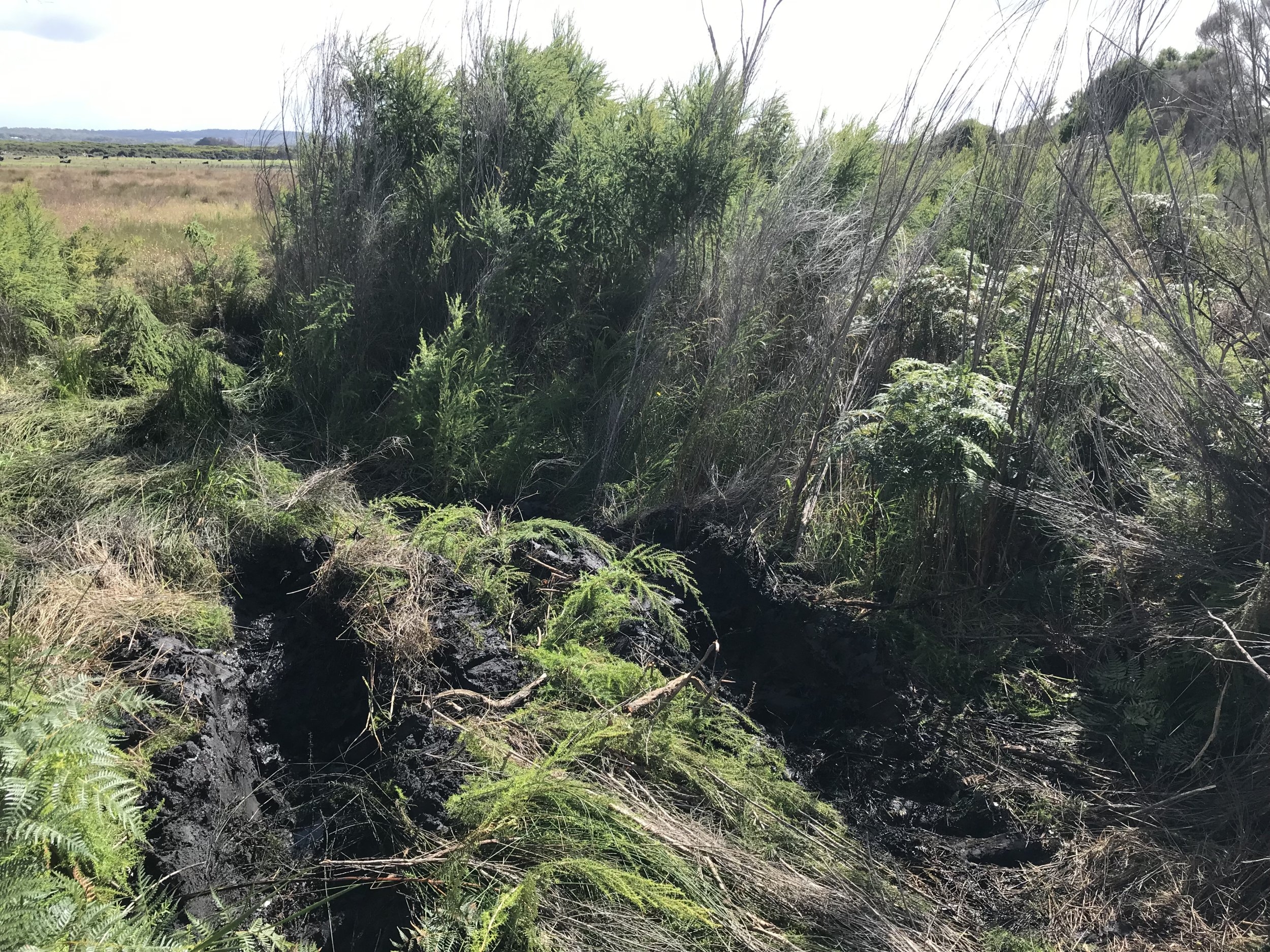

Well, I pushed it a little too far. May have to hire a dozier.
Although if I could walk I'd use chains and trees with the loader to get the tractor out.
At this point I have the shredder disconnected. If and when I get the tractor out I will then worry bout getting the shredder out.
I need to put out a round bale of hay out tomorrow. I guess I'll have to ask for a favor from a neighbor.
Get a long chain, wrap it thru the back wheel and then to a tree behind the tractor. Wrap the chain to the bottom of the wheel so that when put in reverse, it pulls the tractor out. Understand? When put in reverse, the chain will pull the tractor backwards. Might have to experiment with the placement of the chain (top, bottom, etc) on the wheel to make sure it pulls the chain when the tractor is put in reverse. This has got me out of some serious holes that could not be pulled out by another tractor.
