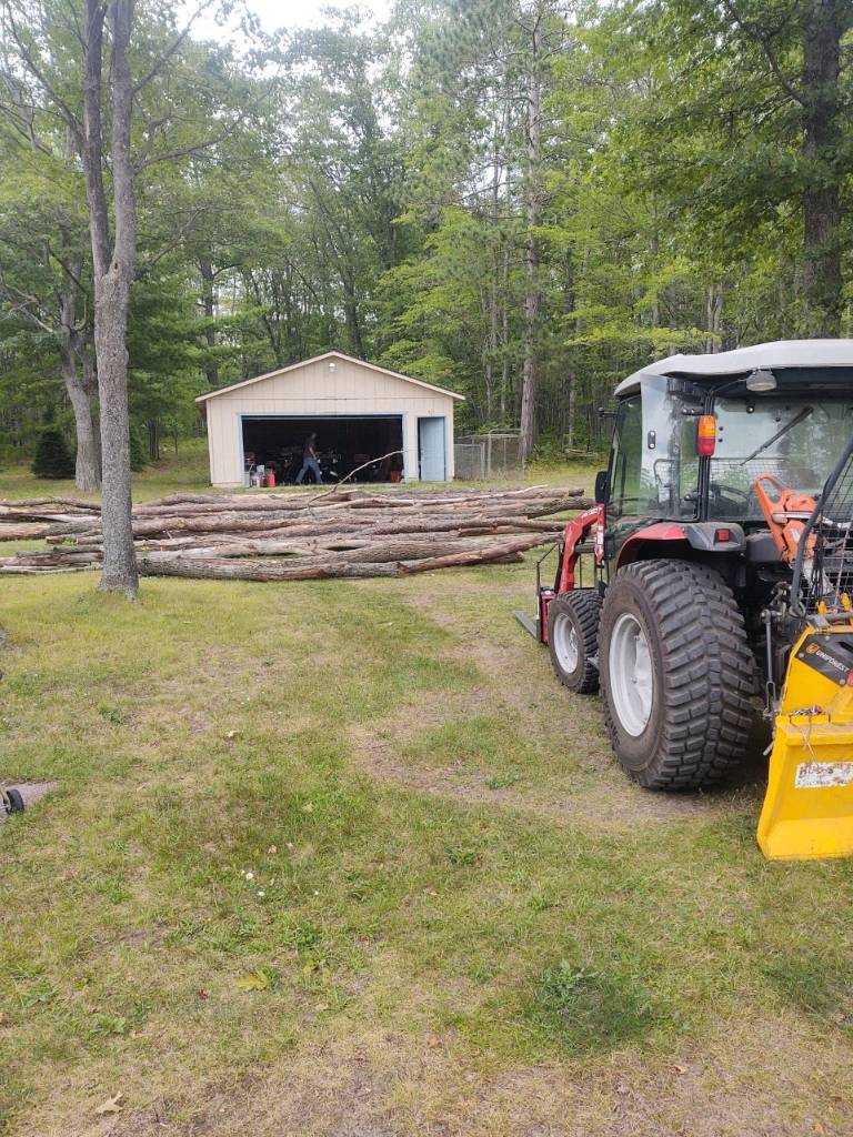

For anyone considering tire options, I can't say enough good things about the Yokomaha alliance 550s. For the life of me I cannot understand why r4s are the default all purpose tire.
I switched from galaxy r4s to them and after 40 hours, I'm blown away by their performance. They don't tear up grass with anything but a full lock turn with some speed either. Dragging logs, I'll stall the 40hp tractor before spinning tires. With the r4's, I'd spin and barely bog down.

What sizes are your Yokomaha alliance 550s?
Do they ride better?
Can't say exactly how much different they ride as the r4s were not filled and these are, so it's not exactly a fair comparison. It still rides like a tractor with no suspension off road if you hit a big rut you didn't see, but is very smooth at full speed going down the road.
Sizes im running are 265/70-16.5 and 460/70-24.
