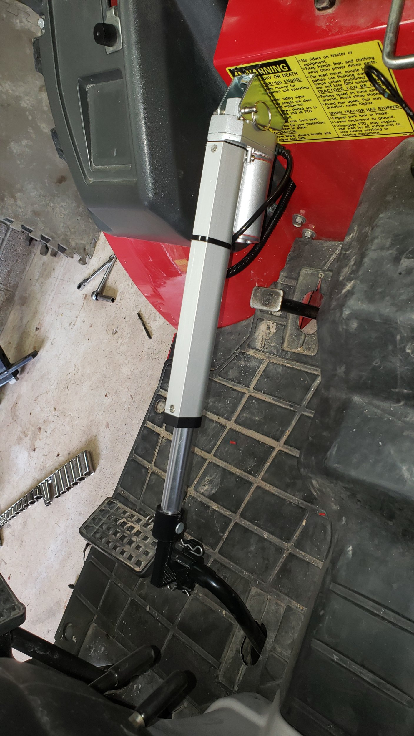

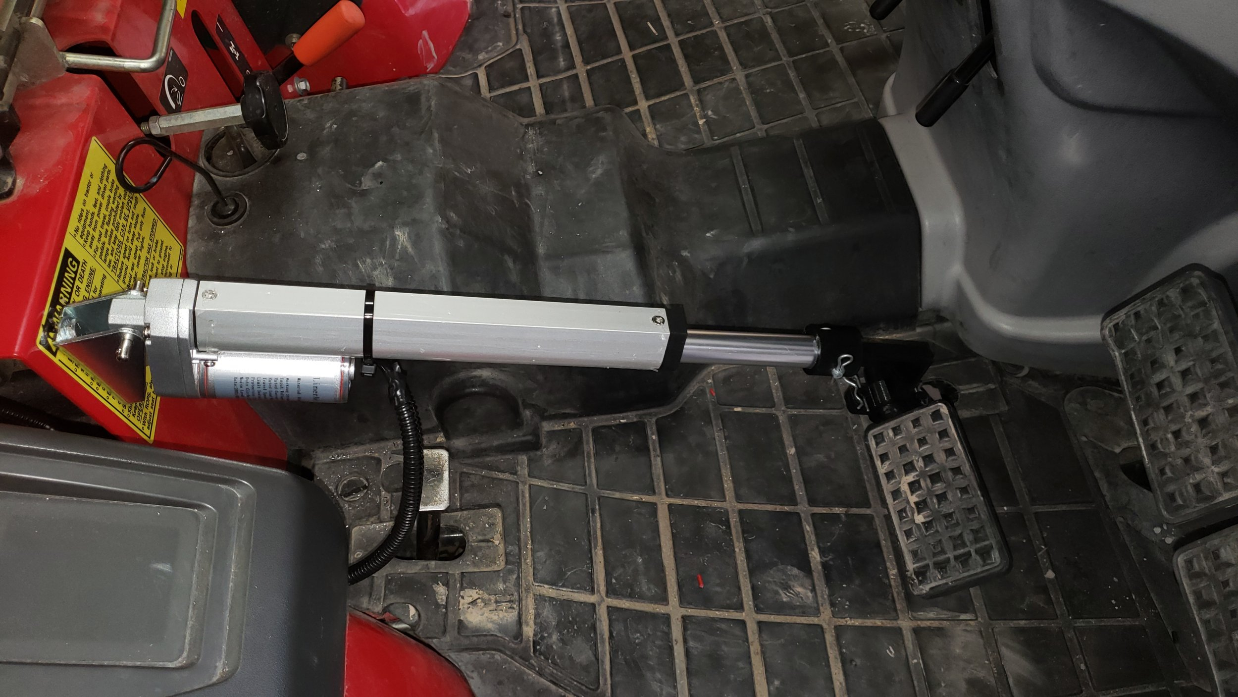

Some of you may remember my complaining about not being able to move the tractor with the seat reversed, while using the backhoe. I thought this was crazy, as who just sits in one place and digs (guess I need to dig ditches). After trying a stick for about an hour i said screw it and designed something. my HST is crazy hard to push with a stick.
So now I give you push button direction control. Linear actuator, to a momentary switch, and some 3d printed parts to attach it to the tractor. Did not need to cut into the factory wiring, was able to tie into the horn/light circuit, that was not in use.
actuator comes paritally off to drive somewhere else with 1 pin. completely comes off with 3 pins, less then 30 seconds to remove.

Really cool, but I also always have the brake on and bucket down. Don’t you just end up pulling/pushing yourself all over the place if you don’t have the brake on and bucket down?
   / Now able to move tractor from backhoe position. Push Button, 3D Parts, Should have come from the factory this way.
not when i lift the rear off the ground with the stab jacks. you guys must have some seriously dry stuff. I can barely do the bucket pull trick, without ripping 3 feet of ground around here.
