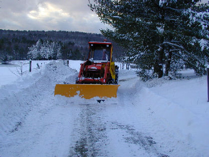

I built a blade to attach to my fel and I'm vyry happy with it. It is a seven foot blade and my 4310 handles it with no problem. I've used smaller blades and would not want anything smaller than the 7'. I think your 4210 would handle that size too. Especially on flat ground. I have a major incline on my drive.
   / Not the usual snow blade post/question
#18
Looks very nice. If you dont mind my asking what was the approx price?
Thanks
