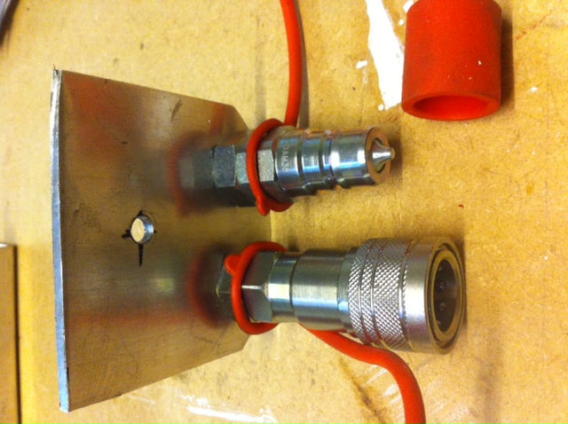

can someone help me out?
I want to mount hydraulic quick coupler outlets at the front of my FEL. I plan to use a plate attached to the crossmember with holes for the lines to go through. What kind of attachments or adapters do I need to mount the hoses to the plate and then have the quick couplers attached to them?
Thanks,
Trying to add a photo

Bulkhead fittings, as noted. Make sure you also get the nuts, or that they are included. Also make sure you allow enough space around them to get your hand on the fittings, especially with a glove on. Also, it helps to make that bracket pretty sturdy. "Things happen" and my grapple ended up hanging by the hoses on my first use...glad my bracket was 3/8" alum angle...

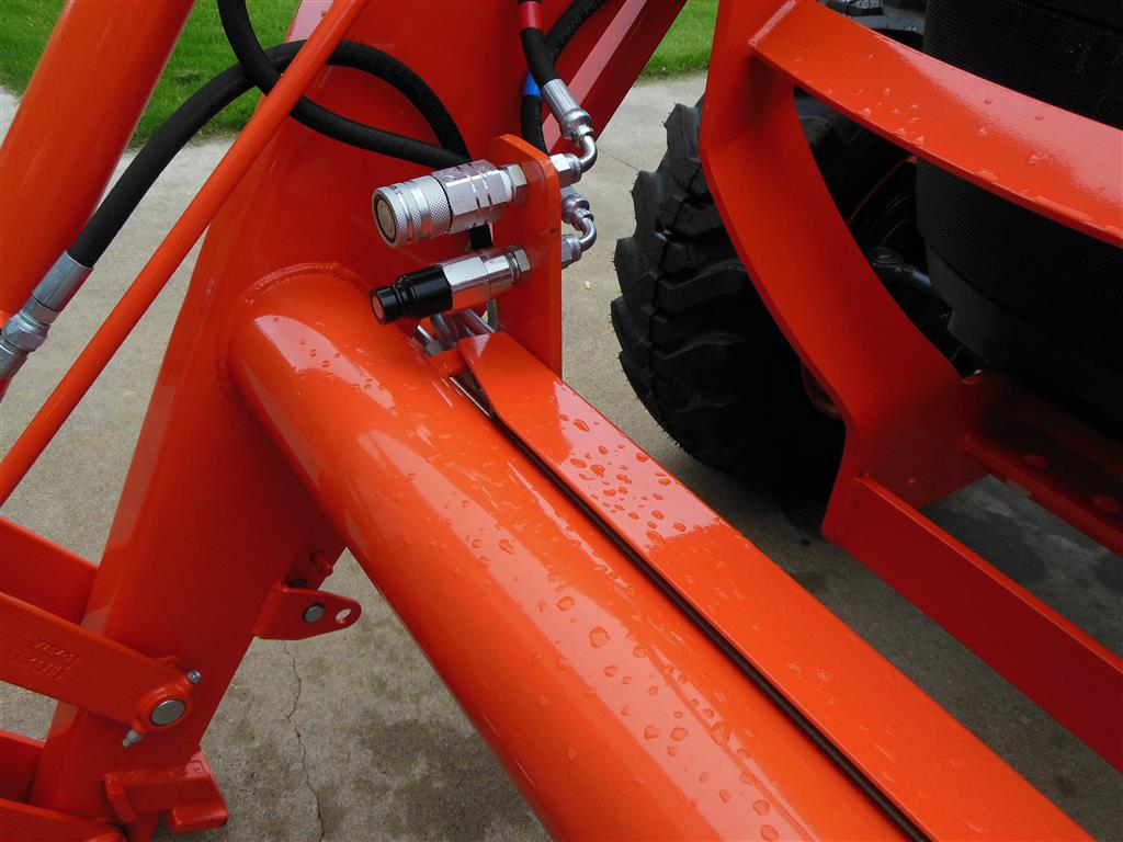

I just did this on my new tractor (3/8" steel):

Thanks for your responses.
Now if I can only find a 1/2" NPT Male to female

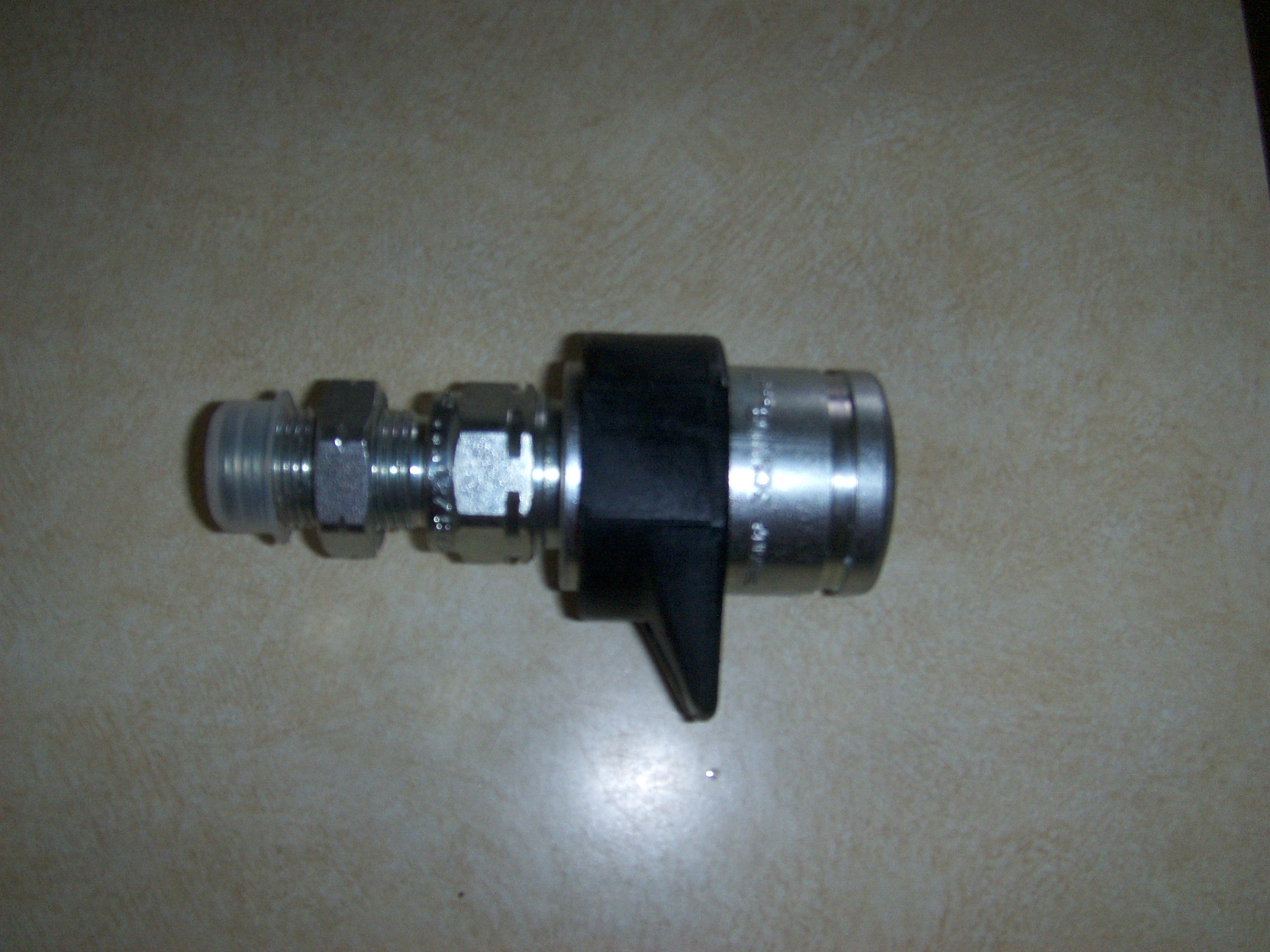

John Deere has QC with a built in bulkhead fitting. This one is for a mid mount loader
