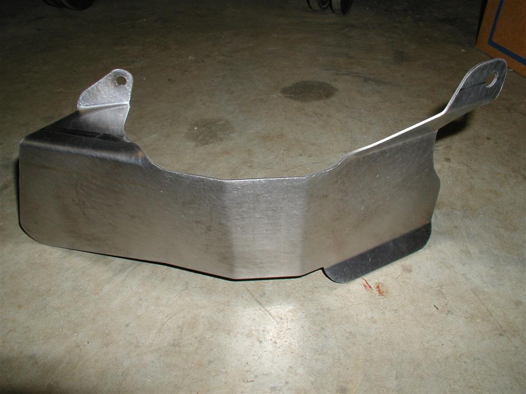

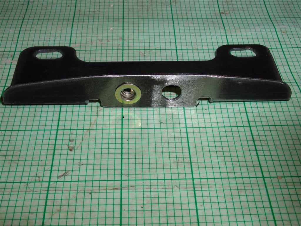

   / Not quite tractor, has anyone built a home made CNC table? #6
Here's a stainless heatshield I cut and bent two weeks ago. And a bracket to replace a plastic part, built this week.
